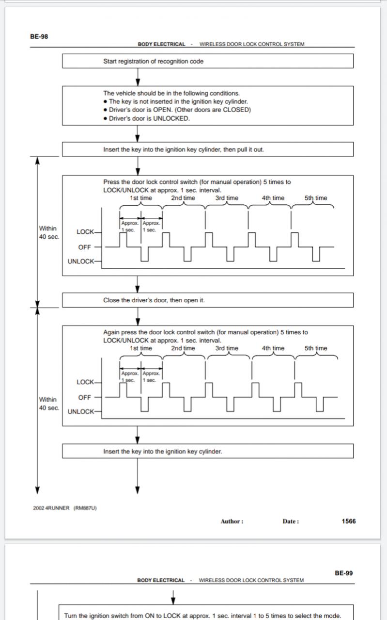

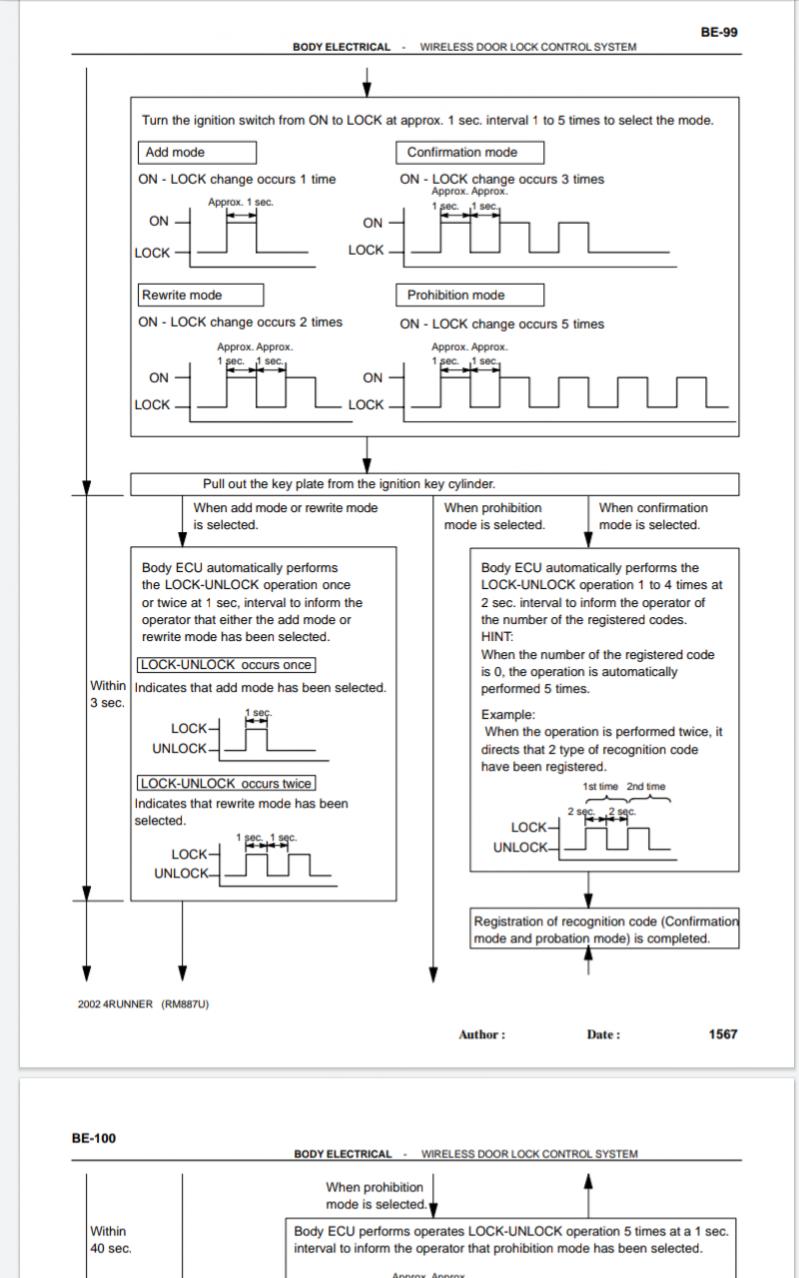

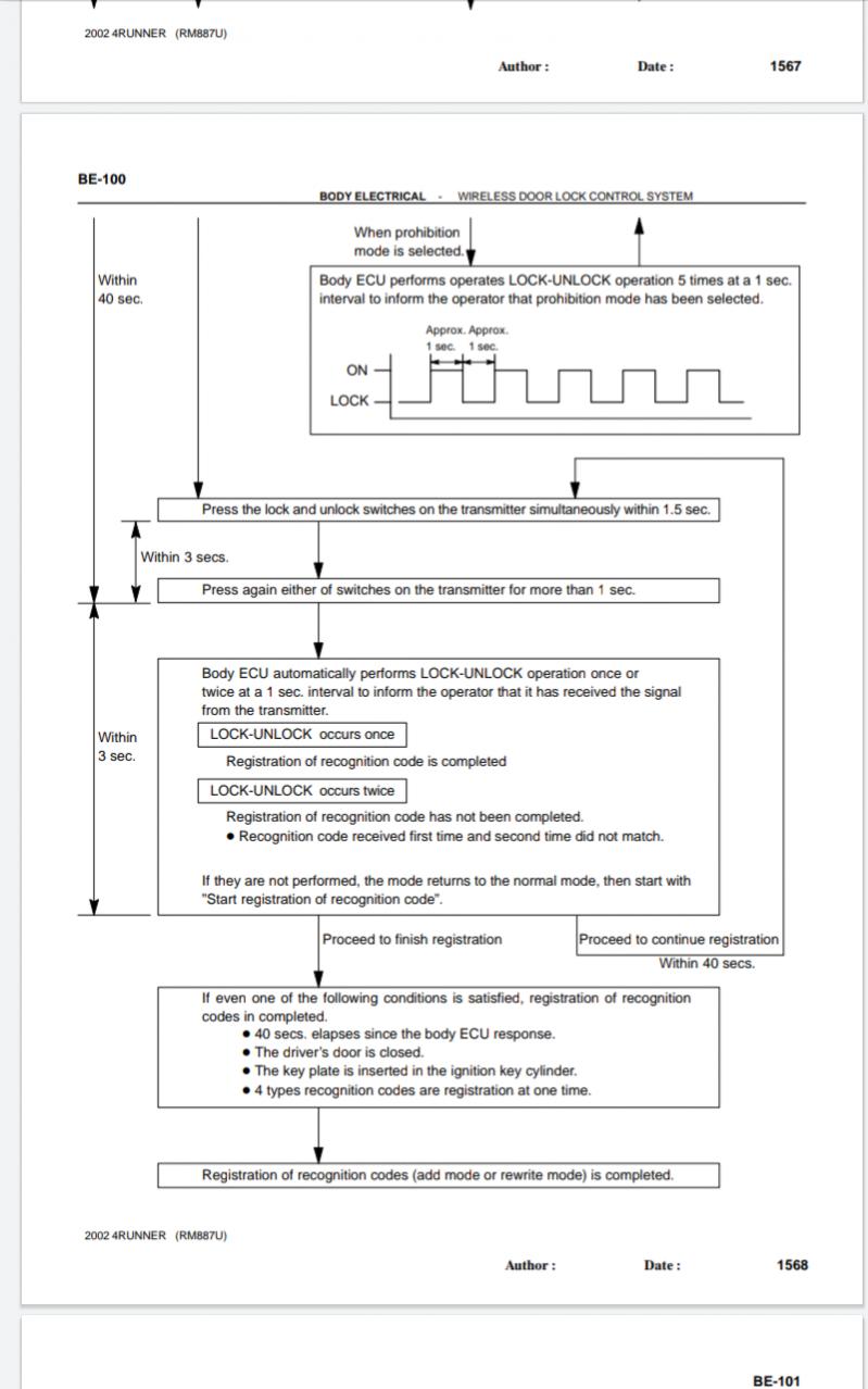

Attached are the pages of the fsm that I have used to program the key fobs. There are separate procedures for adding a key fob.

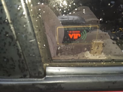

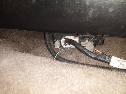

Do you have these stickers on your door windows. Do you have the RS3000 or RS3002 module under your drivers seat?
If the answer is no. I would call a local Toyota dealership and they can verify with your VIN. If you have keyless entry or not
3 of my 5 do not have this. So its quite possible you do not have it or you may.
Might be a good first step. As if you do not have the module. Those FOBS will never program.

Unless a dealership added a module to have an aftermarket remote door lock fobs then you don't have it. Mine had a "Karr" brand module which you see in the Southwest; mostly in Cali. I took it out because I couldn't get the auto door locks, which I hate, to stop working. I couldn't get a "Karr" fob to work so I removed it from under the kick panel under the steering wheel. Very easy to do. The auto door locks stopped working and I was a happy camper. I have to use a key all the time but that's okay. There are other effective anti-theft devices one can use when going to high risk areas.

Many vehicles have only one wiring harness. It has the wiring for all available options. If those options are not installed the plugs for them are still there.
I just wonder if the modules your pictures show (above) have a plug (wiring) in vehicles not endowed with remote lock/unlock?
If so, all I would need to do is to find a module...
