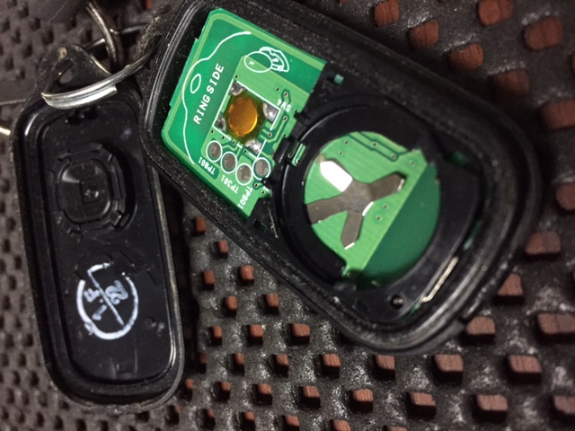

Also this is a bit of long shot but you can try bending up the 3 metal prongs (gently) that sit under the battery.
Pic attached. If they're flattened the battery won't make sufficient contact.
