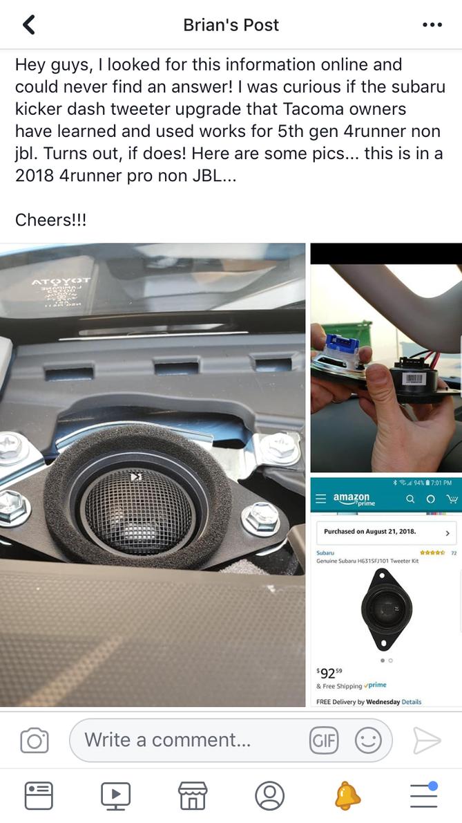

Anyone successfully do the Kicker tweeter upgrade for a 5th gen 4Runner? Someone on FB mentioned it was direct plug and play swap, had not heard of anyone doing it on a 4runner. Curious if so what your thoughts are on sound difference?

Hah! You beat me to it...
Here is what I installed:
Genuine Subaru H631SFJ101 Tweeter Kit https://www.amazon.com/dp/B00PV6F8I2/ref=cm_sw_r_cp_apa_EHoGBb082K03T
And here is a quick video:
https://youtu.be/HajT_QX9mbw
It sounds amazing by the way!
Cheers

Thanks for sharing! I added a Kicker Hideaway Sub and that tremendously helped the weak OEM audio and these look to improve it as well
Installing a 3.5" 2 way speaker in place of the tweeter fills in the frequency gap between the 6x9 in the door and the tweeter in the dash. More full and clean sound.
I pulled the trigger on these after comparing some specs and photos from Tacoma forum. These are a direct fit,plug and play. No cutting,wiring or modifying mounting points. Took less than 10 minutes to install. These really changed the sound quality. It is actually impressive how much base the 6x9 put out considering their poor quality.

The little 2.5" stock tweeter does very little for mids. There is a huge gap in frequency response between the door and dash from the factory. The stock 6x9 in the front door is decent, replacing the stock tweeter with a 2 way 3.5" speaker is a huge improvement.
These are in no way going to compete with swapping all the door speakers, adding and amp and subwoofer like OEM Audio plus, but for $95 and 10 minutes of time without splicing or modifications what I’ve read is that it does make a pretty big difference in clarity. I had OEM Audio plus in my previous 4runner and just ordered these kicker tweeters today with same day shipping so will see if this enough to satisfy my needs vs dropping $1800 for OEM Audio plus again.
