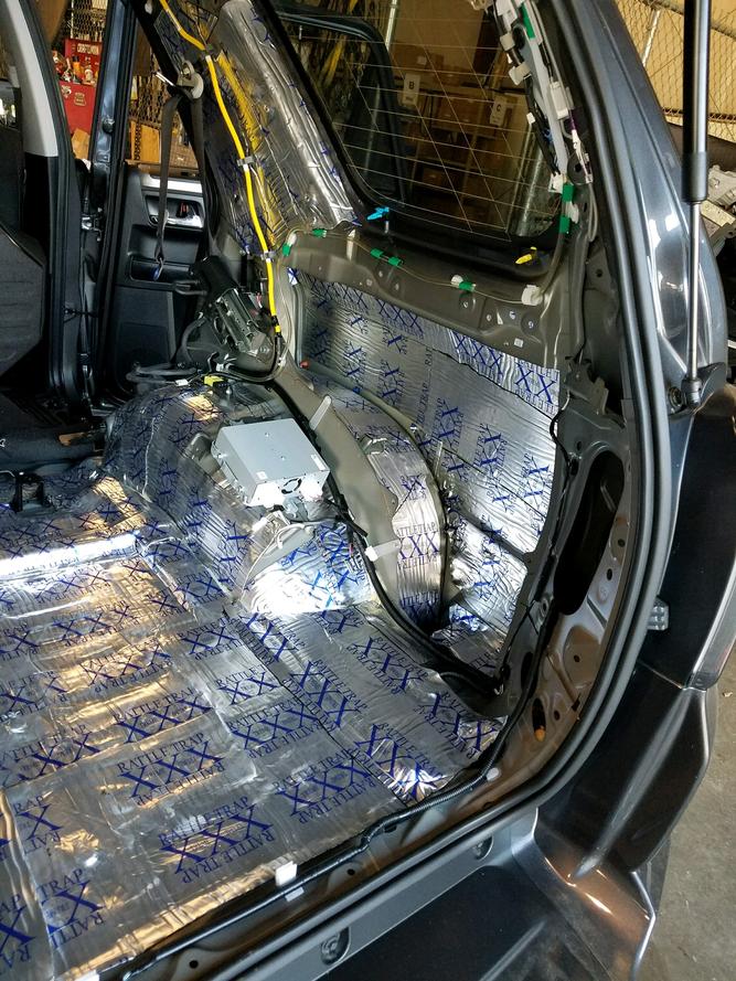

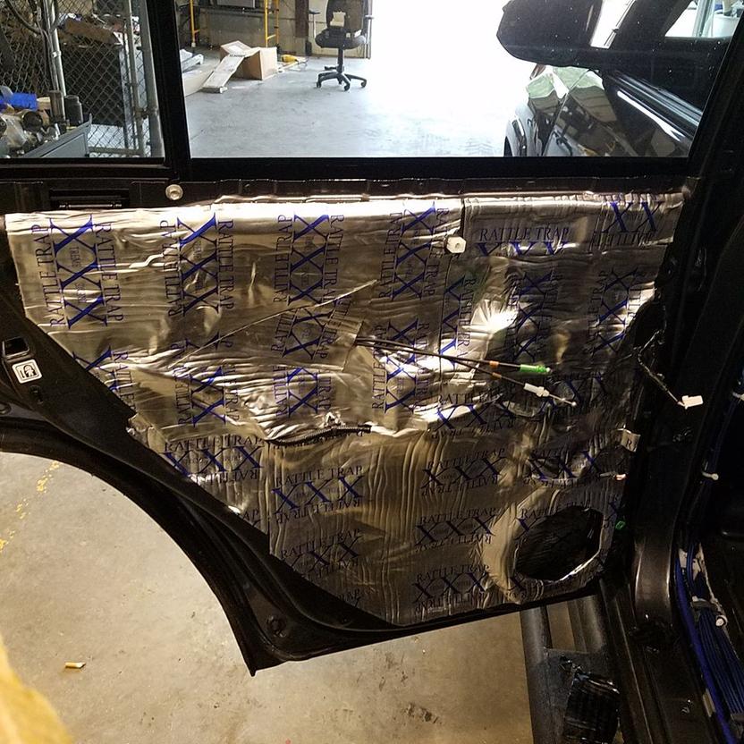

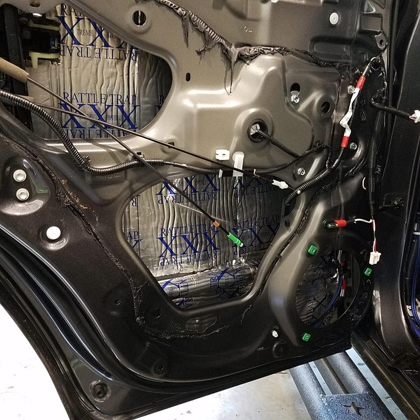

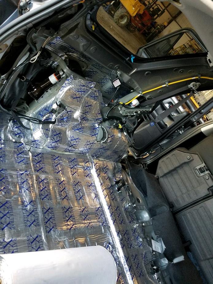

Also I may be headed down the rabbit hole. Starting to look at upgrading the door speakers and sound deadening. . .
Something like this?
Just installed mine and wow, serious improvement!
Should’ve been ten minutes but apparently Toyota had Hercules install my passenger side speaker.
