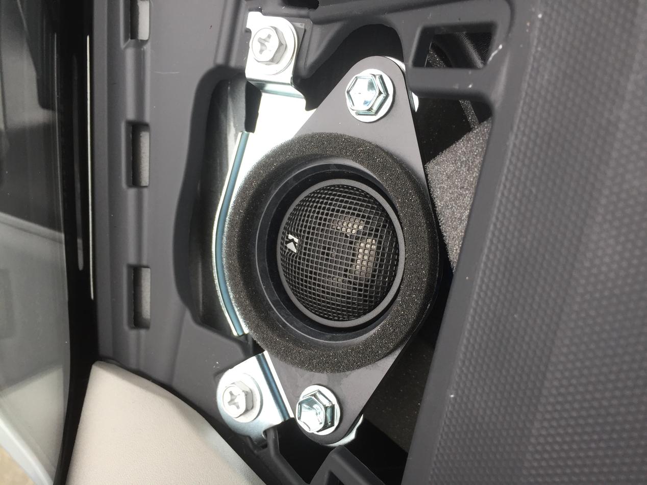

Just got them this morning and first impressions is it is for sure worth $92, got a $15 credit for amazon not delivering same day. The key is to mess with the EQ settings (treble/mids/bass) to get it returned to your liking. It’s almost like it reveals some of the songs flaws without proper tuning (but this was also something I constantly messed with when I had the OEM Audio plus system in my previous 4runner) it brings clarity to the vocals and music everything just sounds cleaner. Don’t expect a huge change to bass as you are not swapping door speakers, adding an amp or sub. Overall satisfied for the cost and will hold me over till I take the plunge and spend $2k on audio

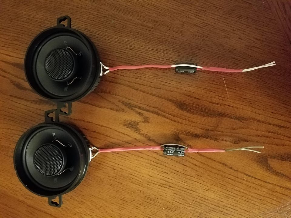

The tweeters fit with no modification. If you want to upgrade to a 3.5" midrange tweeter combo you'd have to do some trimming to the backside of the speaker grill.
got any links to write ups for 3.5" dash install?

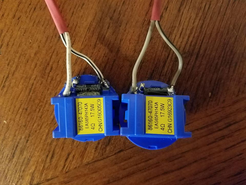

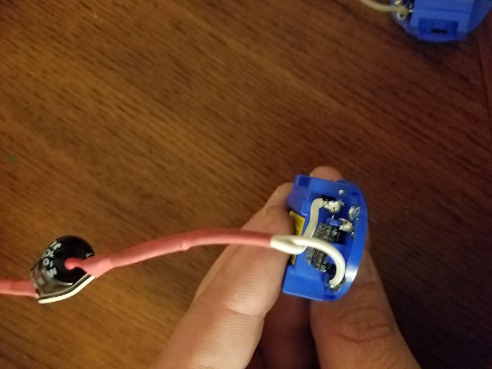

There are a bunch here. Pretty much drop in besides needing a small metal bracket which can be made from the OEM tweeter mount. I removed the plugs from the OEM tweeters and used them as adaptors for my new speakers so no cutting into the OEM harness.

My JBL speakers fit just fine, no depth issues. The plastic ring around the surround did have to be shaved since it stands up to high to put the OEM grill back in. Had I known that in advance, I would have went with the Infinity Reference 3.5" speaker which has no clearance issues. You have to cut the factory tweeter bracket, it's not bolt in. I personally just used a piece of car stereo back strap and made a small bracket to position the speaker where it needs to be.

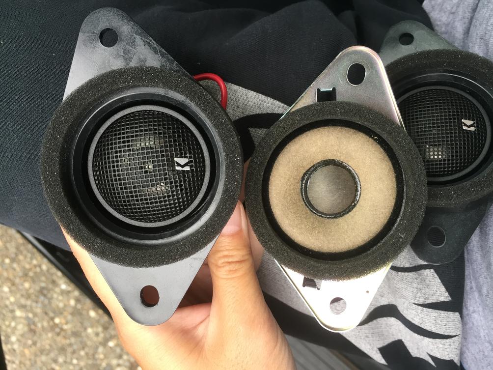

Agree on all fronts there, quick and easy sounded good to me so I made use of an Amazon gift card I had and just finished the install, literally 10 mins. I was surprised at the weight difference between the OEM and the Kickers - I suppose that there was little to no magnet on the OEM and certainly those cones were like paper. Anyway - I can attest after testing via XM, FM and CD that I'm hearing a fairly good improvement, Metallica / Pink Floyd, much crisper from the upper dash now I'm hearing some highs that didn't sound great before. I have the balancing turned off on the deck (the high / mid / low setting) and just adjust each source individually.
