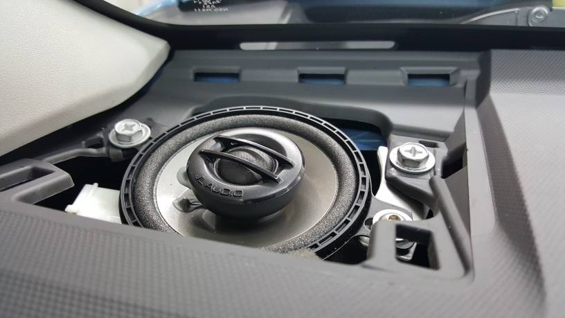

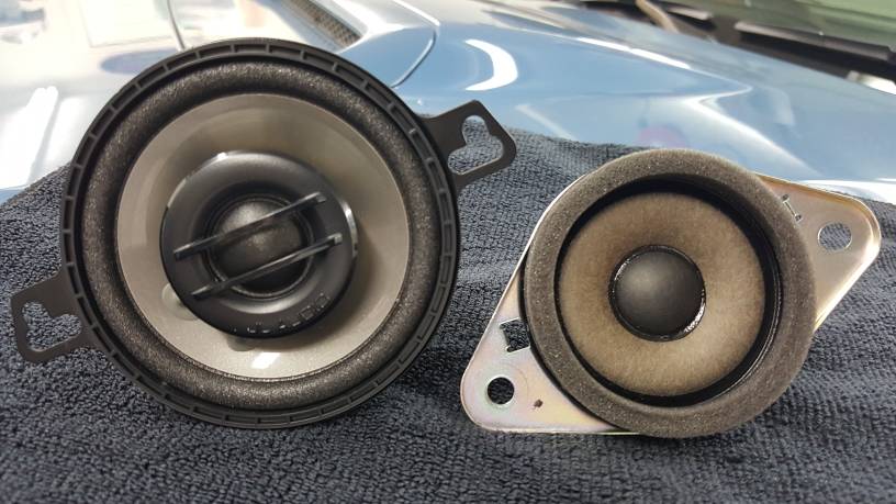

I had the Kicker CST20's in my dash (same speaker that comes in the Subaru tweeter upgrade kit with a polymer adapter plate) and recently replaced them with Kicker KS-series 3.5" coax speakers. I'm so much happier with the 3.5" speakers up there... a nice bargain at $50. Same highs as the tweeters alone, but more mids so my entire soundstage moved to the windshield. Sounds absolutely amazing. I had to do my own wiring with a couple of solder/crimp connectors but the whole install only took about 30 minutes.

I took some queues from this thread and others, then installed a pair of JL Audio 3.5" C2-350x coaxial speakers in my dash. It took a little time, but it was easy, and well worth it. I can't believe the difference!

That's what I did today. Followed this though... DIY; I was convinced I was gonna have to buy a harness after all but to my surprise this solution worked and the speakers sound great compared to stock. It was a tight fit on the passenger side.
I did this mod a few weeks ago and it makes no change to the bass. It gives you a little more clarity in the high end.
However, since I got the truck I quickly adjusted the equalizer to -3 notches on the bass, and +2 on the treble. After these Kickers were installed I dropped the treble to +1 because they seemed clearer and were sometimes a little too pronounced.
The stock sound was much improved after the equalizer tweaks I think and slightly better with the kicker speakers increase.
That said, if I had had to do it again I probably would’ve just ordered the Focal Toyota front and dash speaker combo that is also plug and play (and also $250-280 I think) since replacing the door speaker will likely give better mids as well. I feel this Kicker upgrade improved mostly the highs like cymbals, etc, and maybe the mids only a very little bit.
