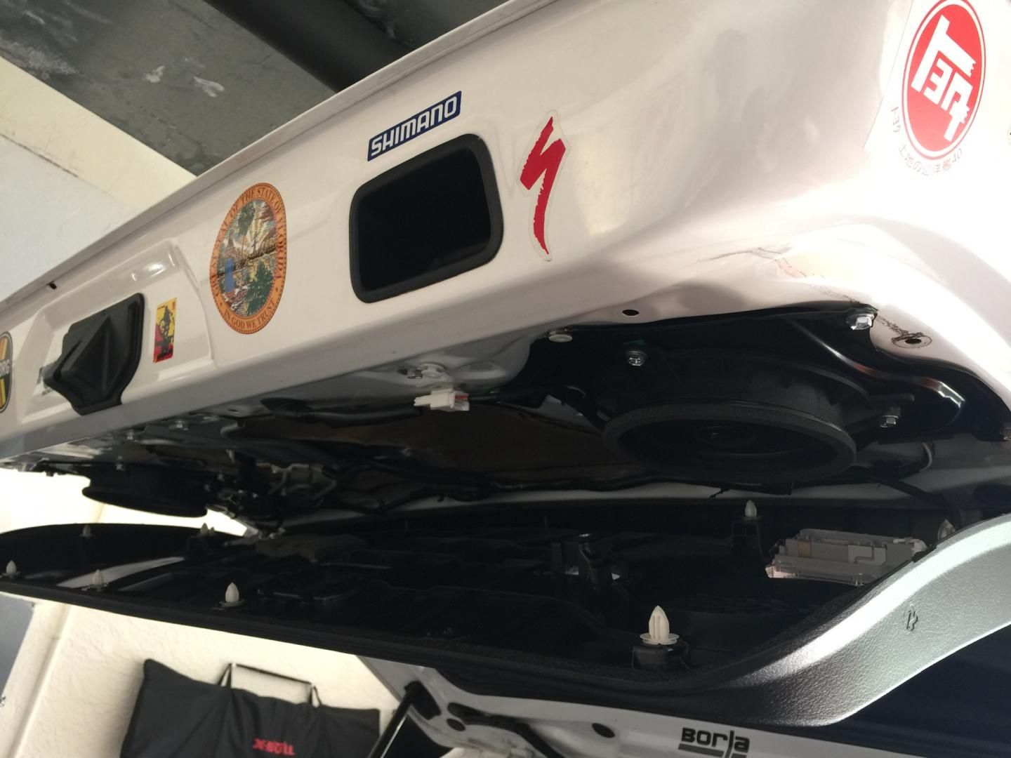

So I’m thinking about pulling the trigger on these. I like plug and play upgrades. How are these things holding up out there? I have my fader more to the back, just personal preference. Has anyone found a good plug and play upgrade for the hatch speakers?
Disclaimer; I am not an audio guy.
I would definitely recommend these. Clear vocals in 10 min.
@CMATZ I installed the power base as well so now I’m jamming. Thanks for the recommendation. Only thing is if I turn it up they vibrate the hatch!
