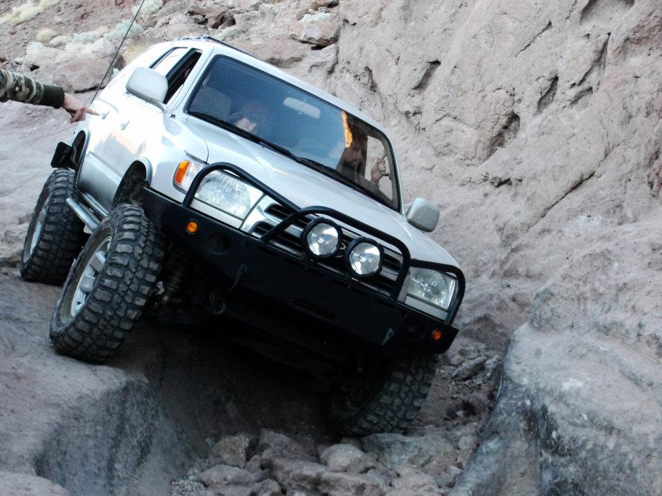

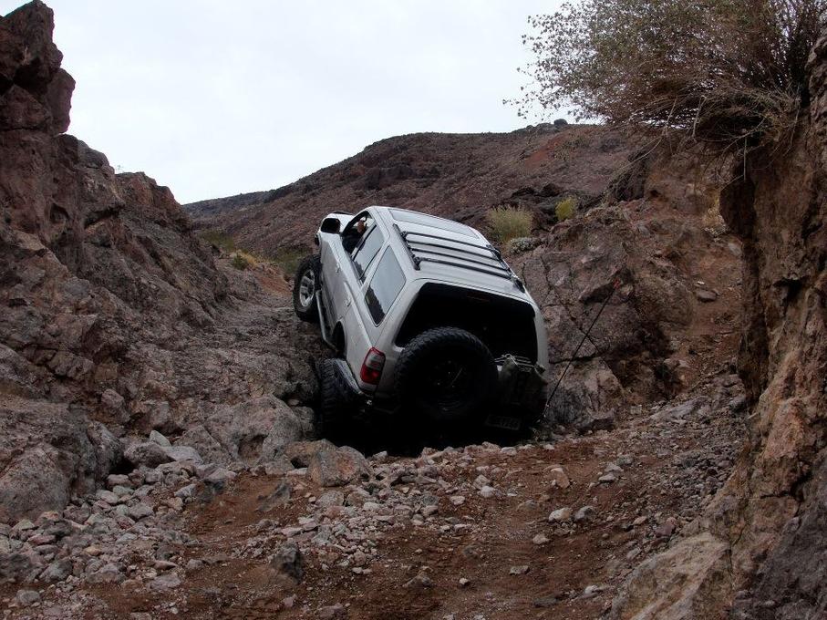

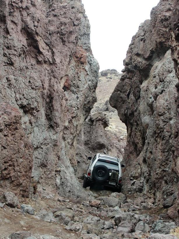

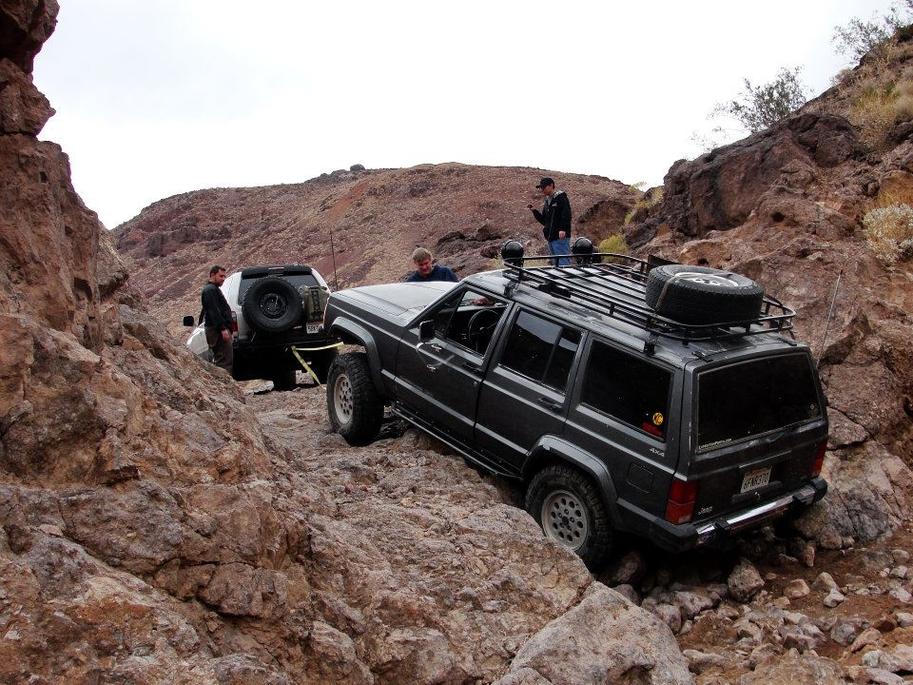

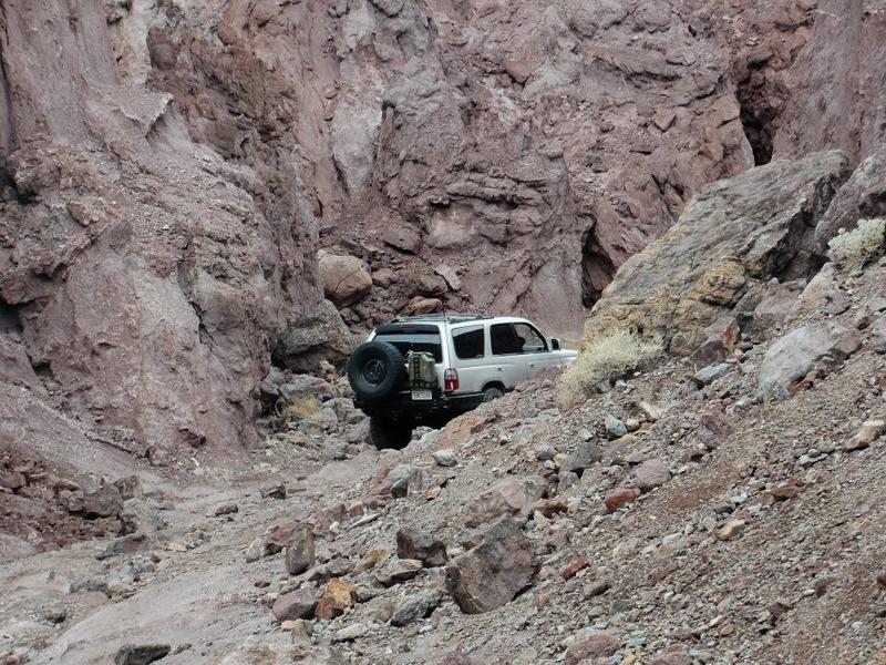

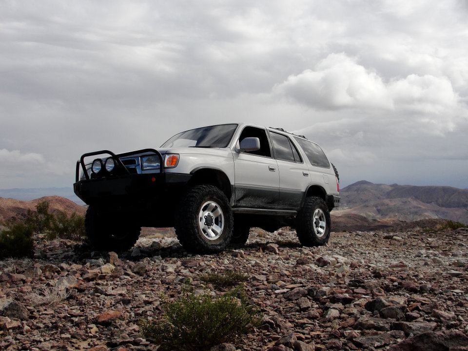

Thanks for the compliments so far guys. Here's some photos from my recent Calico trip. Most of the pics are from going up and down Duran. Even got a pic of me pulling my buddies Cherokee :bravo:

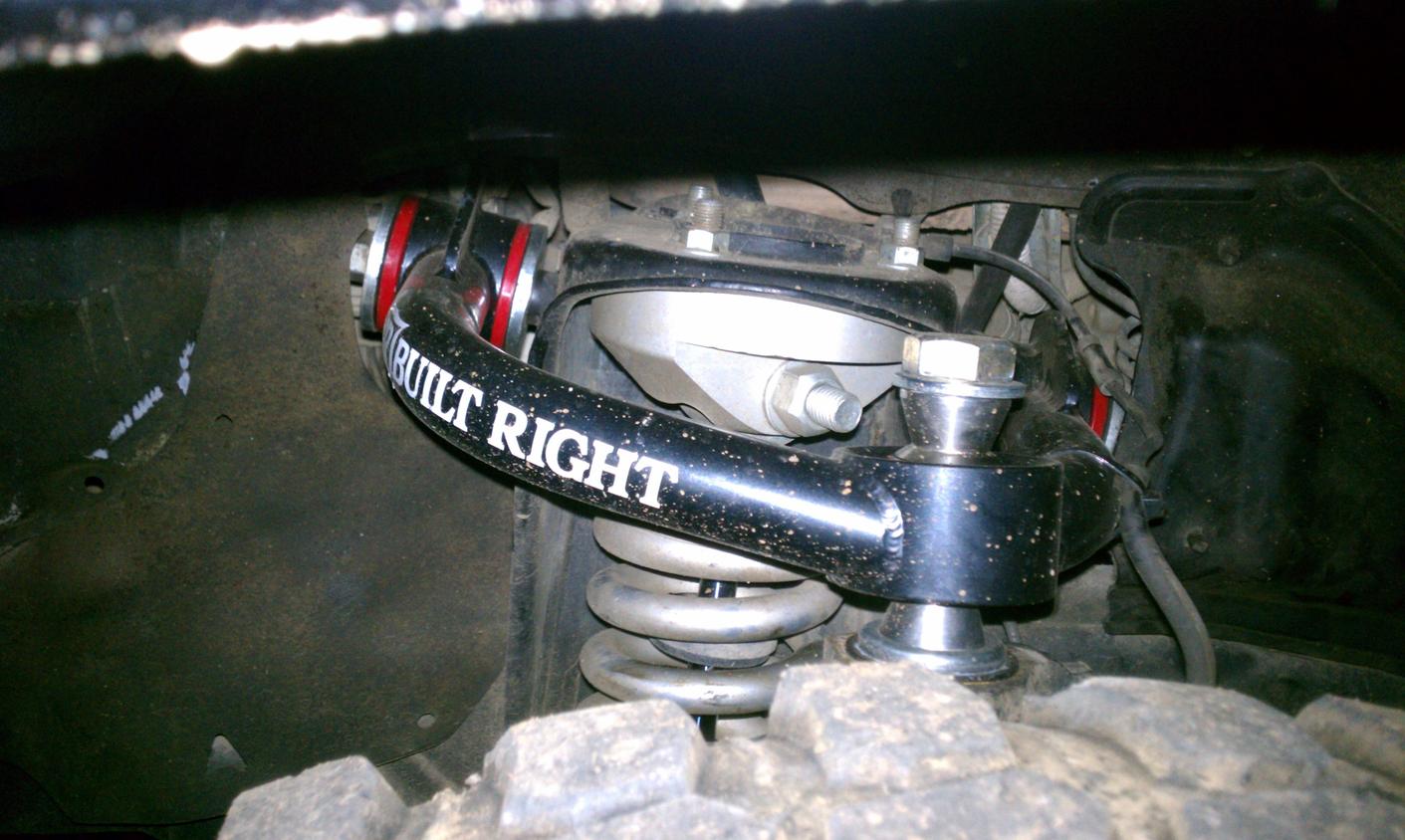

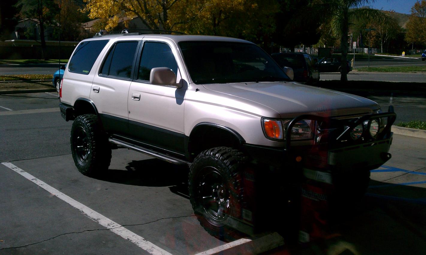

Update! Got my BuiltRight Upper control arms in. Alignment seems good now with the 3in. lift. Do you absolutly need them for a lifted vehicle, probably not. At least I won't have ripped upper balljoints now. Pimp factor check! Polyurethane bushing sqeak check!

I'm surprised I've never seen you around since your down the street from me. Control arms I would say are a must do around that lift height... At least if you want an upper ball joint that isn't limiting your movement.

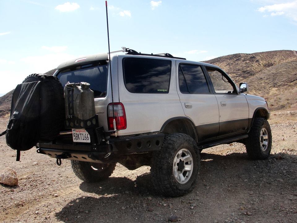

Freshly washed, painted satin black wheels, 1.5in wheel spacers w/ custom rock rash from John Bull. :cowboy: (dont mind the window glare) Also a pic of our group after John Bull.

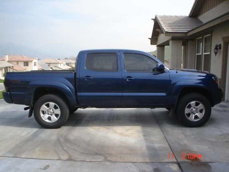

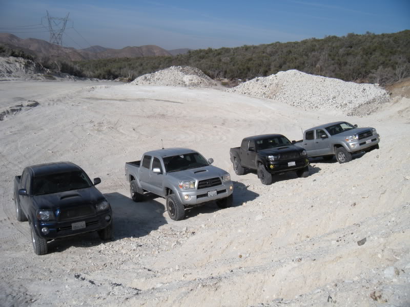

Here's some pics that I scrounged up. My truck is on the far left.
