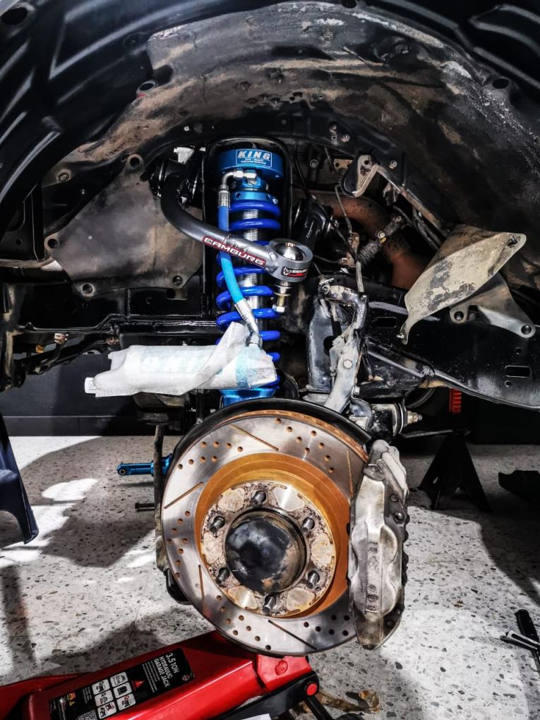

Hey everyone,
I searched all over the place and didn't find much in the way of a "review" or a "first impressions" for this kind of setup so here it goes.
Came from a Bilstein 5100 setup with OMEs up front and Toytec Superlifts in the back. I also have the firestone airbags in the rears which I have barely used. Decided to upgrade as 2 of the Bilsteins were basically shot and ride was all over the place. Rig only has a steel roof rack to add weight, front and rear bumpers are still stock I don't have a winch. Running 265/70R17 KO2s E rated tires (couldn't find any other rating).
Installed a King 2.5 setup with remote reservoirs all around. Due to crazy lead times, I was only able to get the adjusters for the front coilovers. Went with the standard 600 lb King coils and kept the Toytec for the rears with the airbags. This was paired with the Camburg UCAs.
Rig sits a little higher all around. Alignment went well. Initial impressions are a bit of a mixed bag. Car feels much more controlled, especially at speed and on dirt roads. Soaks up bigger bumps and holes with very little effort while never bouncing in an uncontrolled manner. It clearly feels much better than the shot 5100s, but the true COMFORT factor isn't exactly what I was expecting. Small bumps on the road are still felt and the ride is still "harsh" or "aggressive" with imperfections on the road. It doesn't feel "cloud like" or "fluent"... the imperfections are soaked up partially, but what is felt is still fast...
I'm not sure what to think, I had never been on a rig with this kind of setup and bit the bullet on a whim on black Friday thinking this would be insanely comfortable... Any words of wisdom? Any adjustments that you feel may be necessary to make the ride cloud like?
These impressions are all with the front adjusters turned down all the way to soft. Some added weight of the old suspension in the trunk and just me in the car. Is this just a weight issue? Anyone knowledgeable care to point me in the right direction?
Ill keep updating this post as I felt a bit in the dark when buying this because I didn't find any posts specific to this setup.

Congrats on buying a quality setup. I have not had Kings but the question is not specific to them.
You can have the setup better suited to offroading, better suited to road driving, or you need high-level adjustability, which King does not offer, to get a piece of both. King's mid-level adjustment is for fine tuning.
You can adjust the valving or the springs (supposed to be used for weight adjustments rather than performance).
The Kings will do great offroad so revalving them would essentially downgrade them to where there is no point in having them vs just a 6112 on standard spring (550sh, shops claim 600 but is not) with 5100 rear (a road-optimized setup).
That said, an easy way to improve the ride quality on road is by switching to 550lb front springs. Some King retailers offer free spring replacements. That should make a difference while still preventing bottoming out offroad. It will reduce somewhat the offroad speeds at which you can go through sharp terrain changes.
Btw, I thought King standard springs are 550, are you sure you have 600? If you already have 550, there is nothing you can do without de-rating the set's offroad capability altogether.
Also, possibly the Camburg UCA is not helping the ride quality but at least you seem to have poly bushings instead of heim joints.
Of course, any down-grading of offroad abilities would question the use of Camburg UCA since that style is meant for high off-pavement speeds.

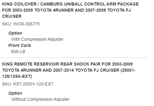

Thanks for the reply, definitely going to check on the actual springs to see if I have the 600 or 550... even though the invoice stated 600.
Why do you state the Camburg UCAs are not helping the ride quality? I went with the bolt on package that was offered by wheelers off road without much research TBH.

In your case, check on the spring rate.
As for tires, heavier tires soften up the suspension so if you are running P metric, lighter tires, chances are that going to heavier, LT tires will make the ride feel smoother. There was a Tire Rack test on the subject and my experience has been the same.
The springs should say 600 in the code printed in white lettering on one of the coils. FYI, I have 600lb springs w a bumper winch combo at 250lbs + dual batteries and an ARB compressor up front on my 5th gen. So it's a lot heavier than yours up front. 550 lb springs and a tire change w lower pressure might be a good place to start.

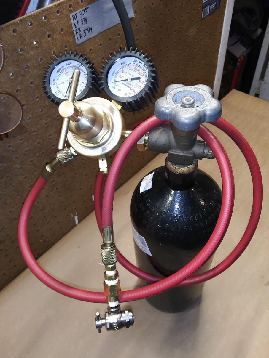

I think you need to grease the bushings on your Camburgs. If they have zerk fittings it's a definite. This video by Total Chaos shows how it's done properly. This method should work for your Camburgs. I bought Super Lube in a grease gun tube and it lasts quite awhile.
As far as nitrogen, I'm pretty sure they ship with out being up to the proper pressure. 150 psi is what I have mine set at. It's very hard to check the pressure with just a regular gauge. There is very little volume so just putting a standard gauge on there releases a lot of pressure. You need what they call a "no loss" chuck and a high pressure regulator to do it properly. I have this rig I set up for doing it at home.

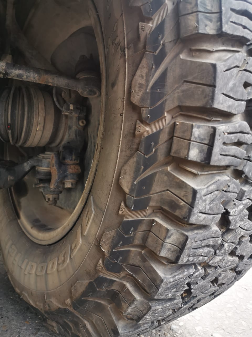

Getting the rig checked out right now, I have some rubbing issues on the inside of the wheel, going to get camber checked out tomorrow.See pic: *BFG KO2s in 265/70R17.
Also, looking into ways to prolong the life of the UCAs, definitely feel like buying the Camburg Uniballs was not the ideal. Should have done a bit more research. :frusty: I filled them up with thick grease but with some use, it evidently becomes uncovered... looking into a way to change them to balljoints or get them covered somehow. Any suggestions are welcome!
Can you take another photo of higher up near the UCA? It definitely looks like it’s running on something
