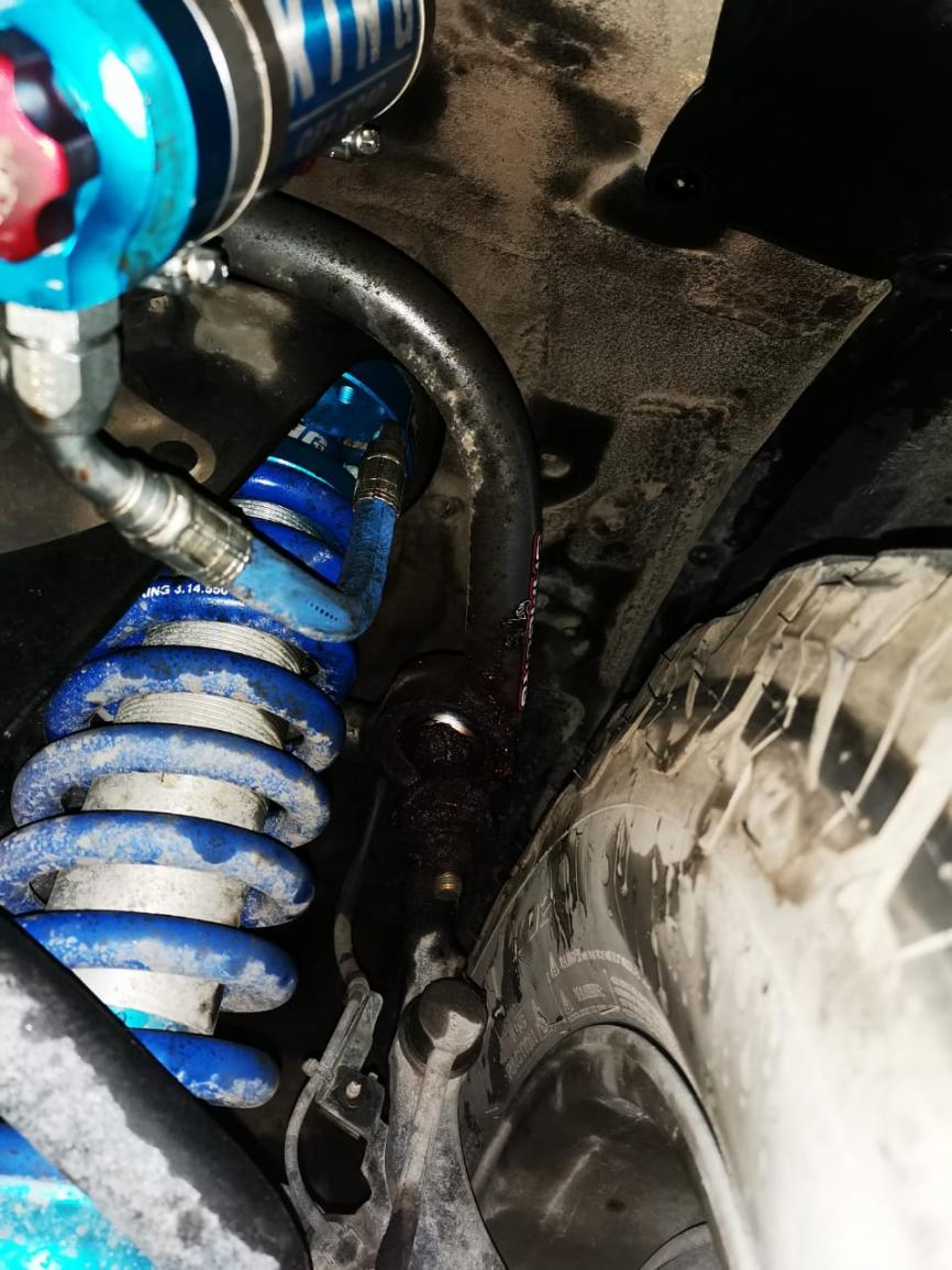

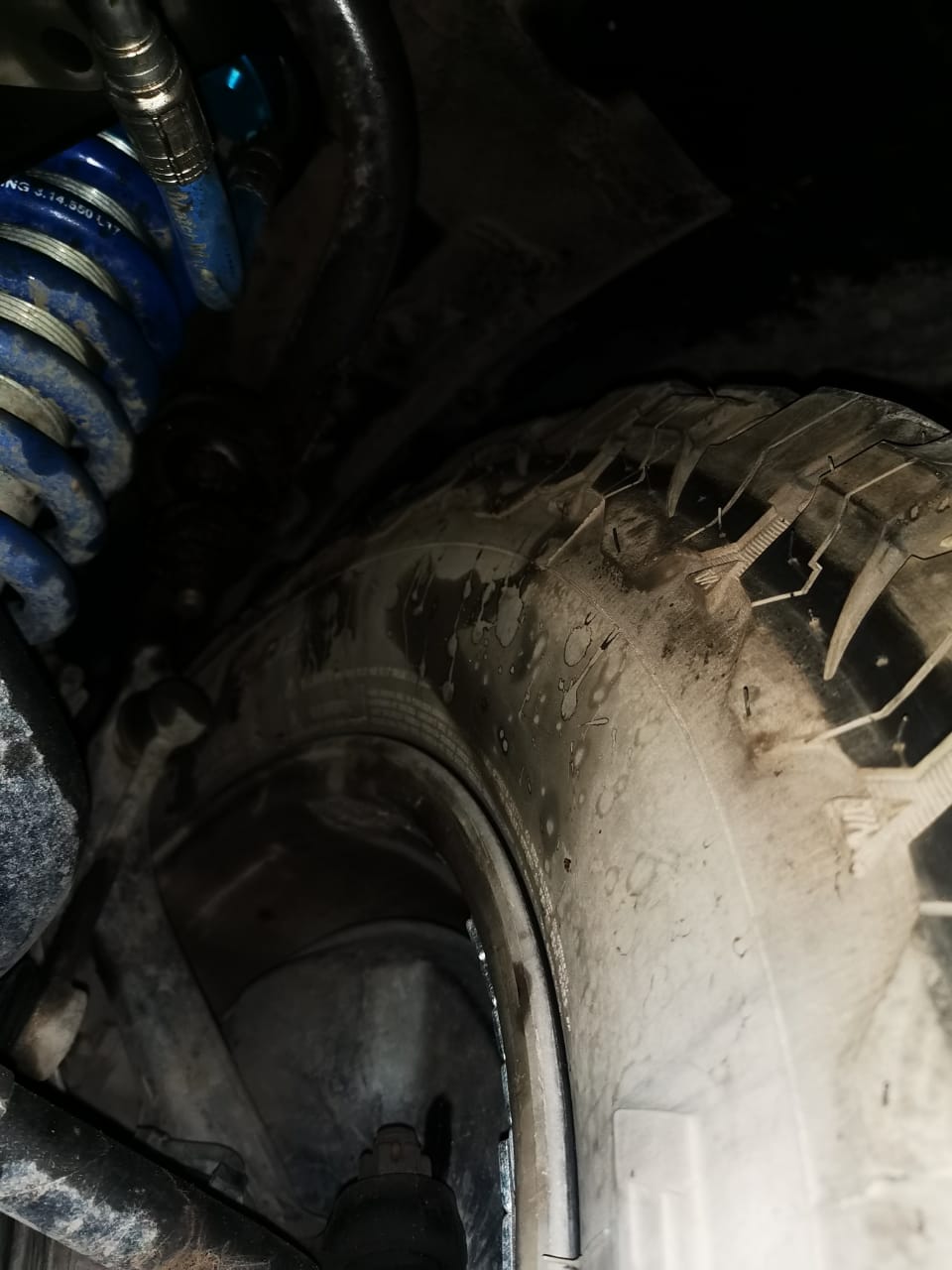

Shop just sent me a couple pics. Not the best but here they go!
Anyone have any tips as to how to save the ubiballs on the UCAs? Can I swap them out for any other sort of system without having to exchange everything?

I recommend spidertrax spacers or new set of wheels with different offset.

The rub mark seems to line up with the UCA. Don’t they sell dust covers for the top of the UCA for the Camburgs?
Apparently it does line up with the UCA, so Im looking into spacers... I'm wondering why with the stock UCAs and the same tires I didnt get that effect. Does everyone have to run spacers with aftermarket UCAs?
They don't sell the dust covers for the uniball Camburgs, I've read quite a bit and it seems like its not even a good idea if they did sell them.
Yeah, same thing happened to me. Either spacers with stock wheels or new wheels with different offset.
You can be like me and do both. haha :der:
You can buy a set of spidertrax spacers if you can’t do wheels right away. Keep an eye on the classifieds here and at tacomaworld for a used set.
For the uniball as long as you keep them greased should be fine. I think the recommendation on these is triflow every oil change or so, or when they start squeaking.
This stuff: Tri-Flow TF0021060 Superior Lubricant Drip Bottle- 6 oz Amazon.com: Tri-Flow TF0021060 Superior Lubricant Drip Bottle- 6 oz: Sports & Outdoors

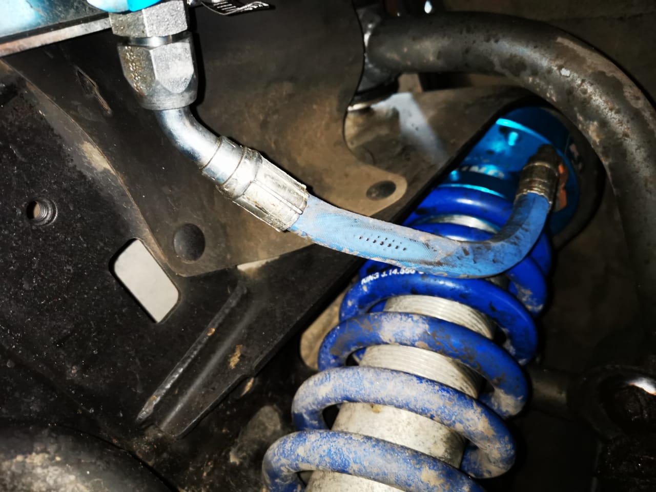

Also, I think I figured out what was rubbing in the previous pic. Unfortunately it was the tube that connects the ext reservoir to the shock. There is some wear and clearly I want to work on replacing that. See pic below:
Any suggestions as to how to proceed on replacing that?
With that pic, I think I realized the front springs are 550... you can sort of tell on the pic, right? Also, does anyone have any experience in adding the adjusters to the remote reservoirs on these king shocks? I bought the rears with no adjustments as the lead time was crazy and these were in stock.
