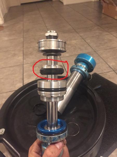

I have King 2.5 Coilovers (Remote Res.) non extended. Part # 25001-278.
When I originally purchased them I did not have aftermarket UCA's so I purchased the non extended version. I have since added JBA UCA'S. I'm going to rebuild them shortly. Is there something I can do like swap or remove a spacer to make these the "extended" version?
Do the extended and non extender versions share the same shaft and it's just a spacer or something making the difference or are the different shafts all together?

Actually the oem performance series looks a little different inside
The 1/4 silver spacer comes out. The rubber bump stays in
Wfo9 is bang on. I've got a set with the spacer removed, and one with it in tact. I only removed mine because I ruined the shafts and had to replace them.
I really can't notice a difference between the two, and I run 2" icon springs in the rear

It's my own fault. Too much adjusting while on truck. Hit hose, lost a lot of oil, created nitrogen leak...There's a local guy here that rebuilds out of his garage for fairly cheap so I'm looking at getting it done next week. I figure since he's rebuilding I might as well make them extended.
