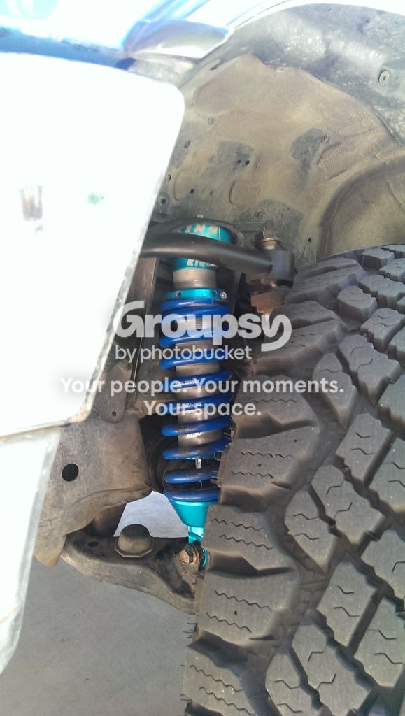

1. I have Kings (part number and shock below what mojavemadman talks about) and i love them. They are direct replacement coil overs with adjustable collar to change preload and lift. ive got mine set up for 3" lift in the front and love the ride. taking speed bumps, gravel roads, dips in the road are fricking fun!!!!! the suspension is so smooth and plush all the way through the travel.

I have there and they are great. check out my build thread around page 2 or 3 i install (bought them used) them and the last page (today ) i repainted them to clean them up. let me know if you want more pictures of this type of shock.
