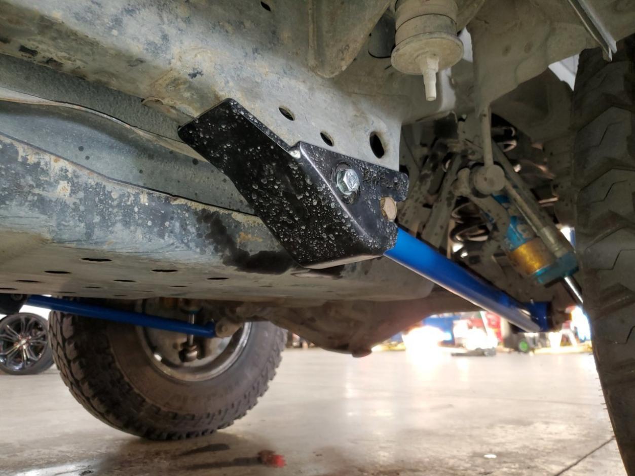

Plenty of wheeling done with mine with no issue; picture was taken cause I had bent an arm so I replaced both.

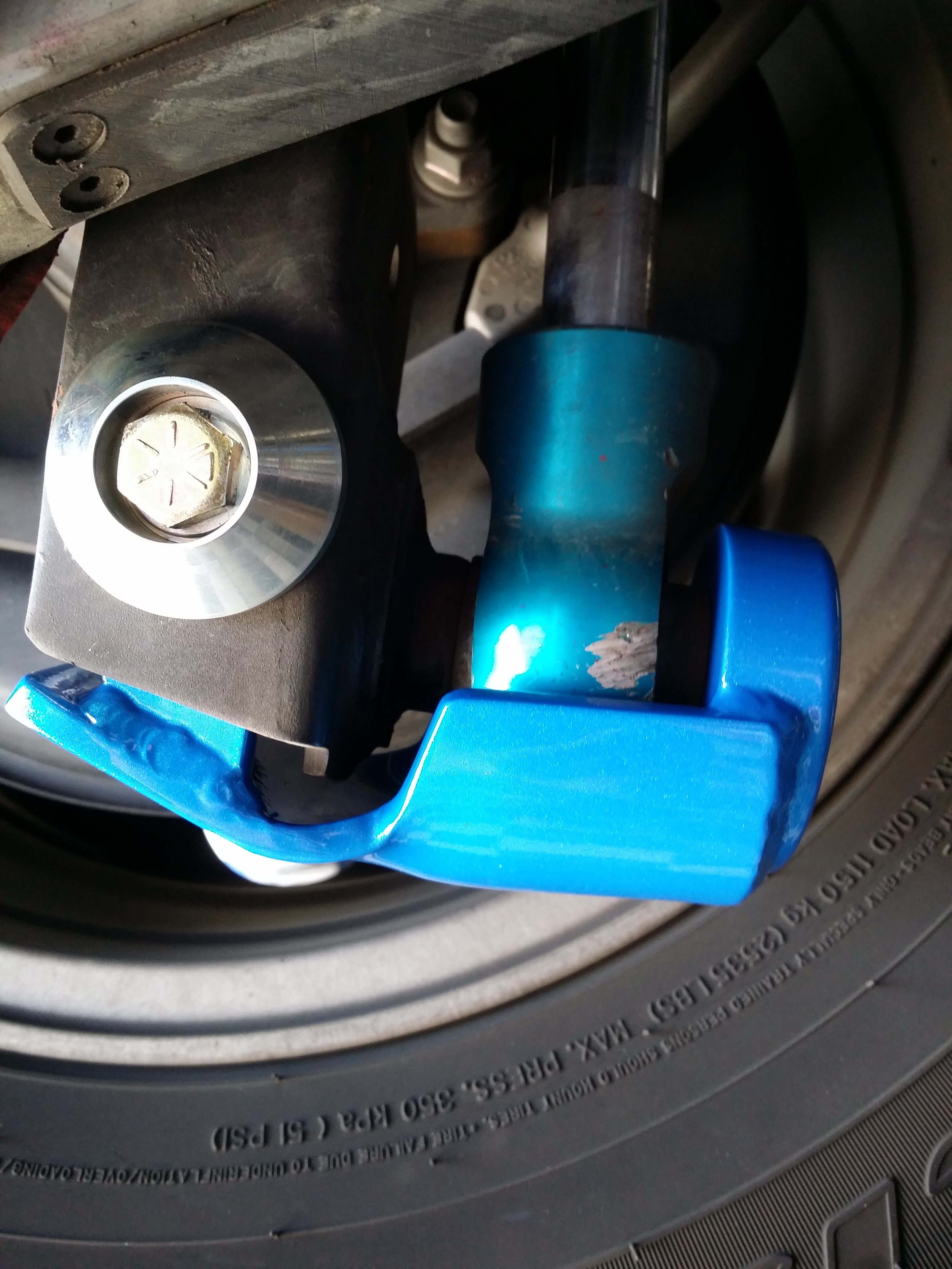

It's an old thread but maybe these will work for you.
Thread: Rear Shock Mount Skids
Product Link: 56100 - ICON Stainless Steel Lower Shock Shin Guard
I saw those recently. I'll have to email Toytec and see if they have any insight on it. Would really suck to drop 120 bucks for something that doesn't fit...
Mainly I worry about it not clearing the actual shock body which would definitely not be good during compression haha
Whoops, for some reason I typed icon, corrected to Toytec
Doesn’t look like it will fit 3rd Gen. missed the beginning of this post looking for a 3rd Gen solution. My bad.
