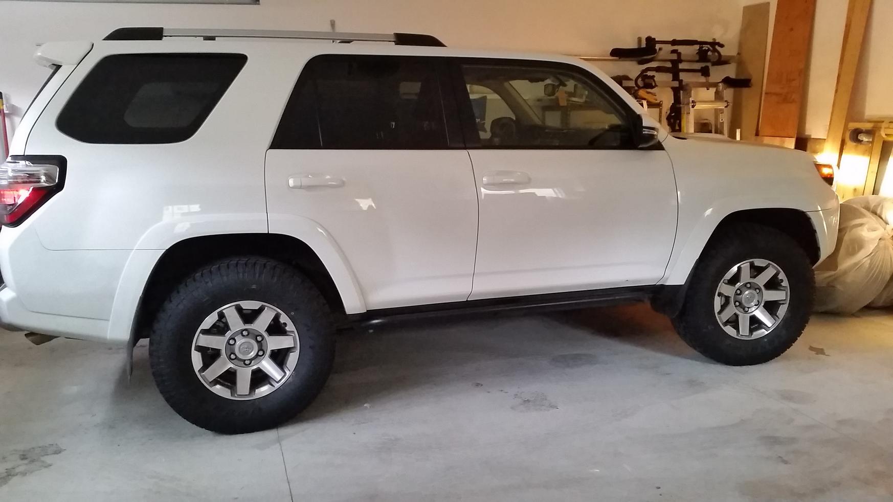

No need for a lift with 285s. May help with some things but you won't gain any additional clearance for bigger tires. Here's 285s with no lift. the rear would easily clear 35's. The front not so much.
Once you start off-roading and flexing the suspension, you will definitely start rubbing.
Unless you are changing the bump stops or changing geometry with control arms, springs and shocks make no difference as far as clearance goes.

A lift that retains the same a arm mounts and a arms only changes the static height. The travel and tire placement is the same. To simplify this imagine a simple lever with a pivot point on one end. The arc of the lever will remain unchanged regardless of where you start moving it from. Unless you change the pivot point or the lever it won't change the tire clearance. There are some advantages to having a taller static ride I such as more body clearance. When you're lifting solid axles of course it's different because a solid axle pivots about a virtual pivot point that is changed when you lift it. You also have varying amounts of other characteristics like anti squat that will change depending on the position relative to the links in the rear axle. But in this case the rear has more than enough clearance for larger tires at stock height and the front is limited by the clearance around the front body mount.
