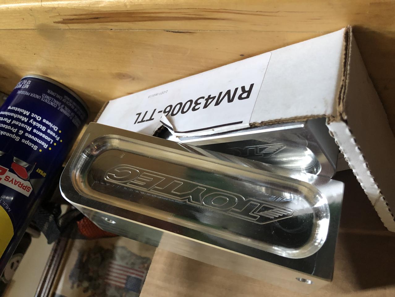

I spoke with Ben from Filthy Motorsports after placing my order for Kings, also with extended rear (with Toytec Superflex 2” rear springs). He recommended the Toytec 2” bump stop spacer, I took his word for it. I don’t think you really need or want noisy hydraulic bumps stops, but they do look cool haha. My suspension is going on today, good luck with yours!
