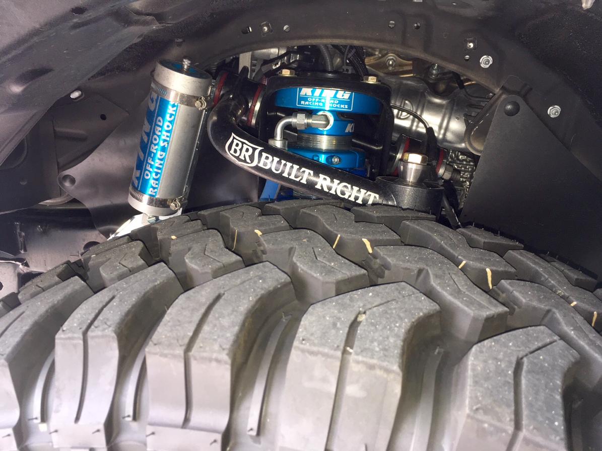

I have never heard anyone complain that their Kings are to stiff, or that they hate the ride, but that does not mean that one of those boneheads are out there, with all due respect. I love mine on and off road, but hey different strokes right?
