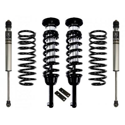

What I really want is max 1" lift coilovers, reservoirs are fine and add a cool factor, would like to avoid changing the UCA is possible. If that is Icon, Fox, or King doesn't really matter. Not really interested in Bilstein.
Dobinsons
They have different springs and struts based on the weight you have and the height you want. Very affordable. Few people here have them on theirs and ride is smooth both on road and on trails.
This is the suspension I will be going to. Right not I am on TRD bilstiens 4100s with much added weight.
For the most part, you can adjust any coilover to 1" lift. Most coilovers offer 0" to 3" or more of lift, and you can adjust your lift anywhere in between that. All 3 you have listed (Icon, Fox, and King) are great choices. To be an Icon or a King you definitely have to pay, but I run Icons and I love em. That was just my choice, but there are tons of coilover options for a 1" lift.
