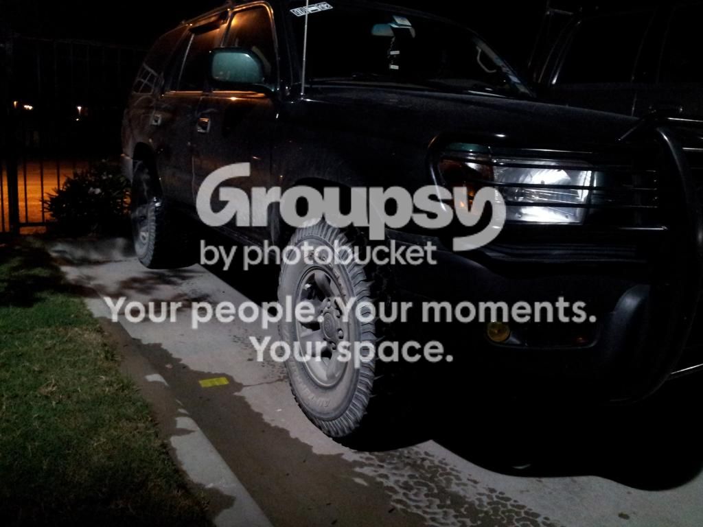

Bought some cheapo amber led light bar covers to produce an amber/yellow light for the rain. It helped a bit when I was driving on the dirt roads. But I cant wait till I get a 41.5" light bar for the windsheild :D

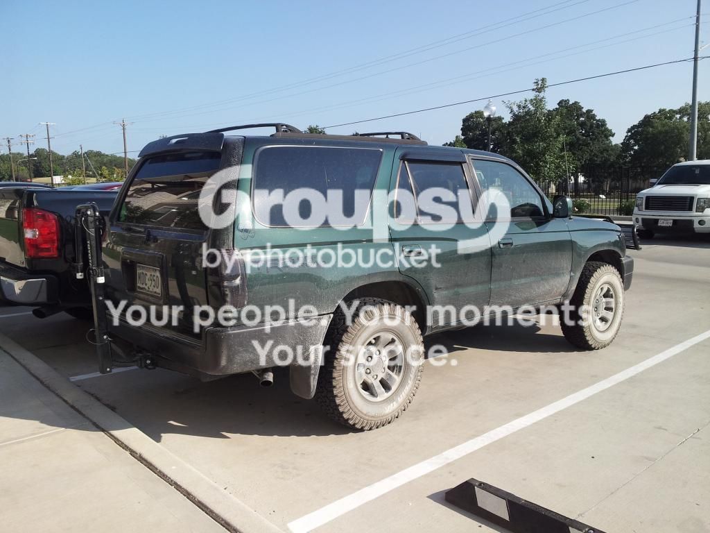

I also went driving with my friends on these backroads in College Station. Wasn't really much like prerunning lol but I was going like 60 on some of these dirt roads haha. After these experiences I have definitely realized that I need a suspension lift and new shocks...
Aftermath pic

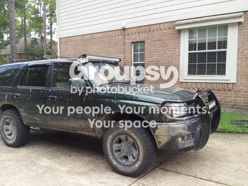

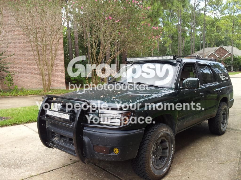

41.5" LED Light bar installed :D
So I bought a light bar for my winshield/roof off of amazon, 41.5" for $114. Not to shabby. Its freaking bright!!! I also bought mounts from Slag Factory which I believe Downpour is affiliated with and they are great. Here are the pics.

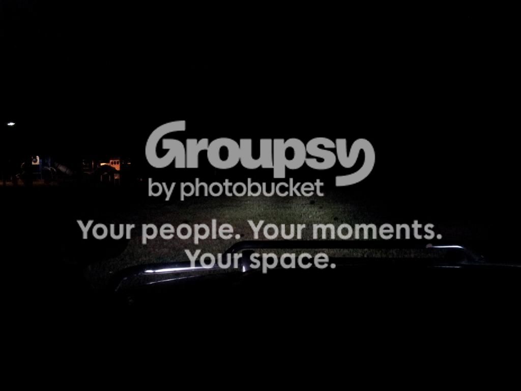

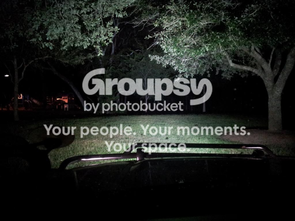

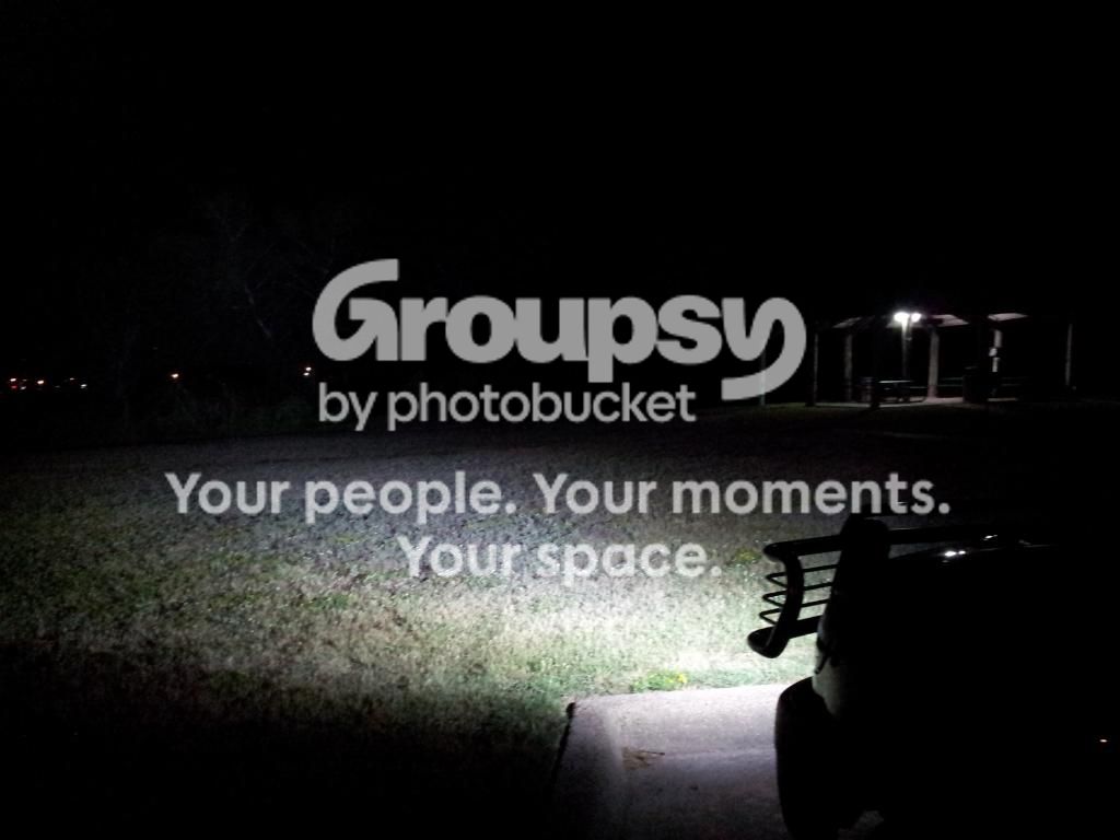

And here are some output pics, first is headlights only, 2nd is my front light bar and headlights, then the last one is everything.
I love this thing!
also sneak peak of next project :D
Can you send me a link to the light bar that you got? Did it come with all the wiring and switches needed? Hows the glare on it?
Looks really good and have been considering getting one lately.
Here is the one I got. You gotta watch the prices because the lowest I've seen it is $113.99 and then the highest $140. So watch it and pull the trigger when its low lol. And no it didn't come with any wiring or switches, but I bought some generic wiring kit with a relay off ebay. As for a switch you can buy a 3 prong fog light switch for toyotas off ebay. And the glare isn't too bad I think, but my 4runner is pretty dirty and I have a dark color so it might not glare as much on mine as it would on a lighter color.

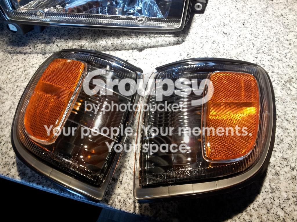

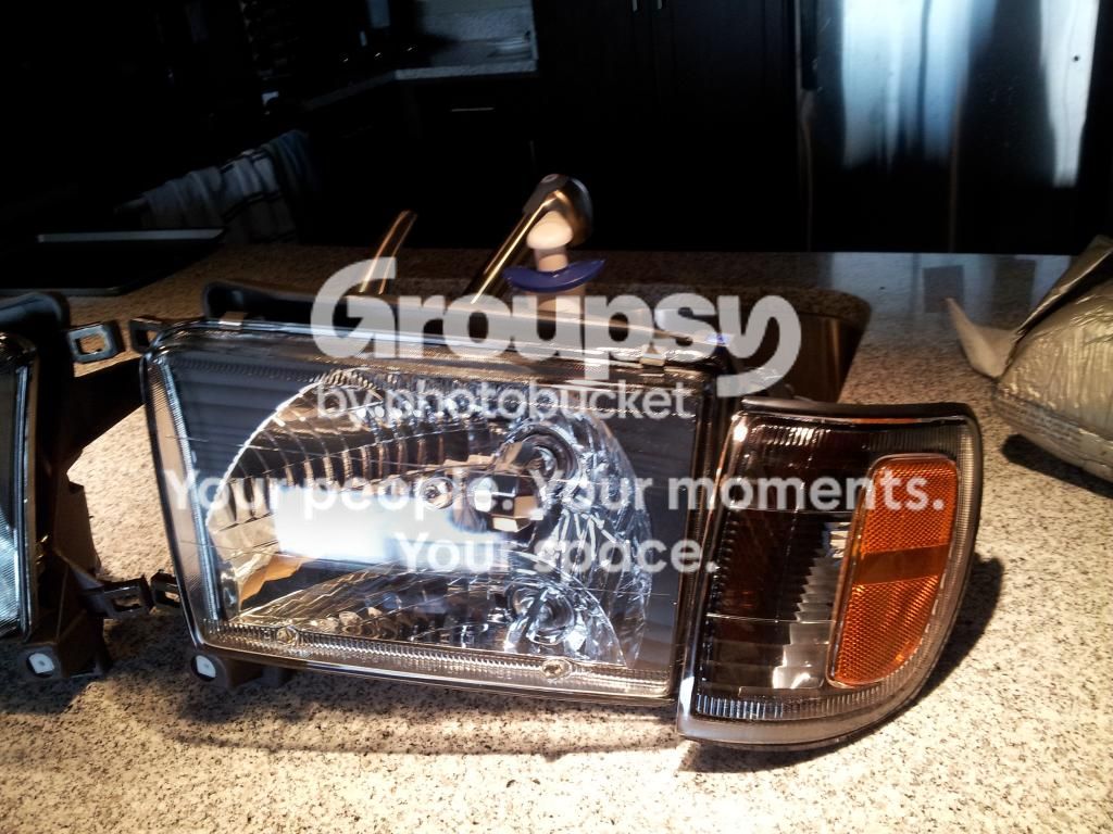

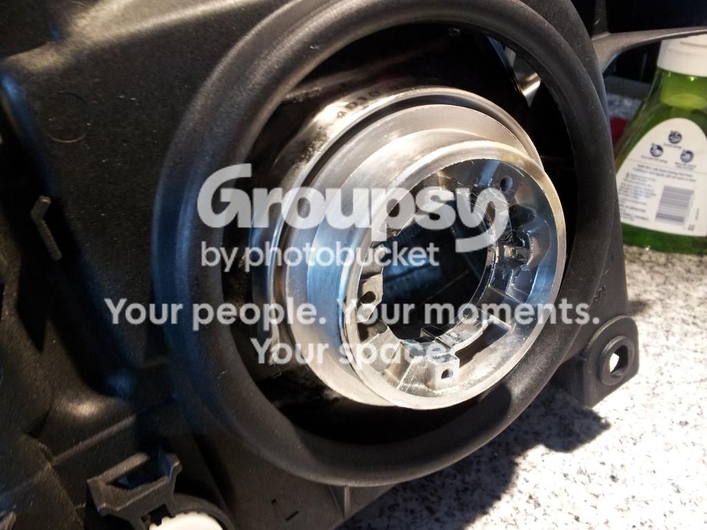

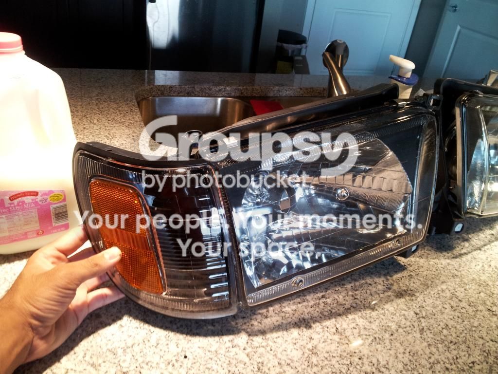

So I started on my retrofit. I bought the "JDM" black headlight/corner light set to use for my retrofit because I wanted the black corners. I'm almost finished with the passenger side headlight. I'm doing one at a time so I can concentrate my efforts on one and so the other one will probably turn out better lol. I've mocked up the shroud, glass and corner light in the picture. The projector itself has already been JB Welded so it's not going anywhere lol. Here are some pics, sorry for bad quality :/
driver headlight/corner light pair
passenger side
these corner lights are gonna look sick
Took out the bulb shield
no going back now, headlight is in the oven
mock up of projector
used a harbor freight "dremel" to cut the back of the headlight in order to get the lock ring to tighten down
