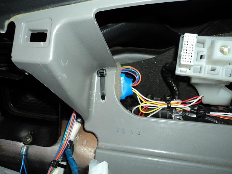

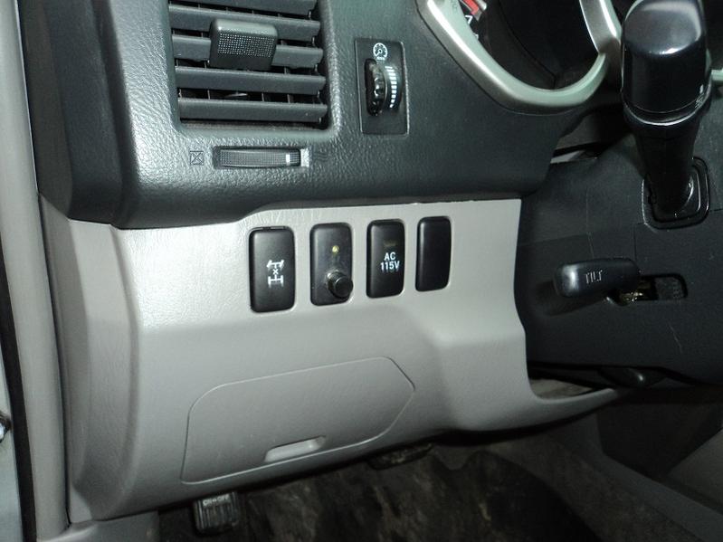

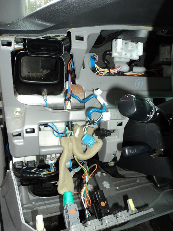

Kliv's mod has finally been tested on a V8. It works great, wasn't that hard to install and best part of all, no false indications on the dashboard. It took me the better part of 4hrs to install (Instructions can be found here: http://www.toyota-4runner.org/perfo...82-new-fine-grained-vsc-off-mod-v6-1gr-2.html ) , altho I soldered and heat shrunk all my connections and I tend to be alittle slower at mods that involve wiring...I like to triple check everything to make sure nothing starts smoking :). One thing I recommend is pulling your horn fuse if you dont want to piss off your neighbors...I accidently hit the horn prob 20 times during this mod lol.

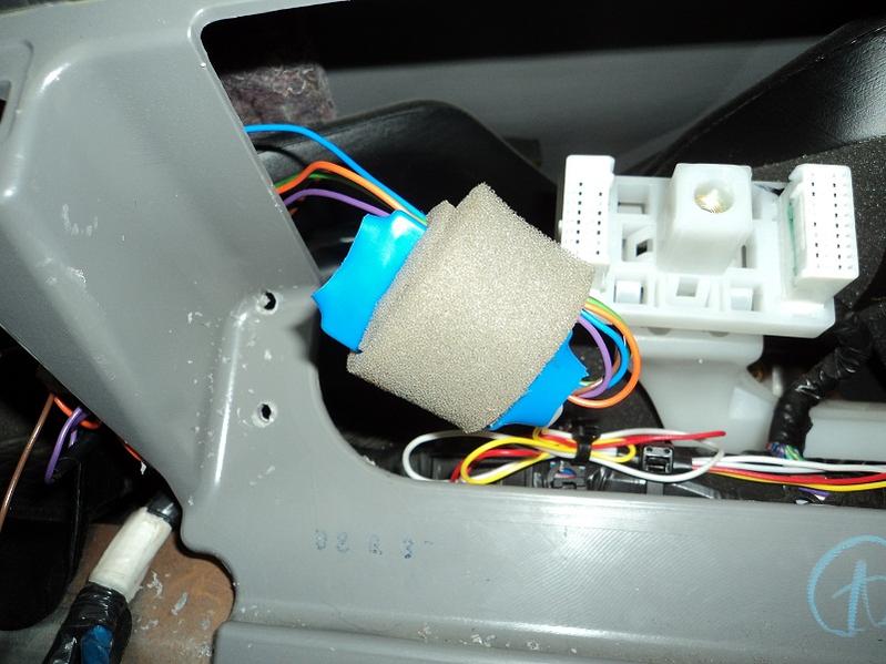

I wrapped it in foam to prevent rattles
I installed it with this button for now but I do plan on getting an FJ button for it. Oh and I installed the LED for the hell of it, not neccesary but it looks cool :biggrin2:

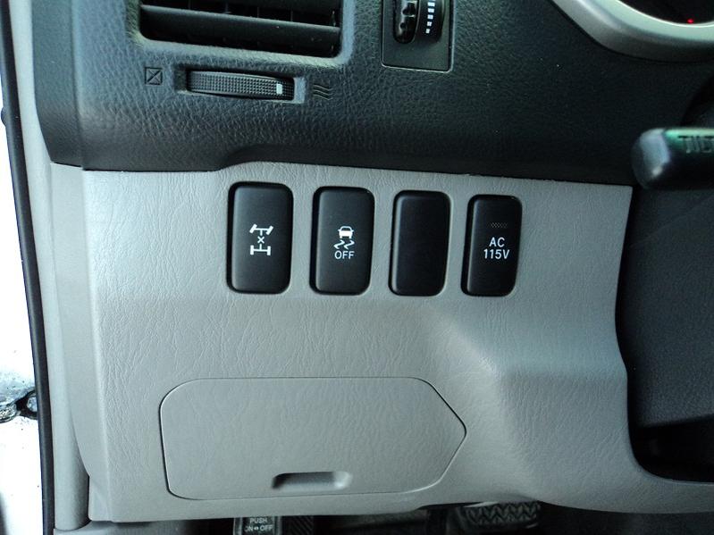

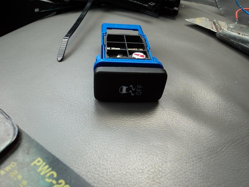

So I treated myself to a switch. I used an FJ traction control switch (Part #:84988-35070) as recommend by Kliv in his install instructions. Connector for switch was not needed because it comes it the V8's already :)
Weather was cold but I was too excited
Switch
Love the stock look, worth every penny.
