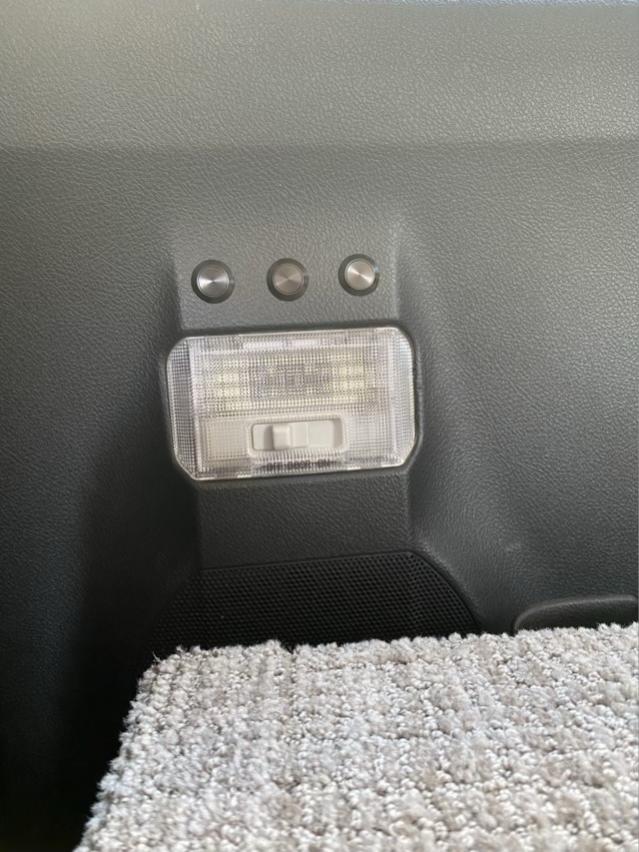

As many have mentioned [MENTION=165350]nytosc[/MENTION] was quick to answer my (to many) questions even before making my purchase. I went with the three button version after considering the ‘lite’ version. Shipping is quick, responses during install even quicker! For ease of access I installed the buttons in the rear hatch panel above the lights in order to clear a drawer bank/sleeping deck. This also made the installation quick, I would guess it took about an hour including a run to hardware store to get drill bit I thought I had. Buttons are metal and seem very durable, I like that the blend into they panel and are hard to see from the exterior!

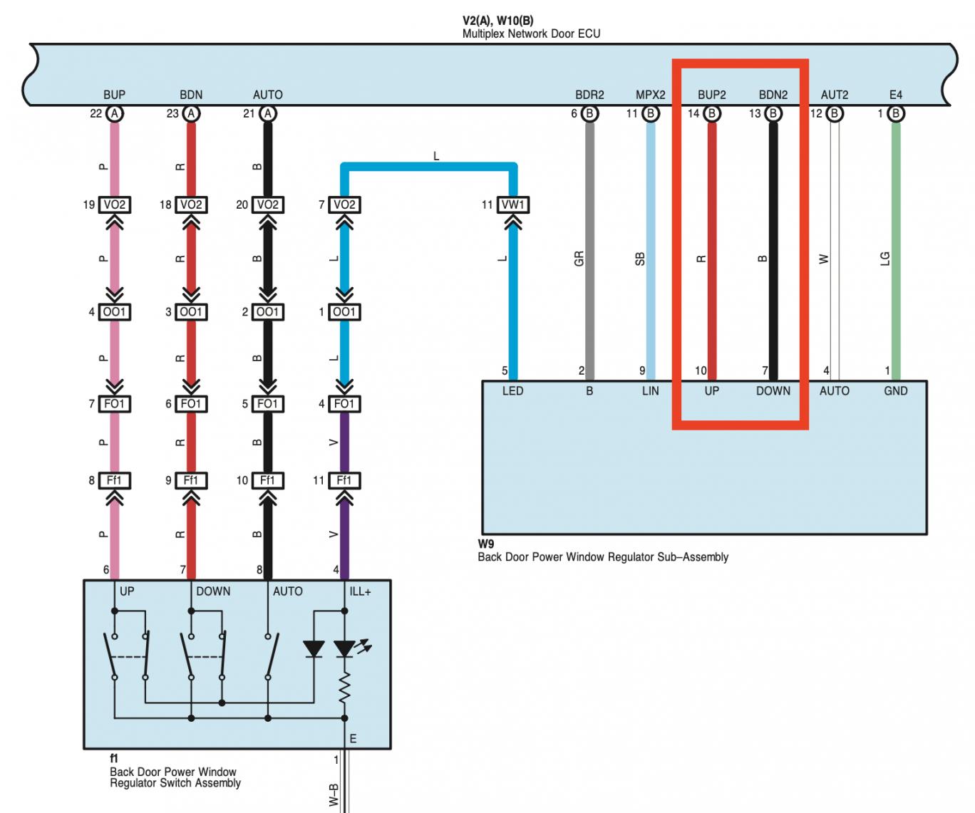

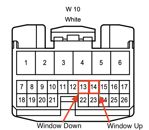

If we only want to control the window up/down, we can hook directly into the "Back Door Power Window Regulator Sub–Assembly" and completely bypass the quirks of having to deal with the smart key system (see attachment).
We could connect the window switch as follows:
Window up function: Connector W 10, pin 14 (should be a red wire)
Window down function: Connector W 10, pin 13 (should be a black wire)
For clarity, I've attached the locations of the pins on the W10 connector.
Disclaimer: This works on my 2011 limited, but may be different depending on the year of the 5th gen. Test this by shorting the pins to ground to ensure that you get the desired functionality.

Very interesting and clever! I’ve seen that on the schematic but was concerned that it does not take into account position of the window and it could result in the timing being off.
Does it present any issues when you go all the way up or down? Does it auto stop?
That’s a very valid concern, but nope! The window auto stops for me when going all the way up and down. The window timing shouldn’t be a problem because, from my best guess, the window regulator is designed to work independently of the main body ECU. There are two reasons why I believe this:
1. The window regulator doesn’t care about the position of the window. In most automotive window regulator designs, the motor knows when to stop by tripping its own circuit breaker. The circuit breaker is tripped if the motor tries to draw more power, which will only happen if the window is blocked. We can see this behavior even when operating any of the car’s windows in the fully closed position. You’ll hear the window regulator try to move the motor for a short moment, and then stop.
2. The only other control wire into the window regulator is MXP2->LIN and it most likely isn’t used for window position data for normal up/down operations. LIN is a very stripped down version of the CAN BUS which allows for bidirectional data transfer over a single wire. This did have me worried for a second because there is a possibility that this could be sending data back to the Door ECU for window position/stop position to tell it to stop the motor. However, if it was really the case that the window regulator didn’t know how to stop unless it sent a signal back to the door ECU, there wouldn’t be the AUT2->AUT wire for the auto window functionality and we wouldn’t observe the behavior in 1). My best guess is that LIN is used for controlling the window regulator for special functions, such as “all windows rolling down” with remote long press. As to why Toyota didn’t just get rid of the individual wires for up/down/auto window control and just use LIN, I’m guessing it’s for reliability reasons.
