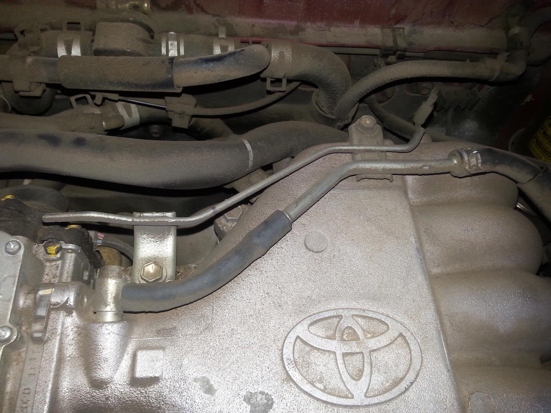

Off of an 01 i bought a few yrs ago, runs great, but wondering where this (vacuum?) tube should be connected to? thanks!

It doesn't, it's not used on 01-02. Actually, I'm not sure what models they actually use it on. But I know for a fact 01-02 don't use it.
I remember seeing this pop up recently. The T-100's used that if I am not mistaken. My 97 doesn't use it.
I want to say that mine uses it. I have the top of the motor all torn apart right now but when I get it back together today I can take a picture of it does
My 98 5 speed used that line. On the right it connected to the intake plenum and on the left it connected to a small actuator that held the throttle open. I not sure what it did exactly but if you unplugged while it was running the idle would go up. In other words the vacuum would hold the actuator in so the throttle plate could close.
Hope that helps
Hope that helps
I'm betting it's a 5speed only vacuum line.
