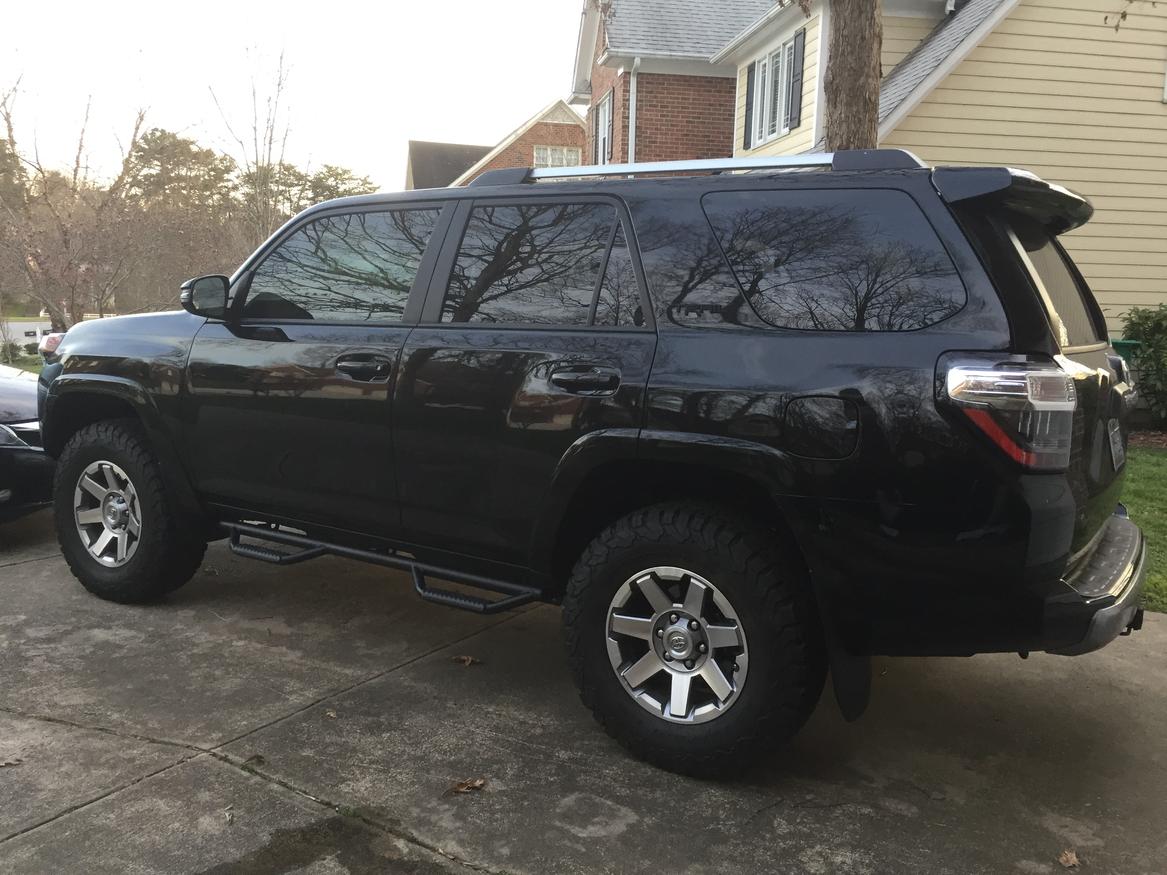

Here's a photo of the two to compare since I've seen several threads about members wanting to see the difference. Yes you will rub on your front mud flaps. Yes you will need to remove it like I did mine because it was pretty bad. I tried the old heat gun trick but that failed miserably. It could probably work if you take your time but just take it off. It's much easier and takes 5 minutes. I do get a little rub at full clock when backing up but can't figure out where it's rubbing

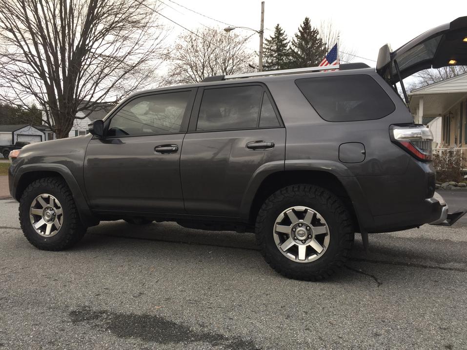

2014 TP, no lift, 275 KO2's. I do get a little rub under compression when I turn but not enough to bug me. I do have the bilstein 5100 ride height adjustable set with the rears coming but that's just to level it out. Haven't done an alignment, you don't need it just swapping tires. I will however get it aligned once I install the 5100's.

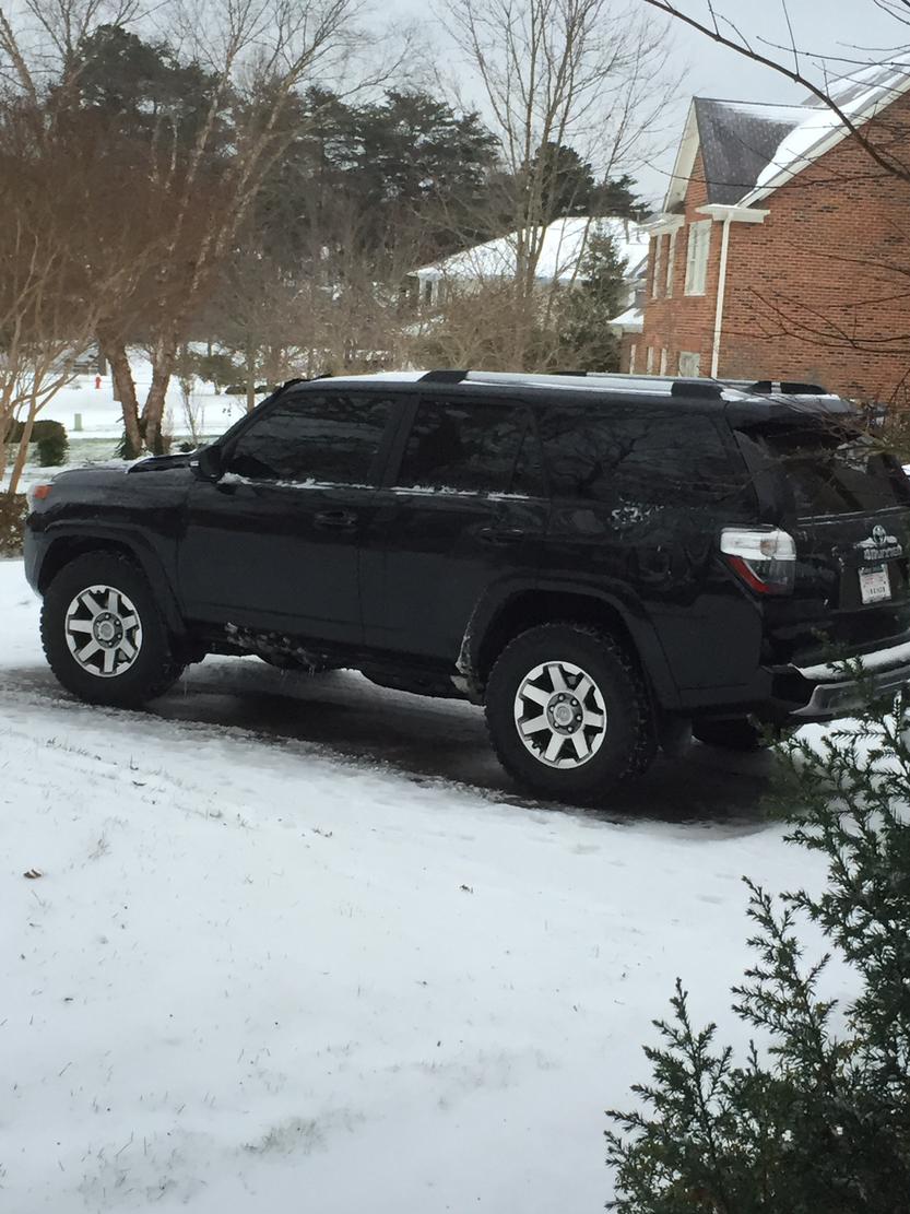

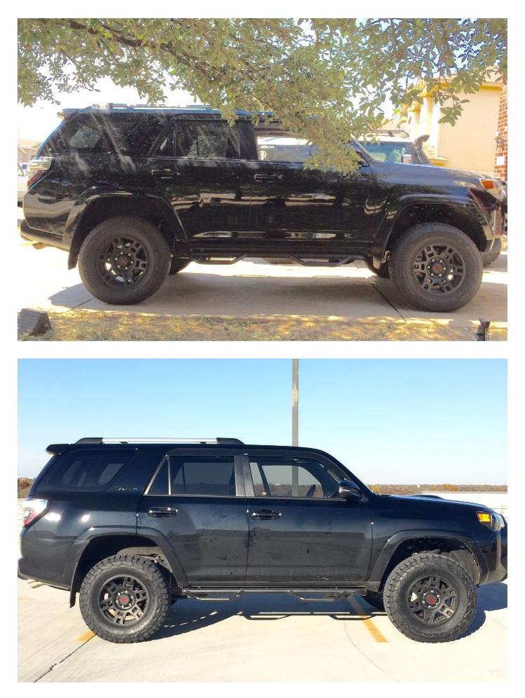

The main reason the wheels may or may not rub is due to the wheel offset. The Pro wheels will rub, while the TE/TEP wheels will not. the slightly higher positive offset creates a problem with the back of the wheels rubbing. The KDSS is not a problem. I installed the 275's on stock TEP wheels with no problems without a lift. I did later put a 2" lift on the front end to level the vehicle. Below are before and after pics of the lift.

Do you like your 2" leveling kit? Considering a 3" lift but curious if you're satisfied with just the leveling kit.
