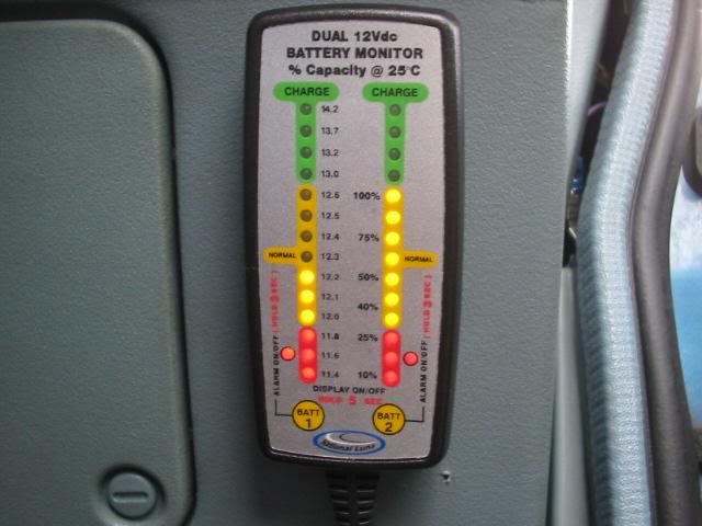

If you have dual batteries and have accessories connected, you need to know what's going on. Many vehicles alternators struggle with supplying enough charge for extra accessories as they are designed to cope with the vehicles system only. The only way to tell would be to fit a "monitoring gauge". See image attached:
