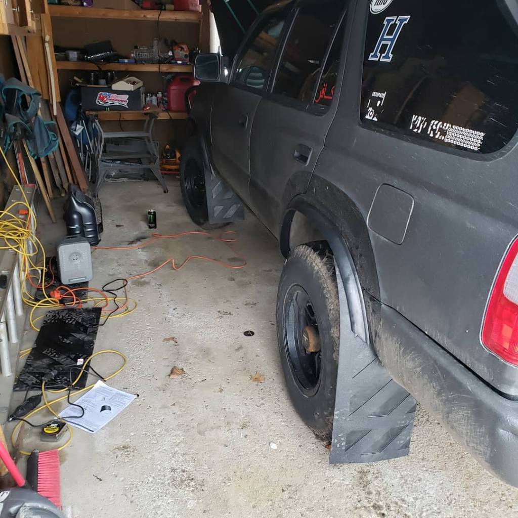

So far they've survived being mildly rubbed against trees and rocks, and having wheels stuffed against them. The rear mounting was pretty flat so pretty easy, the front took a bit more thought because of the angles. To get the mud flap part away from the tire I made a small bracket attached to the bolt that's a couple inches back from the wheel well My husband says they're pretty hoopty but I've never cared about that stuff....Kanoe's mudflap would likely be more not-hoopty.

I ended up finding some semi mudflaps for 40 bucks for the pair. They're flipping huge! Must be for the rear because most semis would not take this for the steer tire.

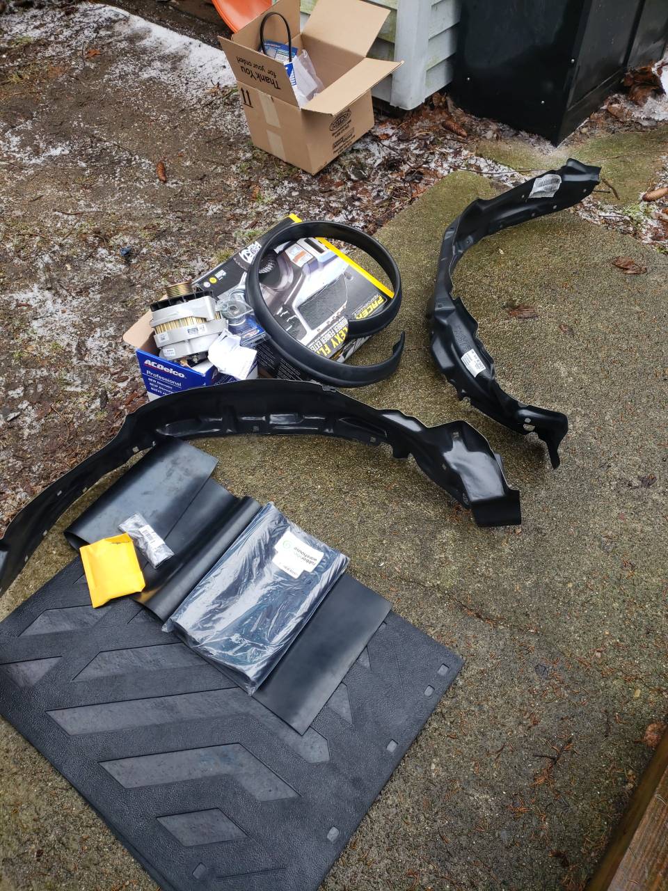

My supplies have grown substantially. I have new plastic splash guards, rubber mats, fenders (1 3/4"), and also some misc electrical parts to add this week. Sadly I had to get a rental car for two weeks but I should be done with everything by Friday. Lots of pics to come

The fenders and mudflaps work tremendously well. I was a little worried about clearance but the semi mudflaps are very stiff and hand pretty much vertically. When everything was attached the amount of mounts I was able to use actually made the flap itself pretty convex in the front which increased the clearance while turning. I'd say I ended up with 1.5 inches of clearance off the tire and it should be safe. They're also long enough that at full stuff the tire is not rubbing on the lower edge of the mudflap so the possibility of folding the mudflap under and ripping it out is slim IMO.

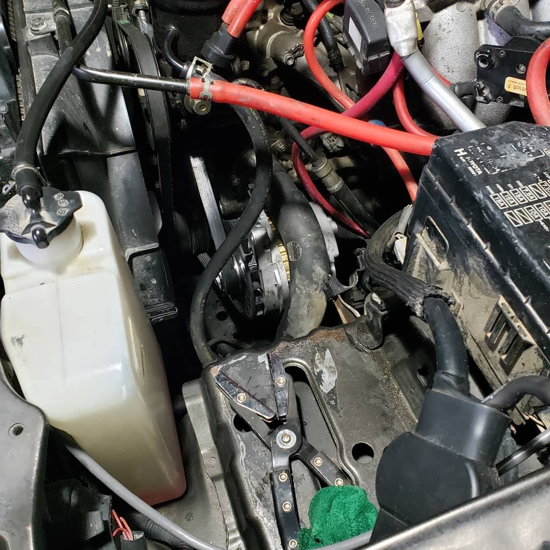

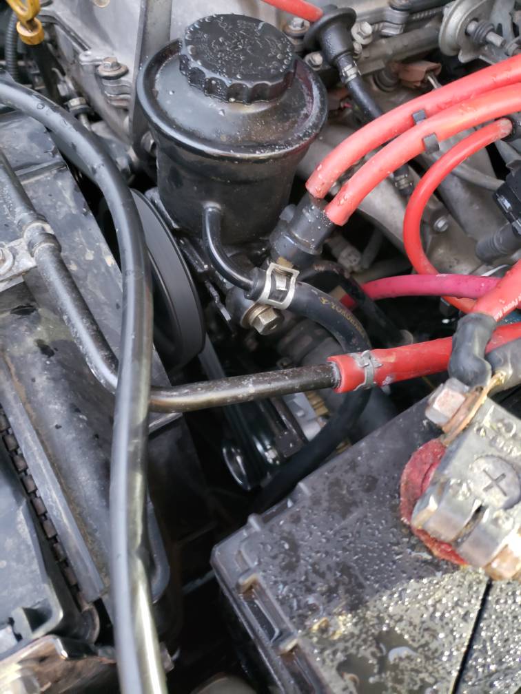

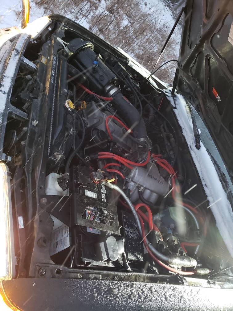

Bad pic of the engine bay but it's tidy and clean
CS144 installed. So it's not that great of a pic but the York should fit right in beside the power steering pump if I rotate the battery and shift some of the electrical stuff around. It's going to get kind of cramped in there but I decided it would still fit with a supercharger stuffed in (eventually, not in the near future)

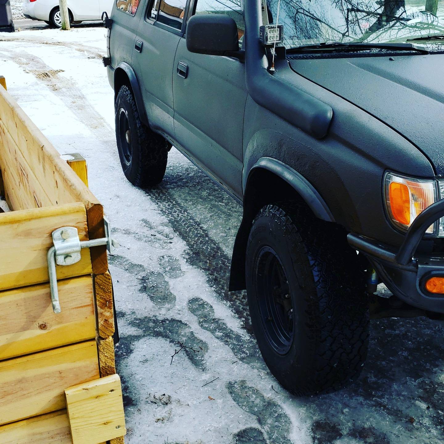

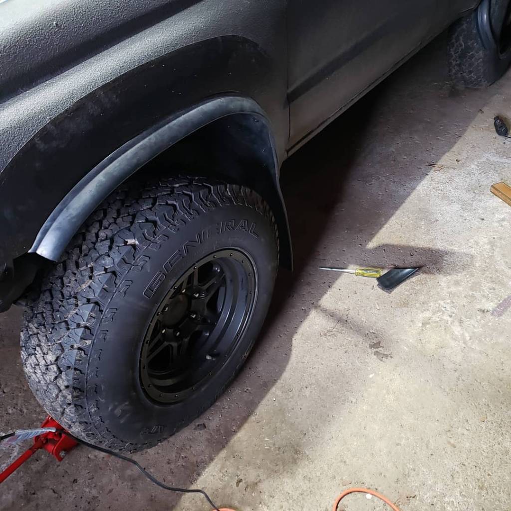

Better pic with the fenders and mudflaps. I actually need to adjust some of the mudflaps so they match but for now they function very well and the fenders I thought came out very well too. There's much less snow and water on the side of the truck and they don't create a void in between the body and the fender for moisture to sit either.

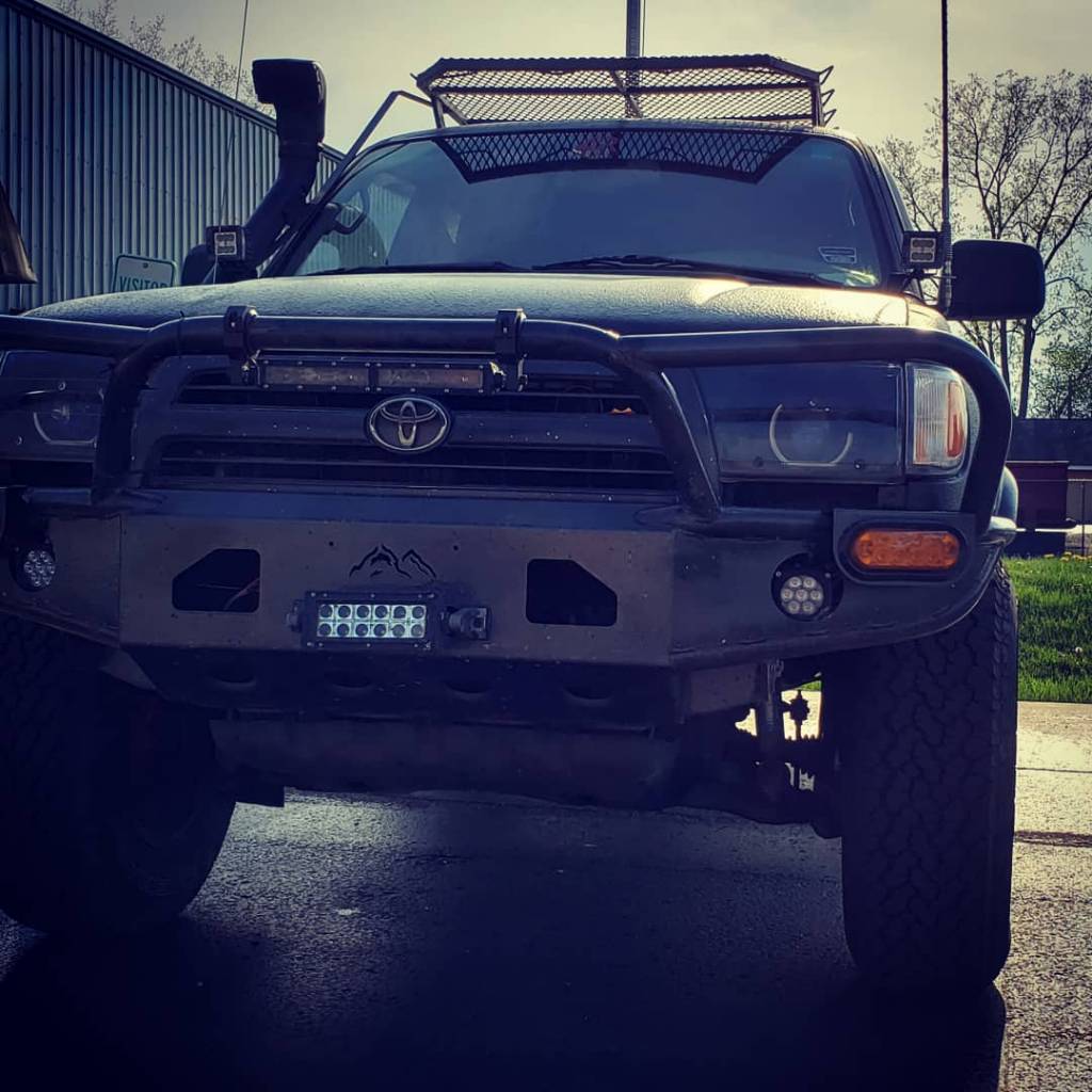

Pure glory shot but it was pretty weather for tooling around in the 4runner.

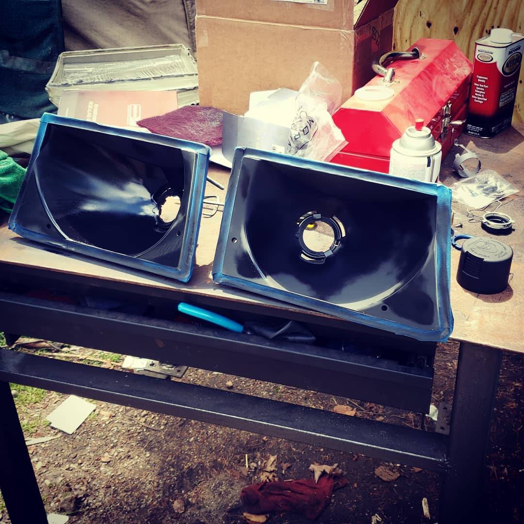

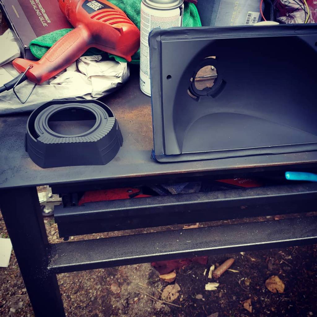

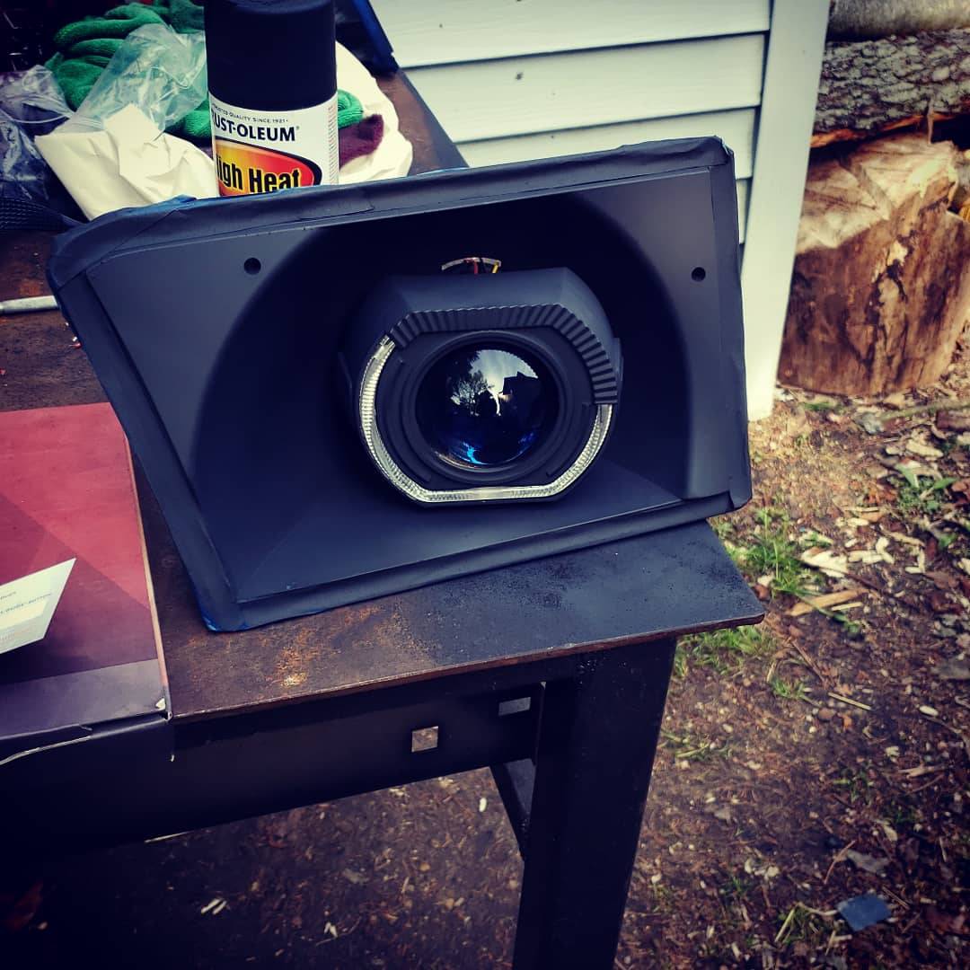

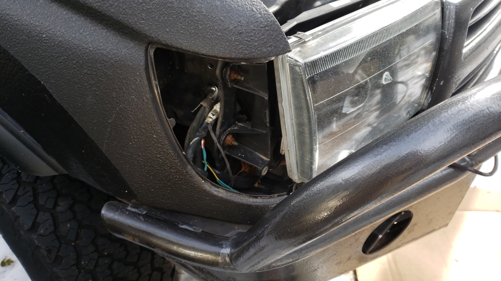

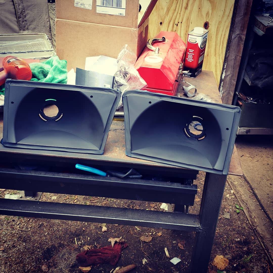

Finally got around to projectors for an upgrade. Man what a difference. Bambi is now visible. I didn't do anything fancy with these. I need to tweak the aiming a little as well and finish all the wiring up for the parking lights and turn signals. In the end I think I will be happy.
Trying to see if there is a way to wire in a drl circuit on a 98 that I can control. I know the stalks from the later models won't work with the steering column but any ideas are always appreciated.

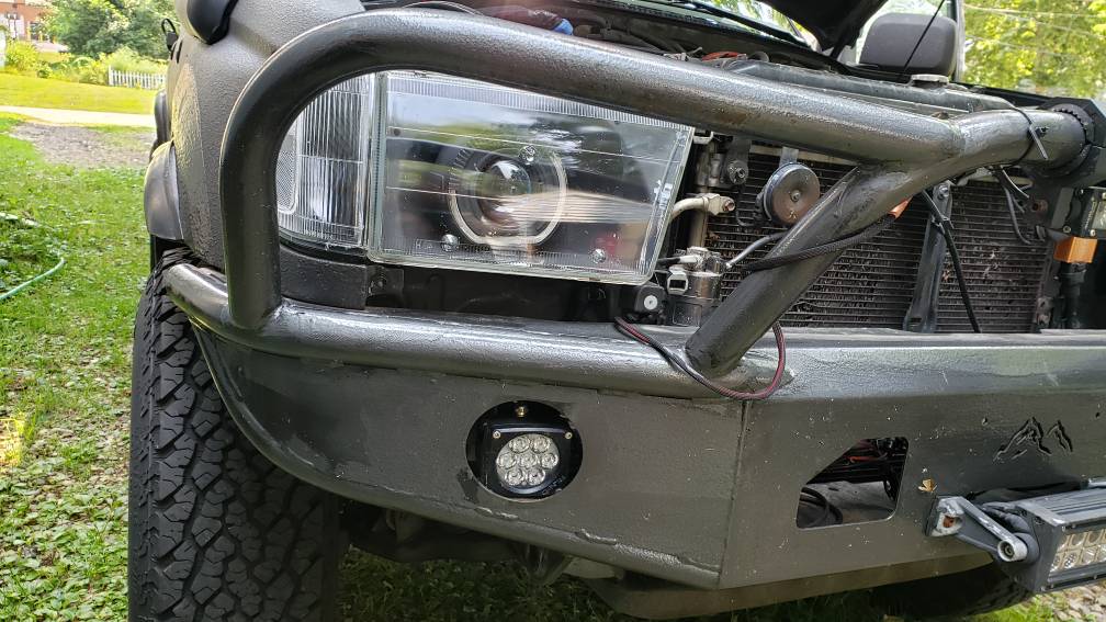

What shrouds are those? Did you get it from the retrofit source?
Sent from my Pixel 2 XL using Tapatalk

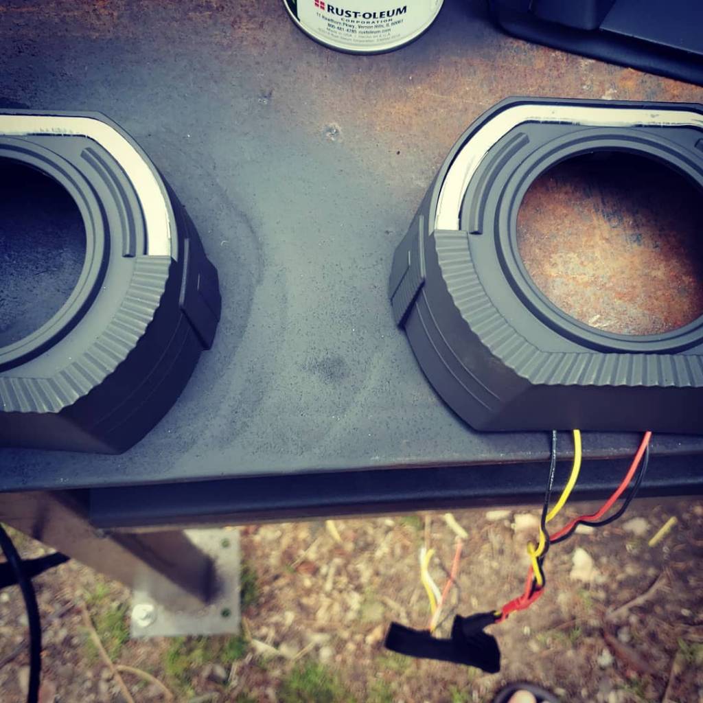

Yep. I can't remember the name off the top of my head but here's a better photo of the headlights. I didn't like the chrome so I busted that off and painted matte black.

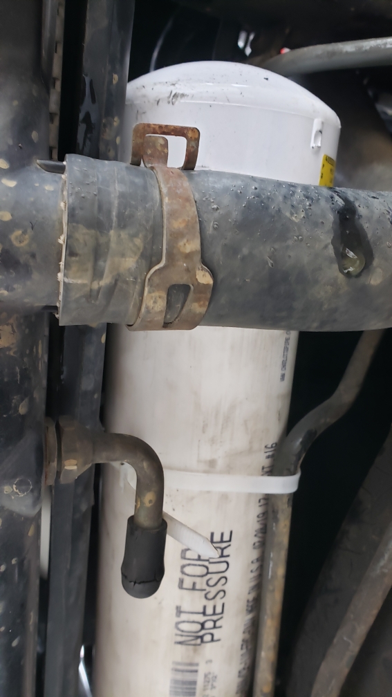

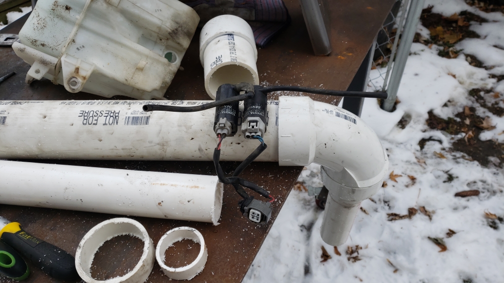

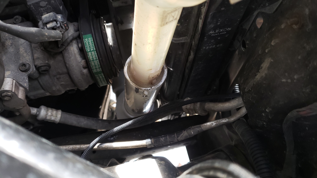

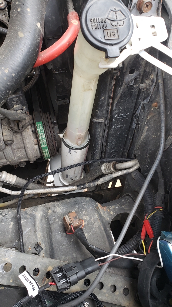

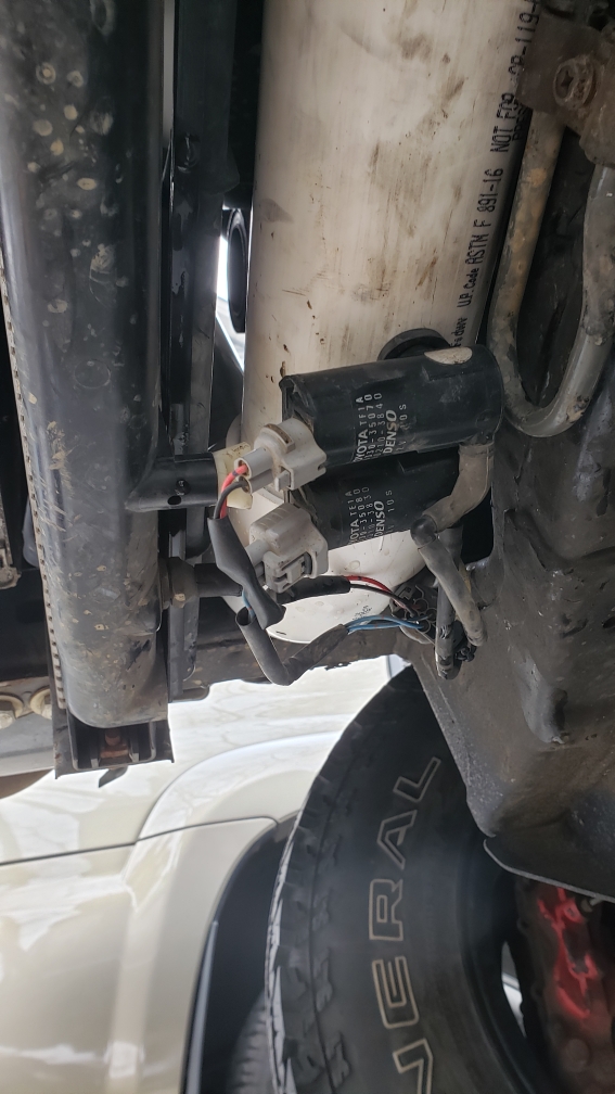

So I had forgotten that I had this issue during the summer but my washer fluid has been freezing because its exposed to the elements even with deicer.
$30 bucks at Home Depot.
2' of 3" pipe
2' of 2" pipe
3" cap
3" elbow
3 to 2" adapter.
If you can find a eccentric adapter you can tuck it a little further from the ac compressor but it's not dangerously close.
I lucked out with the stock adapter fitting in there. I had to slightly modify the rubber seal but trimming it was pretty easy.
Behold the new one
