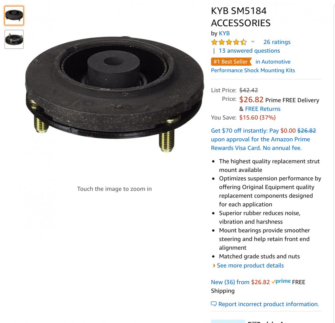

Second question - probably should do a new thread but who replaced the front shock mount wiht new shocks. KYB sells one for about 30 bucks. Mine have 200K on them but all in south

When I replaced my front & rear shocks (KYB) as well as springs (Factory Toyota) I replaced the front upper shock mounts with KYB SM5184 Units.
I’m in the northeast where the winter roads cause all sorts of rust so I replaced more for that reason than any other.......and 180K miles!
Not a bad job if you can get your hands on a spring compressor.

replacing is a lot different with cars with true struts.called mcpherson strut originally...in those situations the strut turns with the direction of the wheel. ( so the shock and spring are rotating when turning) The top mount has a bearing to help with that movement, bearings wear out..so on a "strut" car they are replaced more often due to the bearing. Although people often refer to our front ends as struts. even auto parts stores...napa...rock auto refer to our front shocks as struts...go to a place that specializes in 4runners...toyotec etc...they call our front shocks...coil overs. ...they are more coil over than strut but over time...people just call our front ends and coil overs as struts. I imagine the majority of cars these days now have mcpherson strut front ends...so I assume anything that looks close to that is reffered to as a strut.
In a strut, even those listed in the kyb add refer to the new bearings...those are needed in struts...the shock mounts you get for the 4runner do not have bearings, therfore no bearing to replace. However they are hard metal and rubber and I guess in time they can wear out too from corrosion or age..depends on your environement...rust belt ..etc. they are not spinning...just sitting still and compressed.
