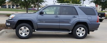

Anyway. I noticed that now the front is sitting significantly higher than the rears. Should I expect the new suspension to "settle in" and go down a bit, or am I stuck in a pop-a-wheelie pose now?
Did you replace the rear springs? If not, then that is the look you are going to have. If original your stock suspension will be 15 years old and will have sagged a bit. Good news is that replacing the rear springs with some new Moogs (or other brand) is not that expensive, and if you take you time and have all the right tools, not that hard to DIY.
No, I didn't. I left the rear springs as-is. But this has to be the biggest "duh" I've done to myself in a long time. That makes perfect sense. Thank you!
Is there a favorite write-up somewhere for replacement?

Turns out Morphyne was right on the money. It was the rear coil springs. I replaced them this afternoon with Moogs and love the way they turned out.
Replacing them was unbelievably easy. The only difficulty I had was my own fault -- I should have lifted the truck up a little higher than I did. Somehow I thought I could raise it "just enough" to get the wheel off, and the downward axle travel at that height would be sufficient.
Thank you all for good discussion and taking the time to help me solve this minor mystery.

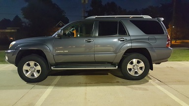

hinmo24t, if you don't mind me asking... did you ever determine if you did have a spacer in your fronts?
The front still looks far too high. The rear should be higher than the front for improved driving characteristics and the fact that it will settle with any weight in it.
I have the same Daystar kit and KYB and yes the front is a twinge too high but not really noticeable if you aren't picky. In a couple years, I bet it levels out.
