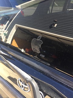

First step: no free advertising for Apple, even though I'm an avid user!
IMG_1483 by Kristen Jensen, on Flickr
Gone!!

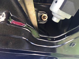

Started pulling the rear hatch apart, to see if my rear lock cylinder was actually missing, and I noticed that there was evidence of scratching on one portion of the rear glass. What I found:
IMG_1484 by Kristen Jensen, on Flickr
My rear lock cylinder is there, but the little plastic tabs that hold it to the outer surround are busted. Junkyarding/ebay we go.
Secondly, there was a bracket behind the window motor that was not attached on one side:
IMG_1485 by Kristen Jensen, on Flickr
Got out the long wobble extension and the step ladder (so i could actually see and find the appropriate hole) and reinstalled.
Put the inner stuff back together. Leaving the plastic off for now til I can find that surround piece.

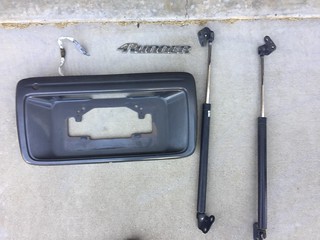

Trip to the Junkyard was a success.
Got my missing 4runner badge, picked up a good set of struts for the liftgate, and the surround for the lock cylinder. Plus I acquired a bunch of those 10mm bolts and some of those red upholstery pin things. Total cost including entry fee for myself and the cohort: 17 bucks and change.

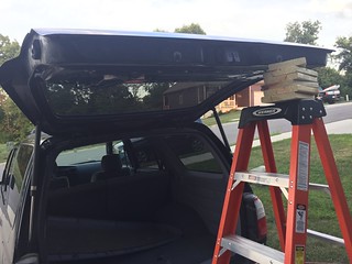

Started in on replacing parts tonite. Did my tailgate struts first.
My tailgate support while I did each side. Figured out a 6' fiberglass ladder and some leftover pieces of decking were the perfect height. My assistant also did not whine, moan, or complain at the length of time, or the adult beverage break I decided to take midway through.
had to take the requisite halfway done photo.
End result: no squeaking out of the rear hatch struts. goes up nice now!

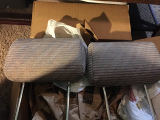

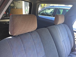

First item showed up today. It may be small, but its the little things that count sometimes. Got new headrests for the rear seats, as mine were non-existent when I picked it up.
Well......today was interesting, to say the least.
my super-cool, clean headrests for the back AREN'T the right color....oh well! adds character! at least they are clean!

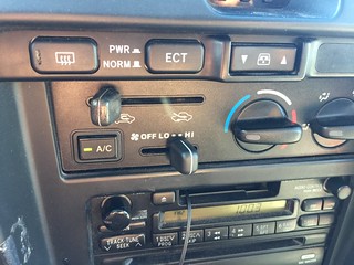

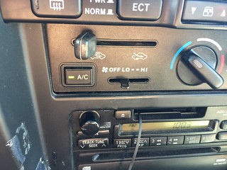

Went and picked up the missing knob for the fan control lever.
I think I should have ordered two!!!!

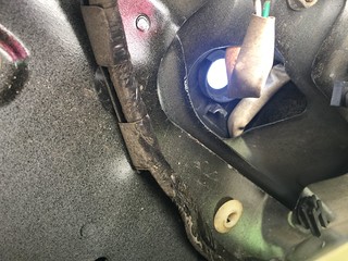

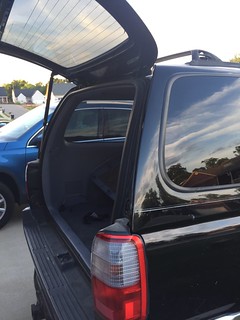

Came home and started tearing apart that back garnish/trim piece that goes around the license plate that holds the key switch for the window.
My retarded blonde self forgot to install the latch on the inside and closed the hatch to test operation.......then proceeded to have to sit INSIDE the cargo area...pull the metal cover back off, and install the interior latch portion.
Toyota service manual says to pull the rear window and regulator....NAH! Not if you got small enough hands and arms and a decent amount of flexibility!
Finally managed to get it all back together again after an hour (or two) of work. Ended up having to make a run to the parts store for those little push-in body clip gizmos. One corner doesnt quite fit flush.....not sure if I did something wrong or if a clip isnt seated correctly into the back of the garnish.

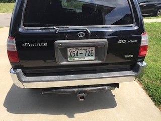

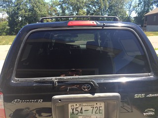

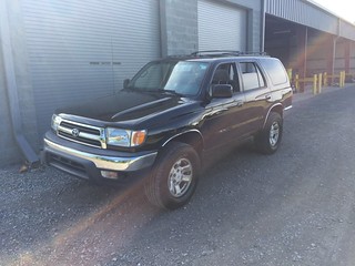

Had to go help chase a cow/calf pair this afternoon. Had to take a pic of him pulled up to the shop.
Nice work so far and who needs matching seat parts (not me!)? Looking forward to more. :thumb3:

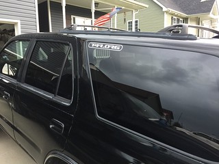

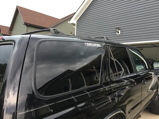

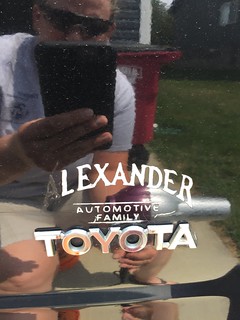

I hate free advertising unless I decide it needs to be there:
Goodbye!!! Took most of it off with a hair dryer and my finger, then finished the job with some goo gone, then finished cleaning any residue with windex.
I also added free advertising.

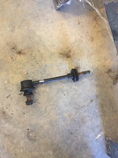

in my attempt to diagnose my leak yesterday found a broken steering stabilizer link. those flipping things are 80 bucks a piece. If one is busted, I'm gonna replace them both as a precautionary measure.

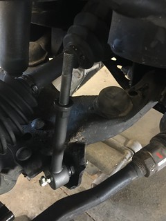

I'm going to buy a set of MOOG sway bar link ends from rockauto. A couple of months in savings and I plan on buying the BOSS Toytec suspension lift kit. 48 bucks vs....160 bucks to hold me over for a couple months.

Ordered MOOG swaybar links today. Should be here tuesday. IF.....they arrive in time, thanks to the mess created by the eclipse.
stuff is getting stupid already between here and Hopkinsville KY. If I didn't have to work out at the APSU Education Environmental Center that day, I'd be a hermit and stay home that day.

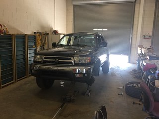

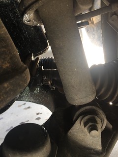

The MOOG sway bar links got here Friday. I installed them today. I ended up having to leave the shop at the farm halfway through the install on the first side.

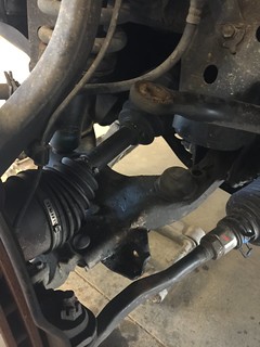

Drove it home. The sway bar link is trapped under the CV axle, and it ripped the boot and pulled the bottom clamp off.
Had to call my neighbor to help me get it out from under the axle shaft. Finished the install with relatively no issues.
What a pain day. Felt like absolutely nothing went right.
Now I've gotta add a CV boot repair to my list of things to do.
