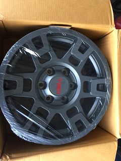

These showed up Saturday!!
My one splurge for the truck, but they're worth it. 800 bucks off ebay. Brand new. I'll pick up a 5th one here in the next month or two, when I get my maintenance stuff done.
They wont be going on the 'yota until I get the lift kit done. Only going to buy new tires once.
