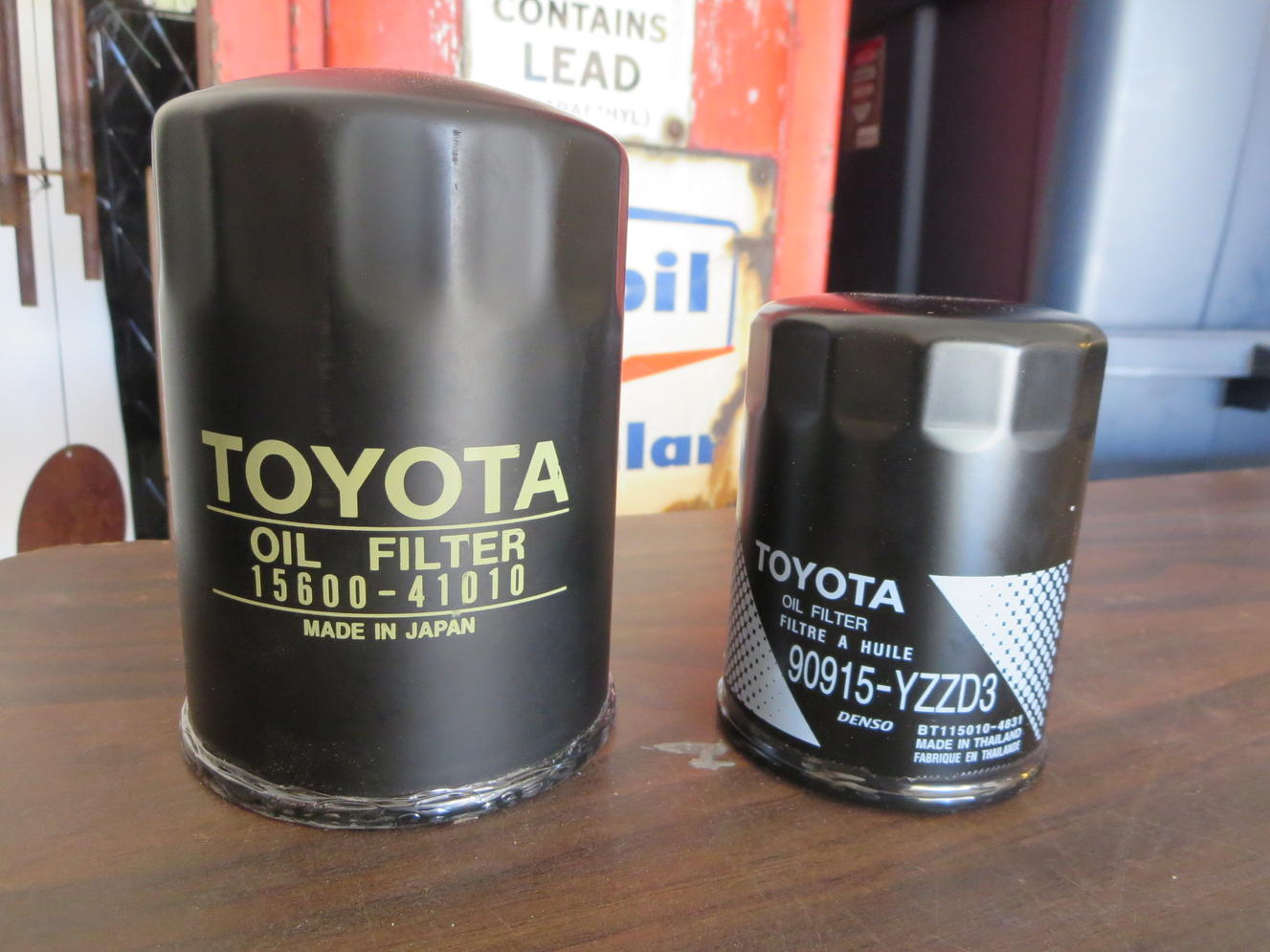

Was it my imagination or was the larger oil filter 15600-41010 made in Japan a good fit for the 3rd gen 3.4 liter? I recall reading that it was desirable large filter for that application or is it too big?

The 15600-41010 filter was replaced by 90915-YZZD3. The 90915-YZZD3 filter will work on a 3rd Gen. It's going to be a tight fit, but it fits.
I use the YZZD3 exclusively. Fits just fine. Holds a little more oil though, 6qts on the nose.
The 90915-YZZD3 is going to be a tight fit? Or do you mean the other, larger one?
The D3 fits easily, been using them for years. Either the 99 or 02 has a hose or cable that sort of gets in the way of installing but it's no big deal. I didn't need to add any more oil than usual...the filter really isn't much bigger
The correct filter for our trucks is the YZZD1. Many here use the YZZD3 as its the same filter, just a bit longer. The D3 fits just fine.
Treat me like a 5 year old - why is the bigger one "better" if at all
The more oil in the system, the longer it takes to get dirty. Also the more heat it can absorb and dissipate, not only in oil volume but in the filter's larger surface area. And the more filtering media surface area, the longer it takes to clog and the more contaminants it can hold before the flow is restricted. Granted, the D3 is not much bigger, but many feel that every little bit helps. Since you're replacing it, and I'm not aware of much of a cost difference between the D1 and D3, I think it's more why would you not go for the bigger filter?
I don't think there is any cost difference. Both are 5.60 or so at my local dealership. Worth every penny.

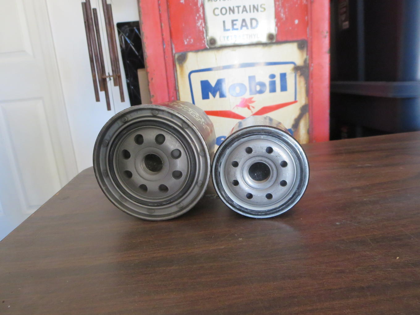

The 15600-41010 is not only longer, it is wider by quite a bit. Has anyone actually run one on their 3rd gen 3.4? I added another photo at the beginning showing the bottom/threaded ends.
