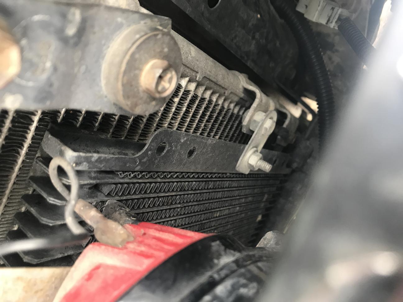

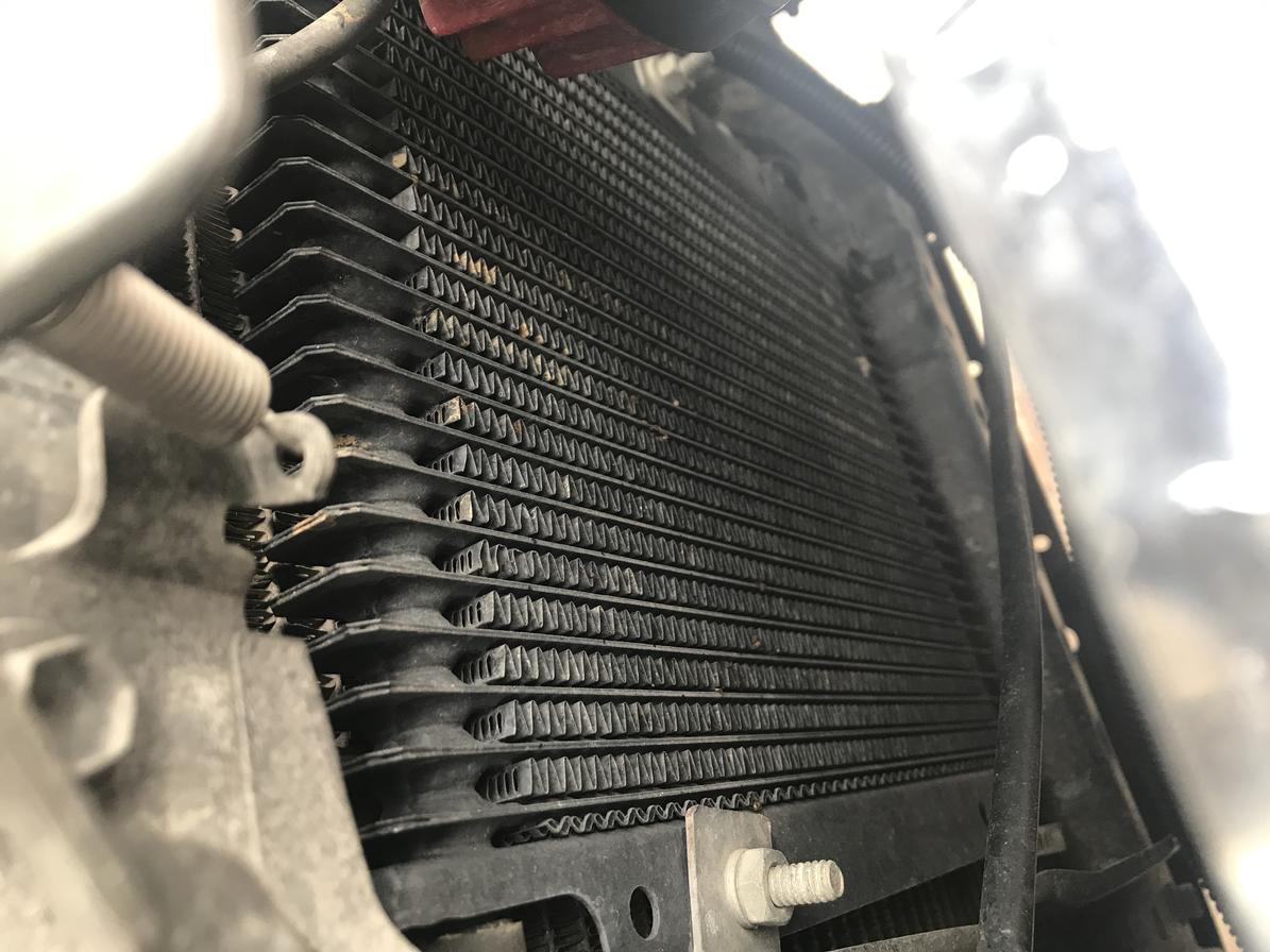

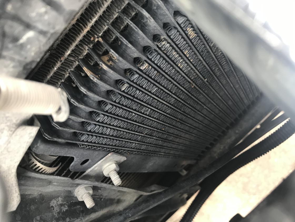

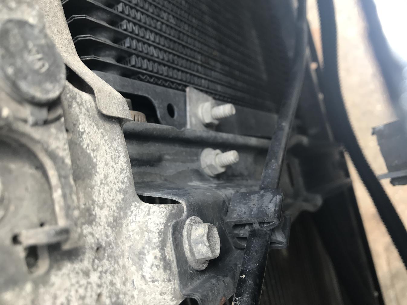

As promised [MENTION=198376]4Runner4Leon[/MENTION] here is pics of my setup. Notice how the only thing separating the cooler from the condenser is little foam pads.

That's a nice (and certainly simpler) installation! That convinces me to ditch trying to fit this square peg into a round hole, and get a "normal" cooler if I decide I need one (I am using my new gauge to monitor the temperatures, so I'll wait and see how high they get during use).
I wouldn't skip on a cooler, at least in the long run. Nothing kills auto trannys like heat.
If you are looking for one, try and get one that has a LPD (low pressure drop valve built in) that won't open until a certain temp to allow the ATF to warm up (the popular B&M 70264 begins to open at 170F and fully opens at 180F).
the placement of [MENTION=136902]thecole1098[/MENTION] cooler is good, and the temps he sees prove it.
