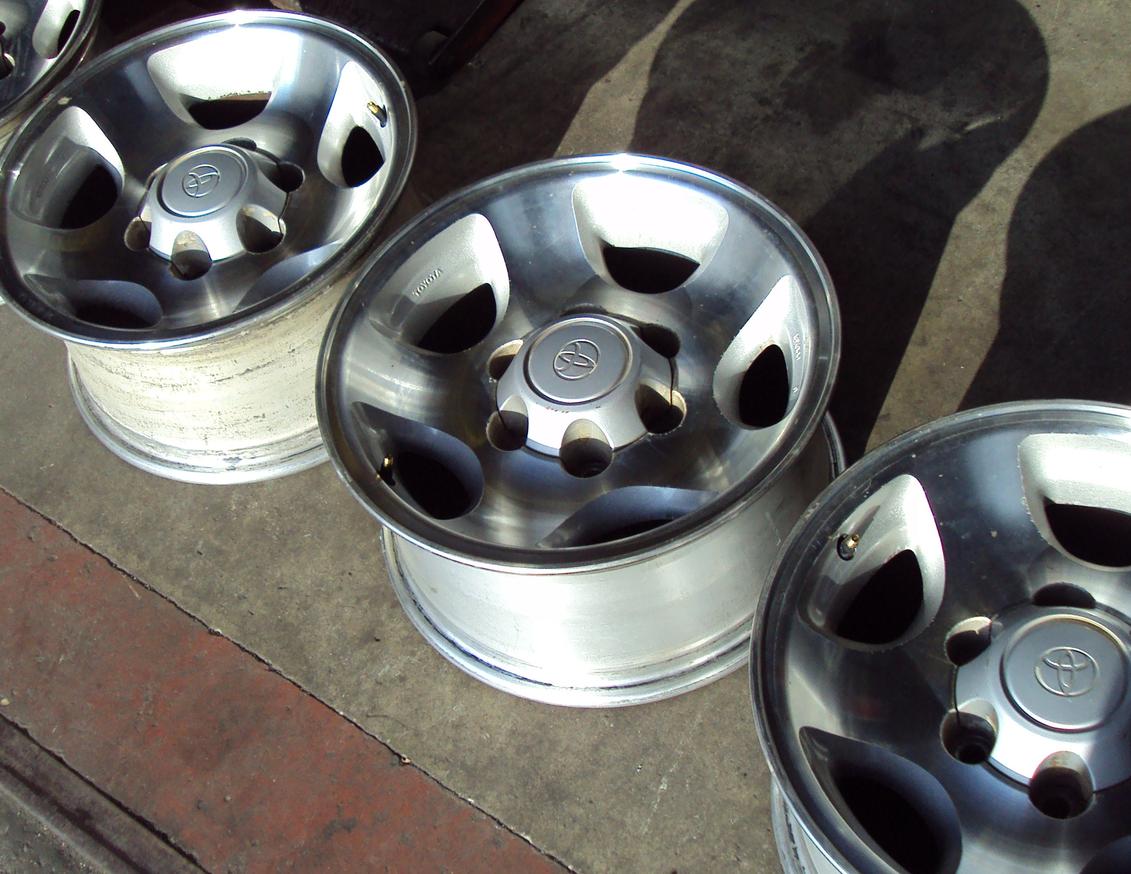

I want to install my recently purchased 1997 landcruiser 16" wheels on my 00 runner. My runner is equipped with the 199mm tundra fr. brake upgrade. What wheel spacers do i need for these wheels to fit? Any con's with running wheel spacers? These wheels are hubcentric so i can still use my oem lugnuts from my 4runner. Thanks in advance for the replies.

Either use a flap disk and grind down some of the caliper or inside of the wheels. Be sure to do this before you mount and balance your tires. If you rather just run spacers you might be able to get away with running a slip on 1/4" spacer on each side.
