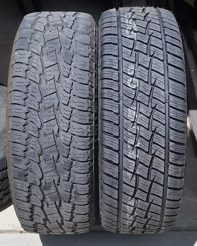

275/60/20's - Cooper HT-Plus.
Quiet. Smooth. 43lb each. $125 ea. What's not to love?
Also they're 119T rating at 50psi - so they're rated for more weight than a 265/70/17 E rated tire at lower pressure and also have a T speed rating. Many 275/70/17's don't have a high enough speed rating to match the OEM tires - like the BGF KO2's are only "R" speed rated, so they're less than OEM and some shops won't put them on. I only go over 100mph in school zones, so it's not too big of a deal for me, but mostly an issue at some shops.
They're limited offroad because you can't really air them down much. They're fine for fire/mining roads where most of my dirt road miles end up. When I'm into winch/rock slider territory I swap to the 17's with offroad tires.
Rides a lot better than my 285's on 17" wheels. Mostly due to street tires vs ATs. They're also tall than a 285/70/17 by about half an inch. The lower pic is side by side with a 285/70/17 Toyo AT2. It's fairly worn even though it has less than 20k miles on it. I'm kinda hard on tires.

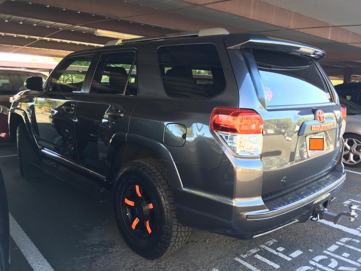

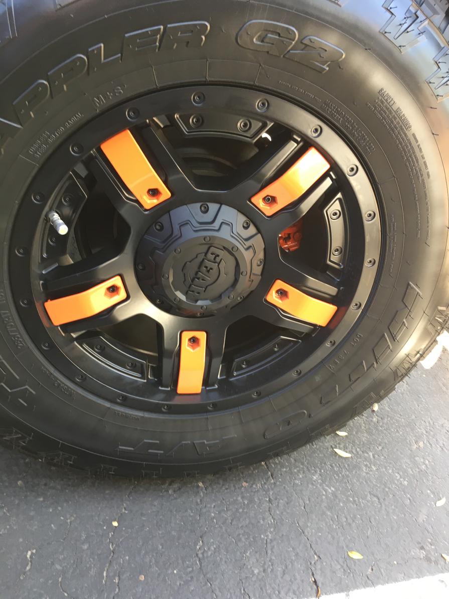

I just replaced my stock 20in rims with these from Gear: 740B ? Gear Alloy Wheels with custom paint and new Nitto Tires: Terra Grappler G2 All-Terrain Light Truck Radial Tires
as well as pulled out the crappy XREAS system and replaced with Bilstein 5100's.
It rides better than before and I think looks great.
