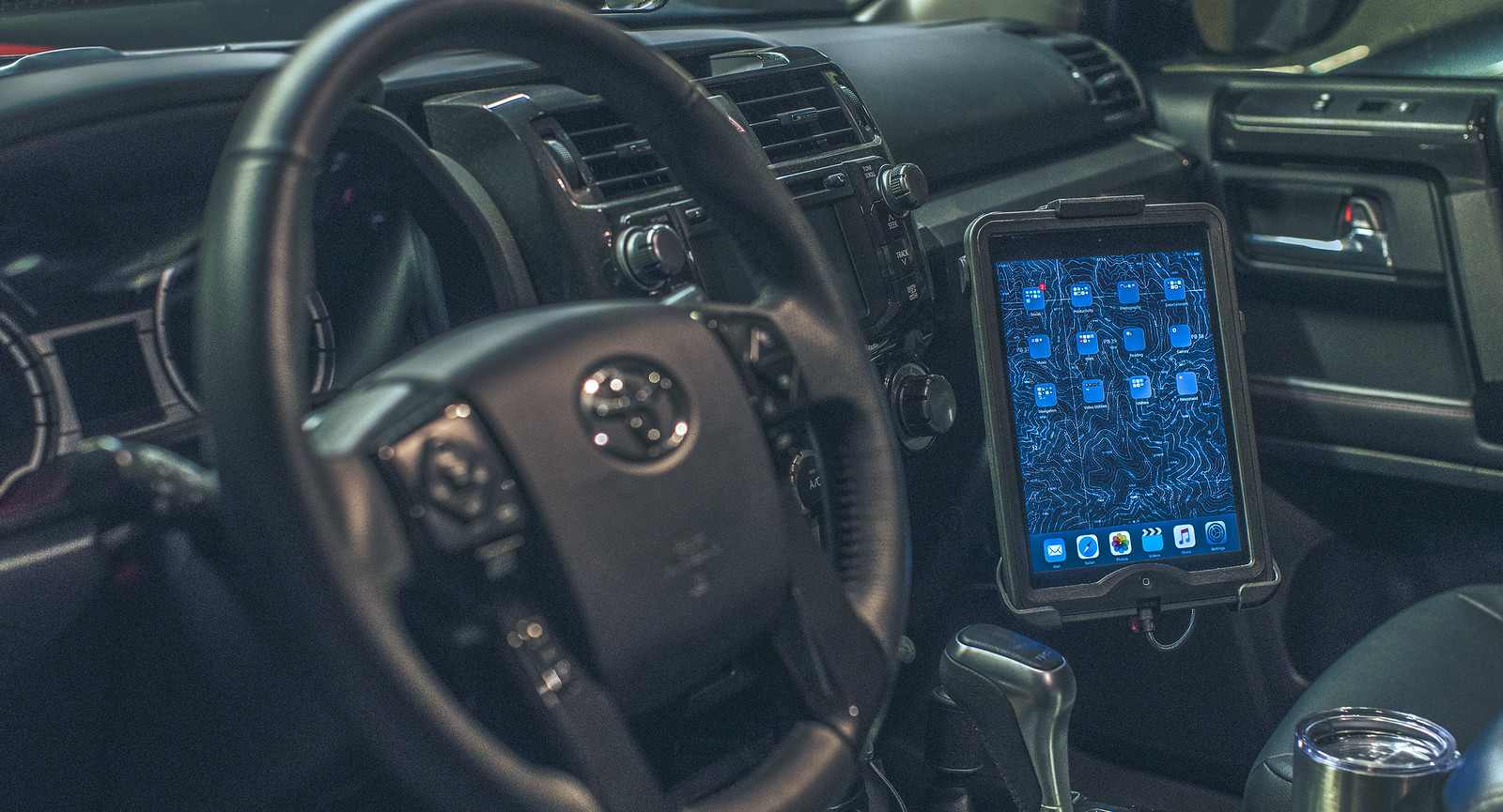

Mounted up the old iPAD air into the interior, using the DUAL XGPS. Along with a few apps the results are great. As long as I pre-cache map data I now have real time trail maps.

Nice setup...been looking into something more advanced than the stock Nav. Where do you mount your XGPS?
We drilled two holes in the roof and ran the cables down the passenger A pillar, behind the airbags obviously, and then down and through the firewall. The holes were sealed using marine press grommets and some RTV sealant to ensure everything was water tight in the rubber roof channel. From there they went up to the roof rack and which comes pre-wired from the front to the back. In that photo you referenced you can see both wires on the roof rack between the rails and the top of the roof.
Hope that helps.

Still some more tweaking on the mount. While there's some wobble it's way less than the standard iphone cup/RAM mount, I'm super impressed. It doesn't block any of the controls or access to the transfer case lever.
Got it all wired up with the XGPS 160, and with GAIA and MotionX it works great.

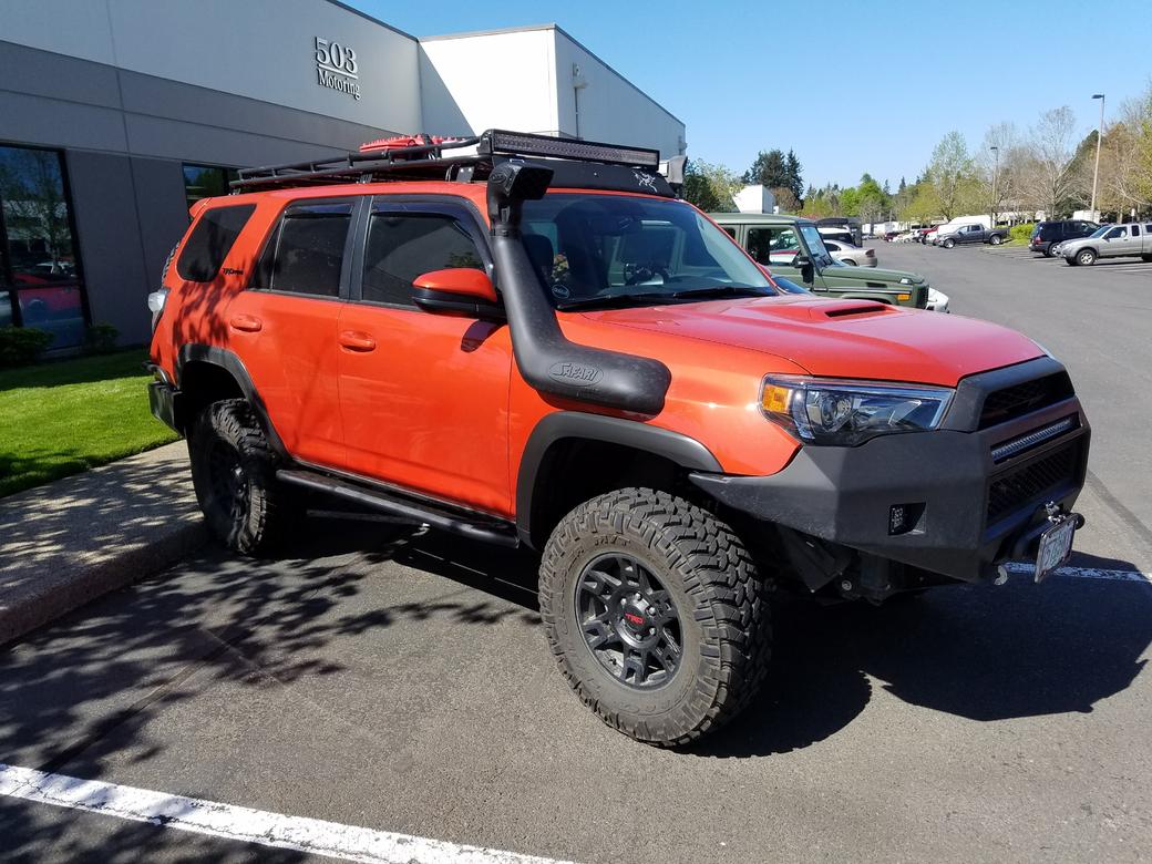

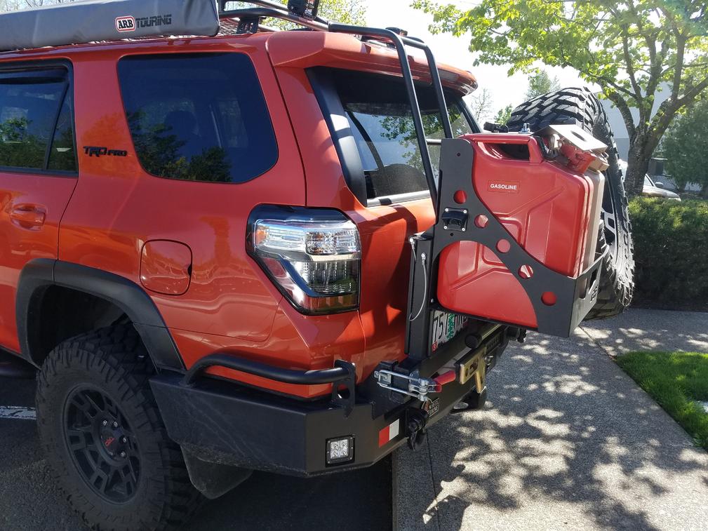

Lawndart,
Just missed you today. Drove by 503 and saw the truck, couldn't help but stop and take a few pics. Was in a rush and forgot to take one of both our rigs. The armor looks great. Hoping to get the upcoming Metal Tech front bumper, should be a similar design as yours. How did you get name on the rear bumper?
Maybe meet up for a beer sometime, would like to pick you brain on a few things. Have a great trip

Lawndart,
Hey man, I was actually in the shop when you drove by a second time.
Iain said that an orange 4Runner came by, and I knew it had to be you and the metaltech rig, and then as we were talking you drove by again.
Yep the truck was at 503 today finishing up a week's worth of work, specifically we bypassed the rear camera and installed the new camera on my swing arm, Icon shin guards and rubber shock booties, new Pelfreybilt rocksliders, and a few other little tweaks before I head south to the Mojave Road.
And yep, lets meet up sometime, surprised we haven't crossed paths yet. As for the rear bumper, I used this: Toyota more than a car.
Then I rattle canned them black primer, and it was a near perfect match.

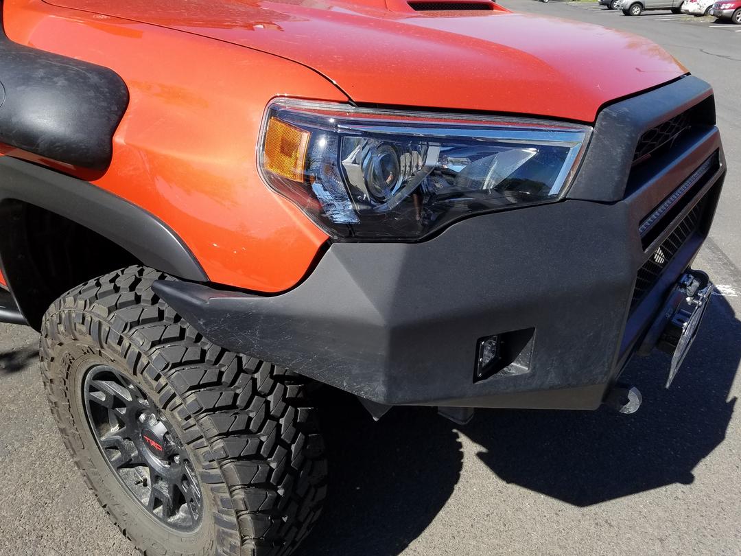

I absolutely love my Pelfreybilt bumper, but I was a tad dismayed when I lost the old school TOYOTA on the valence. So I purchased an OEM Series 70 LC emblem, and constructed a bracket to bolt it into the standard grill.
Brings back a bit of the old school look and the TRD front end while remaining true to the brand:
