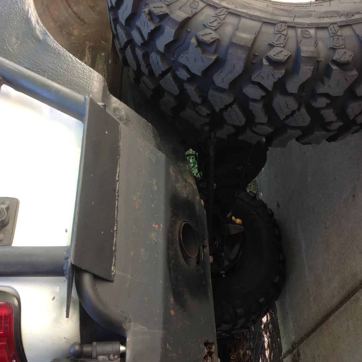

You don't think a side exit before the rear tire will get smashed?
Why not just run a down dump? It will be loud and resonate off the ground but would allow you a higher exit location.... And or you can run it as a side dump out the rear through the side plate of the bumper.... Not sure how that looks under a 5th gen, that's what I did on my 80.

I suppose I could always do the magnaflow and just do a down dump.
Or I could just keep the stock exhaust and just do side bend. Thoughts?
I'll try to grab a shot later of my 80.
Basically look behind the rear tire and see if you could run it high and out the side behind the rear tire if you were to cut a hole in the rear side plate of the bumper...
Having the exhaust tip flush with the side skirt of the bumper would keep it fully protected, up high and behind the wheel for safety (less chance of fumes inside the cab)

It's surprisingly close to a down dump at stock. I'd like to see what you've got trail-ammo.
I've wanted to put mine to the side because I love driving with the rear window down,
but no matter how I look at it, I'm going to lose departure, and I really don't want it getting crushed or worse.

Yeah I crushed the shit out of my pipe at Moab. So I need to either do a side dump or a better down dump. Cutting a hole in the side might be doable. I'll see CBI this week at FJ Summit. And if my new bumper hasn't been powder coated yet I can ask them about making a one with a hole before they powder coat it.

I've seen several photos of crushed stock tips....
A hole in the side of the bumper could be the ticket! I'd really like to see that.

cbi recommends not using the hole in the bumper for exhaust.
they used to do it but the exhaust heat helped the powder coat come of faster.
but its always customers choice.
also if your doing a dual swing out make sure they measure twice for the lift gate clearances.
Here is what I did on my 4X4 LABS bumper on my 80 Series.
You're have to look at the bumper in question on your own rig to see if the exhaust could be routed through in a similar fashion...
I've even considered running it over the frame rail and straight out the side about mid body line... But again this is on my "trail rig" much harder to cut into new rigs like ours...
I have had this in my head for a long time, cool to see it visually! [MENTION=124732]LawnDart[/MENTION], I approve this method :thumb3:
