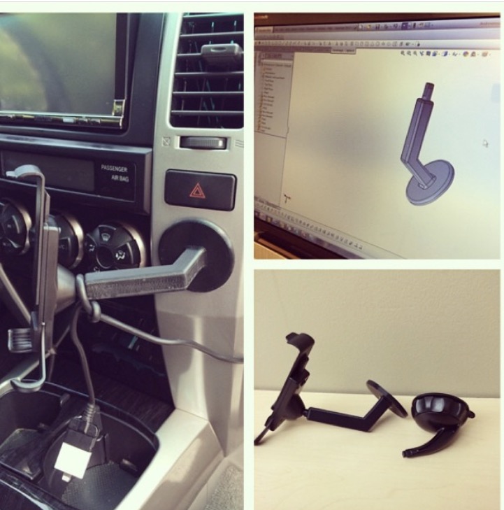

I used 3M double sided tape for a custom 3D printed phone mount in my 4th Gen 4Runner. Stuck on for years without any issues, and was a pain to peel it off when I sold the truck. You'll be ok if you cleaned the surface properly before sticking it down!

Yeah I cleaned both surfaces with denatured alcohol. The plastic seems like it'll bend before anything else.
Also to remove it the trick is to use dental floss to saw it off without damaging anything. Same technique works on go pro mounts.
I used a piece of fishing line and a heat gun and it came right off. But no way would it have pulled off! You should be set for many many years!
