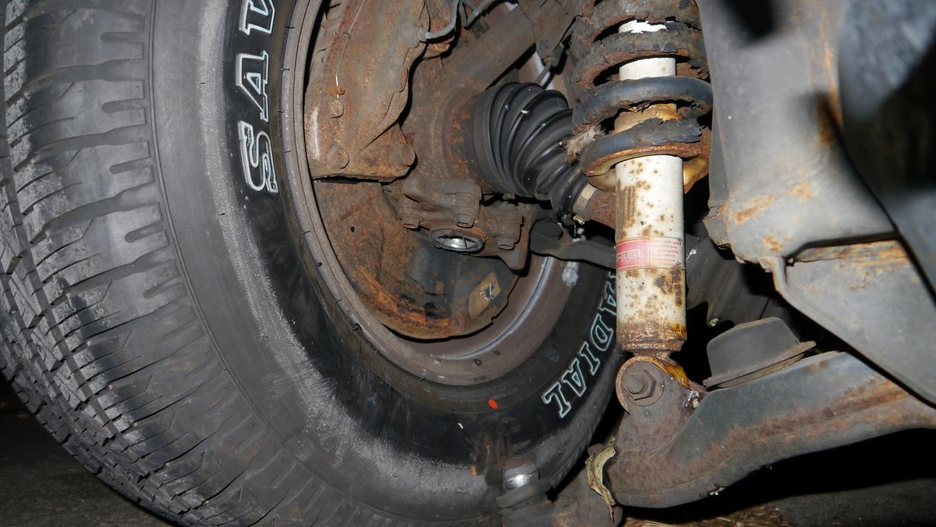

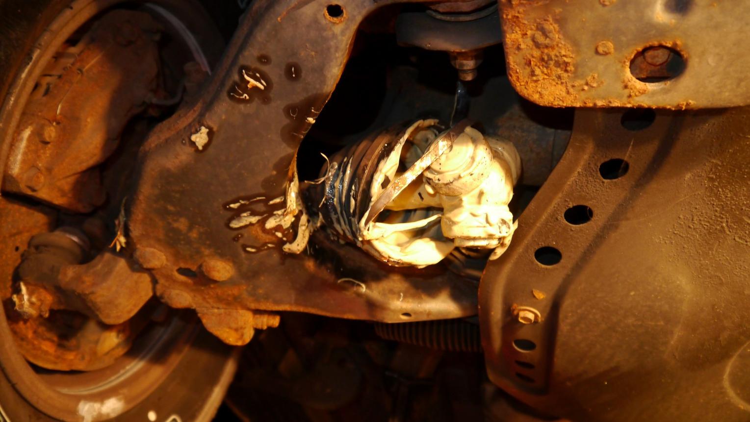

Well, add my pastor to the list. Failed while exiting off the highway driving his young son to pre-school. No one was hurt luckily.

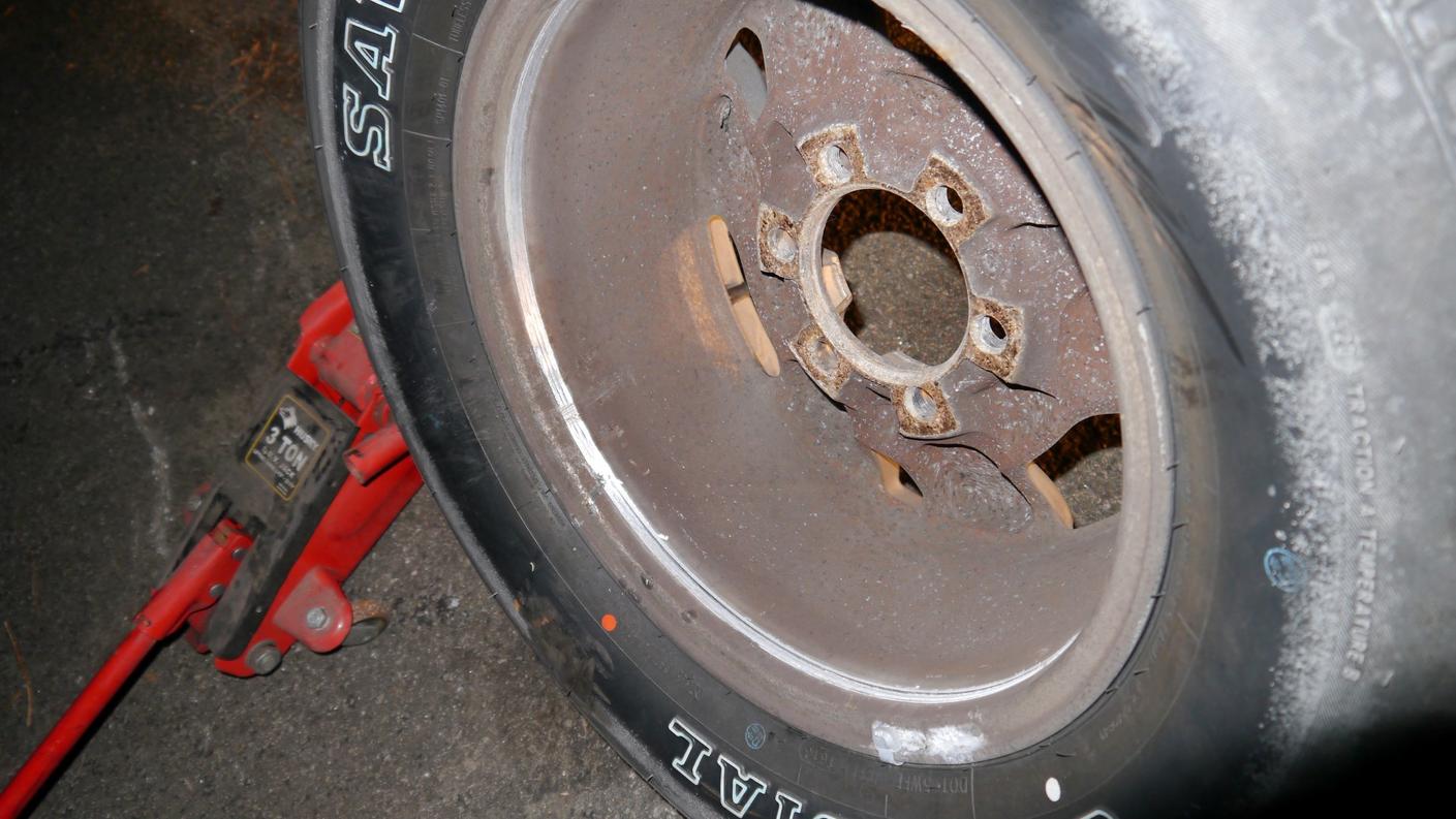

Not too much damage other than the LBJ and the CV. The wheel took some good scraping (see image). Any concern on the wheel as far as continuing to drive on it?
I am either going to replace the axle and LBJ so they can sell it, or my buddy and I are going to scrap it for them, in which case I will strip it as much as I can for replacement parts for my 4runner. It has 177k, is pretty rusty all over, and has a damaged tailgate from rear-ending a post. Scrapping is not really the best option, but they are wanting to get rid of it fast and neither my buddy nor I feel like selling it for them.

Glad to see everyone is alright! At least it is fixable. Definitely makes me want to replace mine ASAP

its hard to tell by the pic, but that wheel is probably fine.
