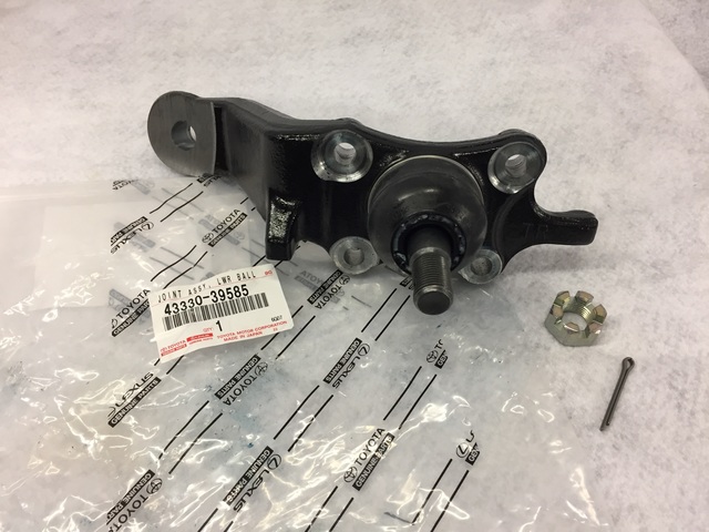

So I just did my LBJ's for good measure at around 128k. I used OEM as the gold standard.

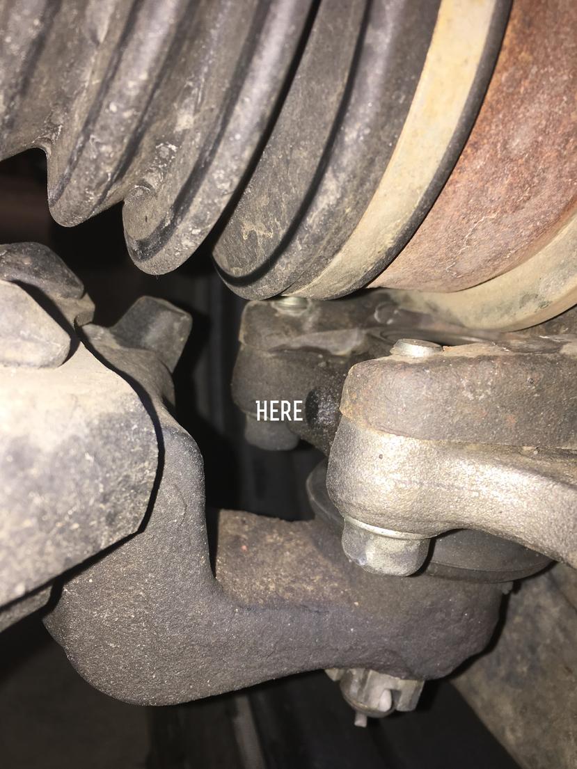

I did notice the OEM's have a bolt (see below, bolt to right of word "here").
I asked my mech about this and he said this is a point where you can install a grease zerk. Has anyone done that?

Those SPC ball joints that ToyTec sells are replacements for the SPC/Light Racing upper control arms- they won't work with stock UCA, and aren't for the lowers at all [emoji1360]
Interesting; I didn't notice a spot for a zerk on the OEM LBJ's I just put on. Maybe I overlooked them. That does sound familiar though; I think I've heard of guys putting zerks there.

On those in the pic...yep OEM for sure. I ordered them through my mech and were $122.87 each so they better be OEM. I see why you think that though, the light and flash made them look that way but to the eye they are painted black. They do look pretty dirty though for only 400 some miles...

Well I'm certainly going to double-check with my mech but again...based on the price and the fact that we talked a lot about that aspect, they should be (he agreed he always uses and buys OE on the ball joints and most other parts.) He's a pretty well know mech here in CO and works on a lot of the Rising Sun club guys' rigs.
But raw they were/are definitely black...not silver. Ugh, so much confusion on all this. I also find no 555 markings...
Well I'm certainly going to double-check with my mech now but again...for that price and the fact that we talked a lot about it they better be (he agreed he always uses and buys OE on the ball joints and most other parts.) He's a pretty well know mech here in CO and works on a lot of the Rising Sun club guys' rigs.
That ball joint does not look oem at all. But could be photo I guess.
OEM's are $88 each & do not come with zerks. Your mech bought "OEM" from his auto parts supplier & marked them up. Aftermarket LBJ's are only $40.
I think you got ganked!
Well I'm going to go discuss this with him. I'm shocked really because he's been really awesome, done a lot of quality work, saved me a lot of money, and again, he is really well known here in CO and works on a lot of other Rising Sun Club members vehicles (Runners and Cruisers.) So I just sent him an email to see what is going on and thank you all because it's certainly worth asking him about. I really do want OEM or nothing on there.
So what are these then? Maybe Napa type quality? I don't see the 555 marking. Hopefully not Moog? Anyone have a guess?
