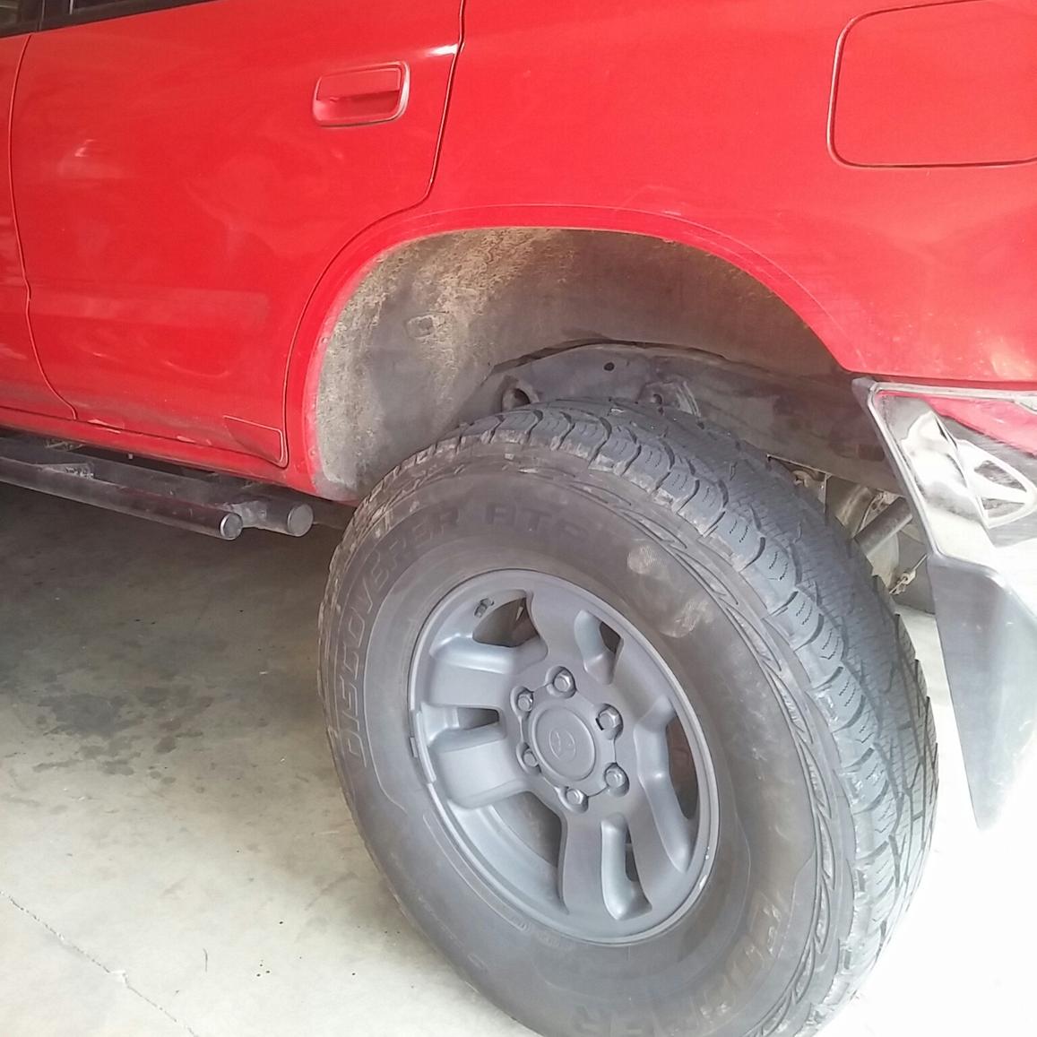

I recently picked up some LC 7.5 (19" double purp/light blue/white) and 8(19.25" double purp/dark blue/white) wraps.
I have 265/75/16 and was looking for some more recent pictures so that I know what to expect. Planning on picking up the Tundra 5100s. The only other thread with this is a few years old. Thanks in advance.

I had the same springs w/Tundra fronts (probably stated in that "old" thread too) on the third notch of the Bilsteins. The rear was too tall and looked like a stink bug. I got over 4" of lift using the 7.5/8 wrap FJ80 springs.
I dont really take much pictures probably the best I have. Ill soon be getting 285 75 16.
23" front tundra 5100 eibach coils. 24" in the rear same coil as yours. I also have a box in the back and a few gear so there is weight back there.
