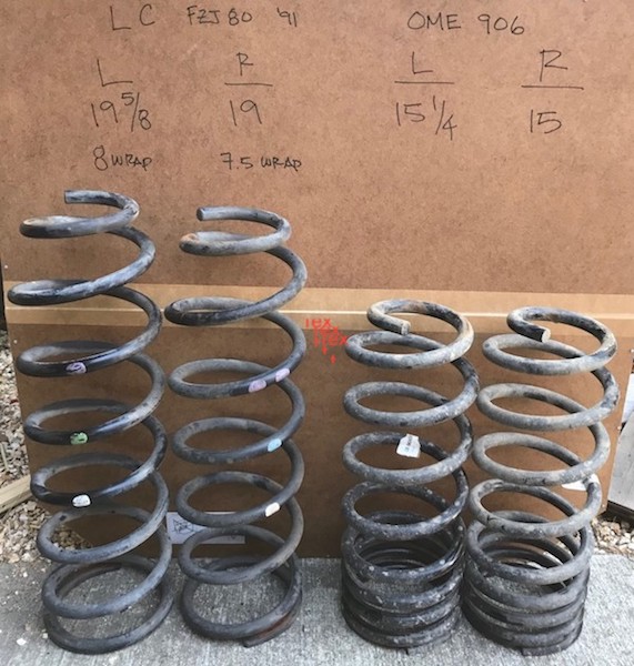

Here's a pic comparing the LC 7.5 (Double Purple light blue White)/8 (Purple Green White) wrap I just installed today with the OME 906 I had on.
The LC's were from a '91 FZJ80. The OME had about two years on them.
I got about 2.5" increase with the LC's on both sides.

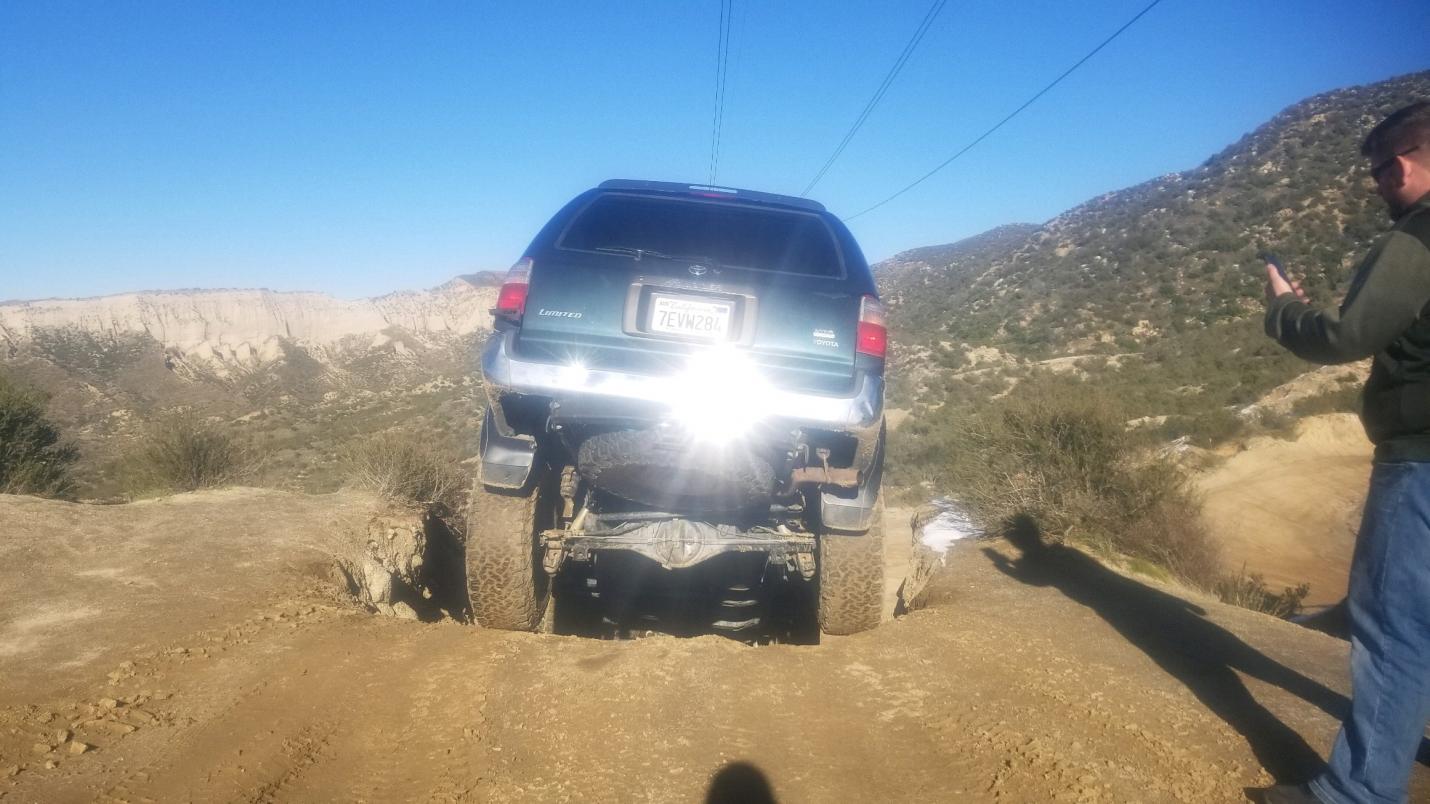

Im running the same setup 5100s with the same 7.5 lc coils you are. I had them for almost 2 years now. I do alot of hard wheeling amd they work good nice flex too
