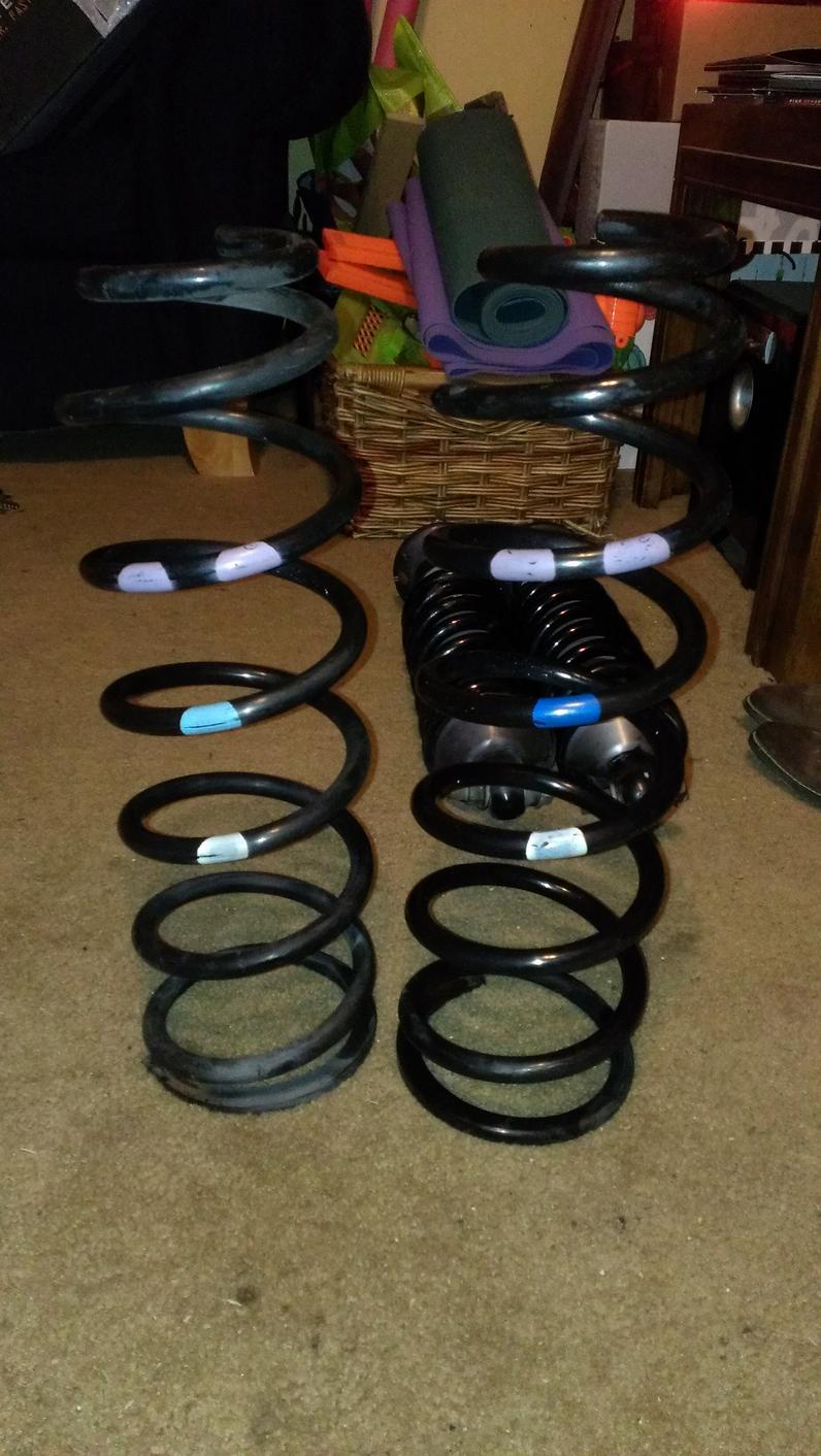

I picked up a set of LC Coils at the local pick-a-part and I plan on installing them this week. I ordered a adustable panhard bar and rear brake lines and will be using Donahoe coil overs in the front. I looked at the lift thread and I'm having trouble identifying my coils. From the lift thread I found this:
Height of spring/color code/wraps
21" Blue Pink White 9.25 wraps
21" Grey Orange White 9.25 wraps
20.25" Blue Yellow White 8.75 wraps-one of these is a confirmed LX450
19.5" Green Yellow White 8.25 wraps-one of these is a confirmed LX450
19.5" Purple Green White 8 wraps
19.25" Double Purple Dark Blue White 8 wraps
19" Double Pink Light Blue White 7.5 wraps
18.5" Double Pink Grey White 7.5 wraps
18 7/8" Orange Orange White 7.75 wraps
I believe I have 7.5 wraps as they measure 19 and 18.5". However I'm confused about the color codes. Will it sit level with the coil overs? Thanks
Sorry I might not help to ur questions but do you have a black 4runner and just order some some method wheels from Anthony?
you have one 7.75 wrap and one 8 wrap :surfer:
i do believe the light blue is the lesser
I think the bigger coil goes to the left of the vehicle to compensate for driver, battery, gas tank etc.... With the coilovers you will be able to adjust up to the LC coil height or to where ever you want them to be.
Correct. It looks like they are 8 wraps. Will probably give about 4" of lift (which is quite a bit).
