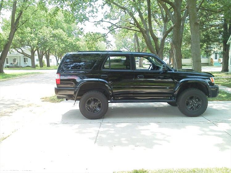

I actually think the stance of your 4runner looks pretty good & having the extra rake will help compensate those times when you have your truck loaded down with weight. As far as which coil goes on which side, usually the taller coil will go on the driver side. But if you were looking to lower the back end a little, have you looked into the ome 890's? What kind of shocks are you running with your coils? The 890s typically give ~3inch lift and give a nice ride.

Okay, that's a lot more economical. I went ahead and purchased the two coils from the junked LC since they weren't too expensive. I've been looking at OME coils. I found a pair of 890's for $170 shipped , so that may be my answer.
I don't usually haul much of anything in my 4runner, aside from my 100 lb. dog, so I'm not too concerned about weight over the rear axle. It is something to consider in the future if I decide to go with a heavy duty bumper setup. Good thing I have two sets of coils! I'm not sure what kind of shocks I'm running, but they look similar to the LC shocks I saw on the junked LC. I'll have to get under the truck and check for part numbers when it stops raining. Any suggestions for a good shock to run with the 890's?
