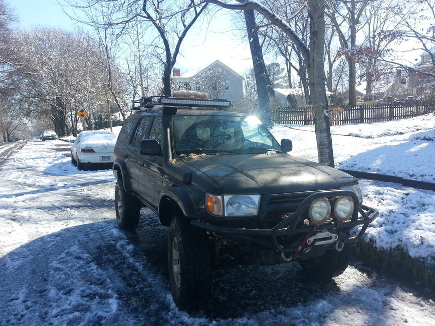

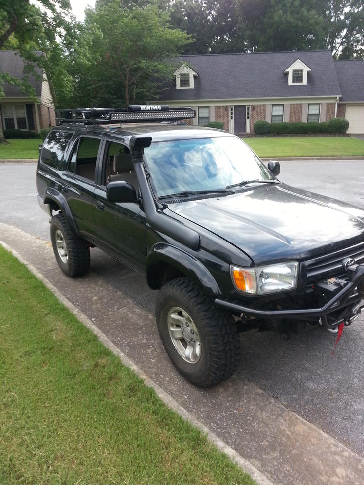

I attached two recent pictures of my 4runner. The lower front bolt (there are 5 total plus the 3 rivets on the windshield pillar) just need to be tightened up a good bit more, that is why there is a gap.
