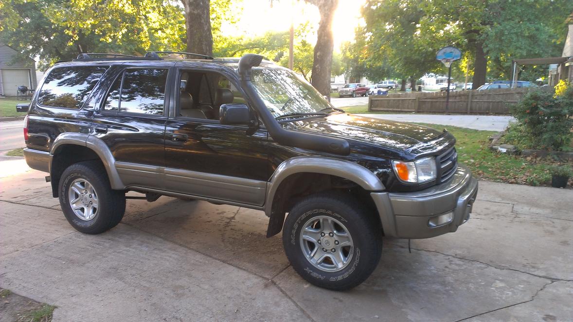

I attached two recent pictures of my 4runner. The lower front bolt (there are 5 total plus the 3 rivets on the windshield pillar) just need to be tightened up a good bit more, that is why there is a gap.
Thanks for the pictures. Did you just fab a template off of the snorkel itself? That's what I'm leaning toward as it seems there's no instructions provided.
yea the no "destructions” with it make be just a little hesitant, more so the lack of a template part I guess.
i also have the hilux snorkel available on ebay. mine came within a week from the seller in Malaysia. the fitment is pretty decent, but a lot of measuring was involved since the provided template was useless as it was made for a Hilux front end. if you are a perfectionist and want it to fit 100% snug, this snorkel is not for you.

- Thanks for more pictures.

the template with mine was pretty close to being dead on, Ill see if i can find it in the garage. I think i just lined it up with the fender/door edge, and the antenna and went to drilling away. and it turned out alright.:dizzy:
ebay Hilux snorkel here. plumbing it was a pita .I use some pvc fittings to the rubber coupler
