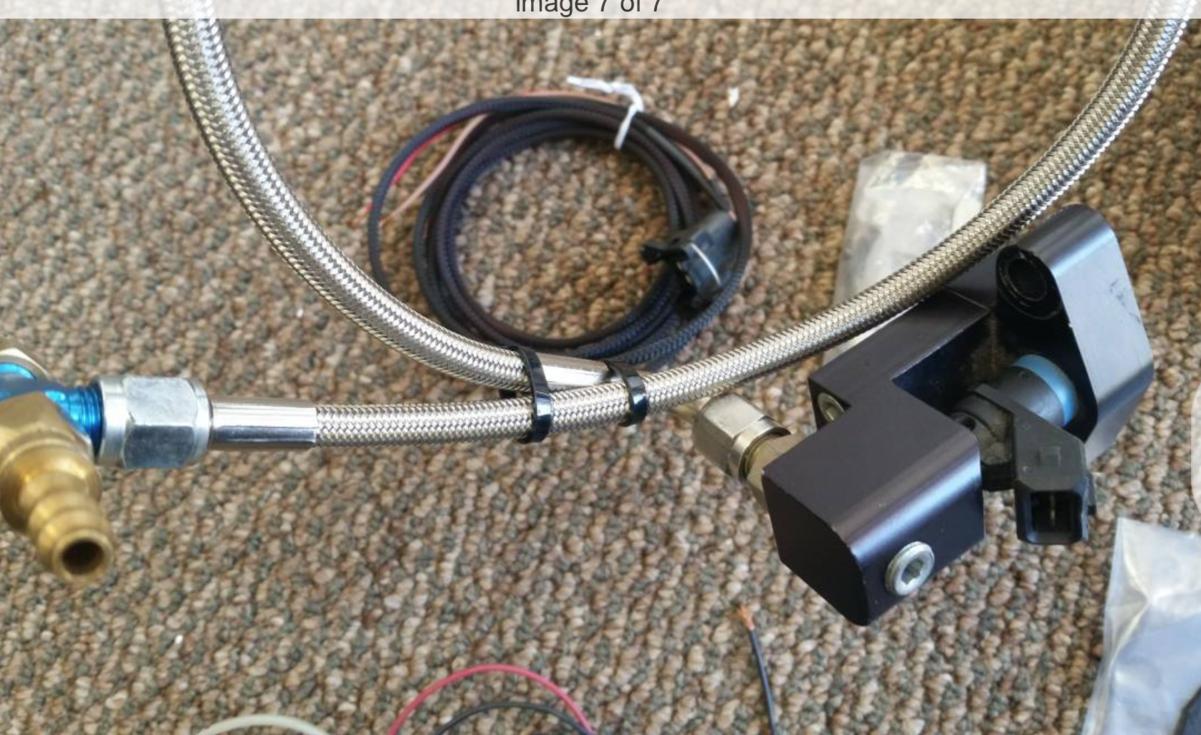

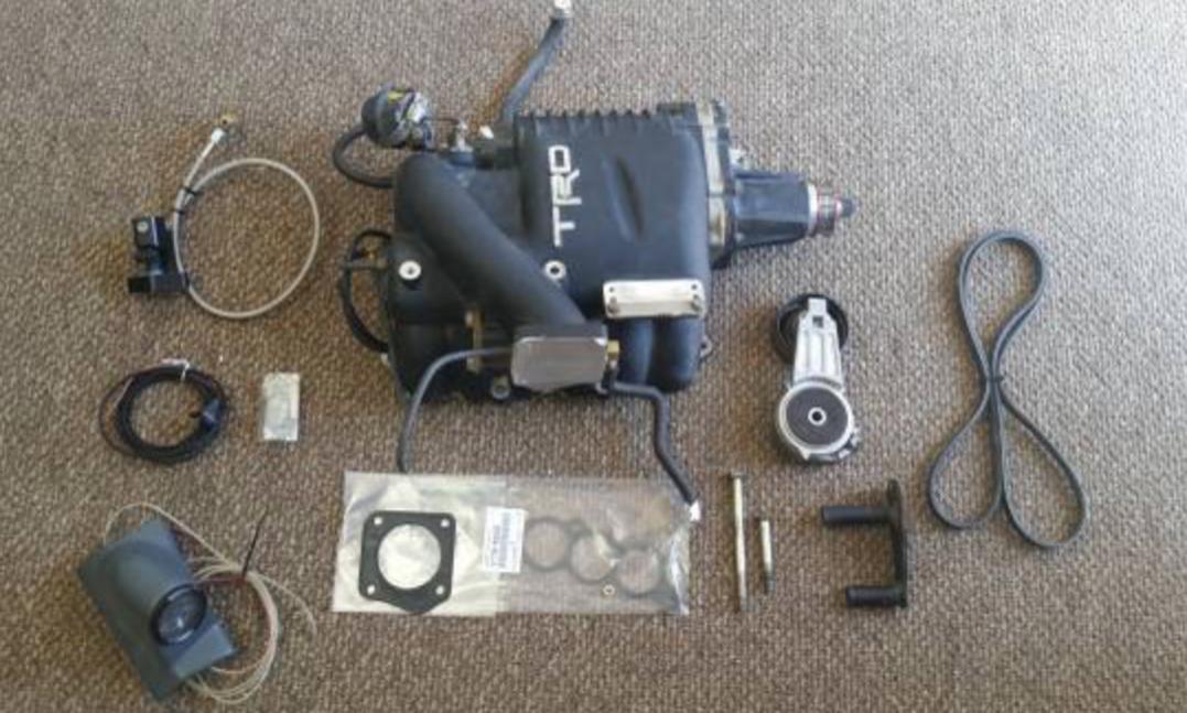

Check to see how many miles are on the charger itself and if it has ever been rebuilt because that will be another $500 if it needs that. And I would also factor in a few extra $100 to get the injector controller from URD. For perspective a brand new unit from lce engineering with all the URD goodies will be around $3900

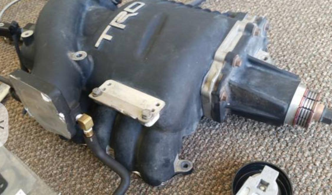

The Owner says the pully has no slop in it and is "tight as hell". I don't know if this is a good thing. He did say it was recently rebuilt but he has now idea of the total miles on it as it was installed by a PO.

Pretty decent price for a black top in my opinion. You're missing more than just the control module box from URD it looks like.
If you're mechanically inclined - get it.
Read the threads and do some research to know what you're getting yourself into. The supercharger REALLY makes 3rd gen 4Runner go. Smaller pulley + injector and tune.... it's a whole different animal. :ak472:
You don't want ANY play in the pulley or shaft. It's supposed to be firm as a rock, yet able to spin freely.
Rebuilds last for 100k miles or so... just change the oil until you HEAR it needing attention.

The controller will cost a little trying to obtain it outside of the kit, but not terrible. I'm currently piecing back together a $700 methanol injection kit but it did have the controller. I'm about $200 in missing parts but worth it in the end since it's not like these sort of things break, since I only paid $200 for the other parts.
If your goal is to get a supercharger with extra mods to increase fuel/boost, that's a good deal. If you're just trying to get a stock charger, then just buy it new.
