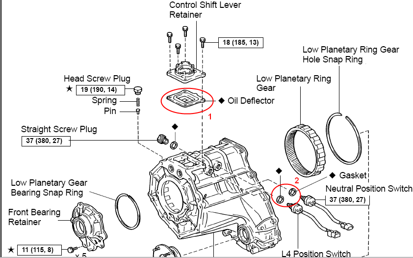

Any pictures or instructions on this procedure? I found the exact same problem changing transfer case oil yesterday.
attached pic
Are you guys replacing 1 or 2 in the attachment picture?

#1. Which, they are saying actually 3 pieces (not sure if they all come together when you buy from toyota)...gasket/metal/gasket. Nice blow-up!

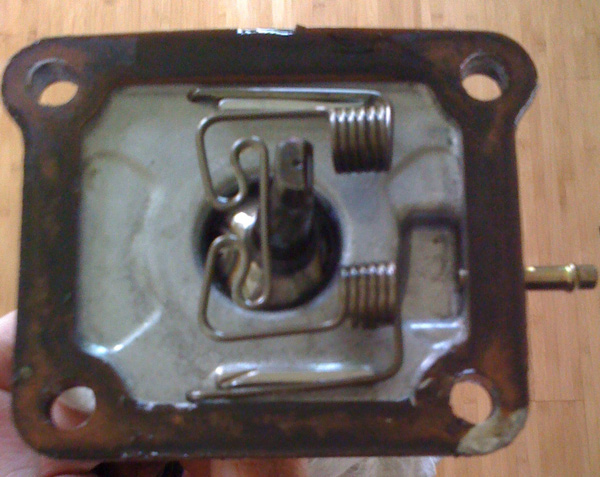

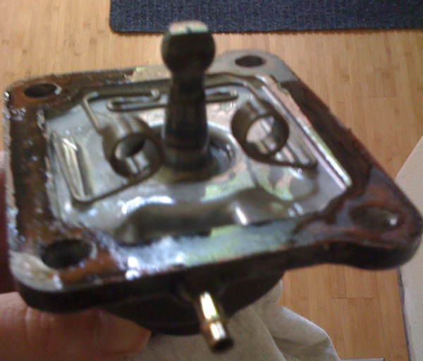

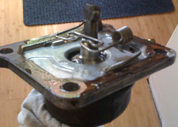

Pics of the t-case shifter assembly / base from my '99 limited. It does look like the seal has been leaking, and crumbling apart in places. Also, in the first image, you can see the dent that the spring left behind when this assembly was installed who knows how long ago.
Now, the question is. If the new gasket is leaking, do I even use it, or just go with straight RTV?
:artist:

Took it back out today, since replacing the gasket did nothing to stop the leak. What I found was, I do indeed have that metal spacer and another paper gasket below it (identical to the top one). So, on my 99, it goes shifter base - paper gasket - metal spacer - paper gasket - transfer case.
Needless to say, I kicked myself for not realizing that metal was a shim (which also holds down the shift lever spring), and for thinking that was the top of the t-case. I took the shim and the bottom gasket out and cleaned everything up with steel wool. Then I de-greased all the mating surfaces and put my new paper gasket on the t-case surface. Then I RTV'd (the orange stuff) the shim to the shifter base.
If this fails, I'll take it out a third (or is that a fourth?) time and RTV both surfaces (nixing both paper gaskets...which seem worthless anyway).
All this, and I'm STILL not certain this will fix it. Joy of joys. Luckily, I'm getting really good at taking this thing apart.
