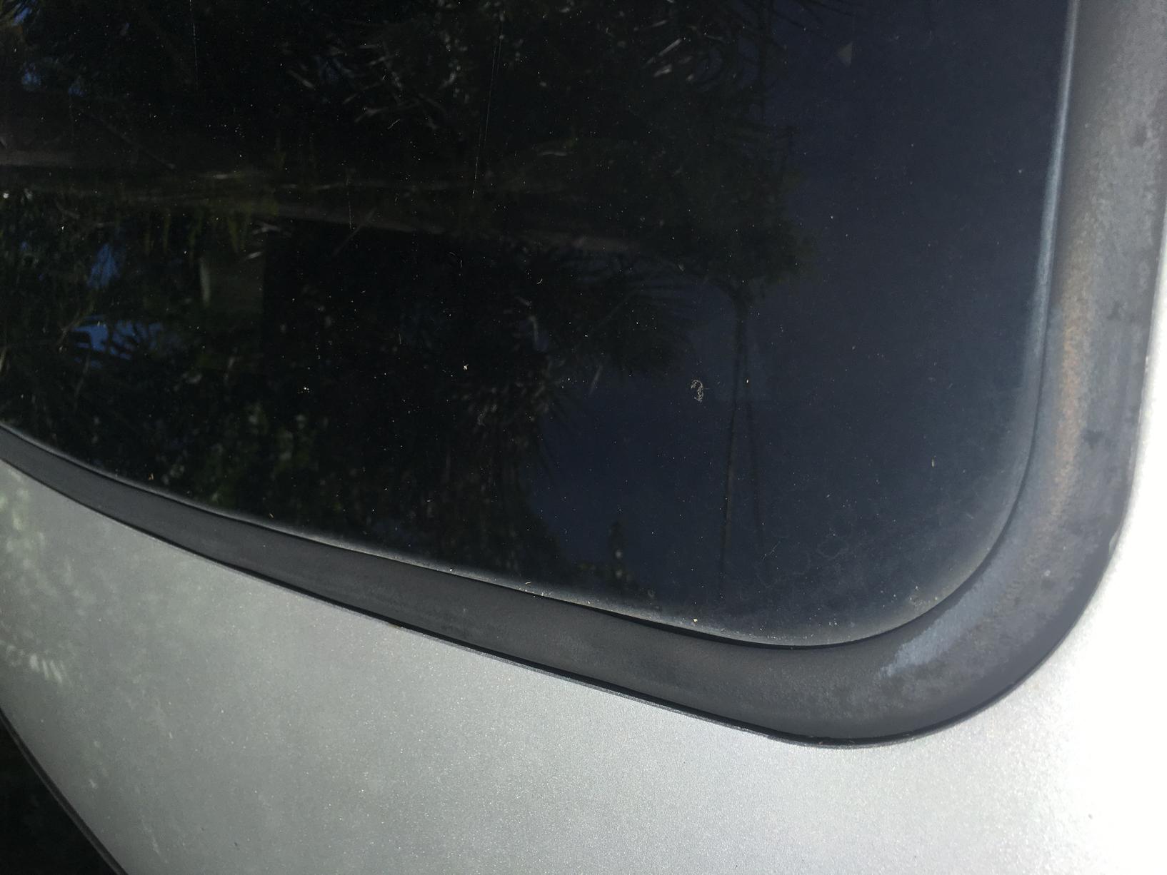

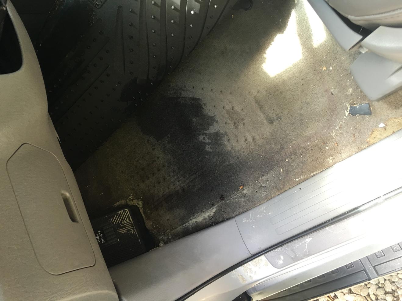

Hey guys I know leaks have been covered multiple times... Just trying to confirm my issue. My wife's 03 4Runner leaks whenever it rains..both the driver and passenger side get pooled water in the footwells..also it seems it's leaking out of the sunglasses holder? Because if you make a turn after driving the water falls on your head.
The sunroof frame is rusty and I'm not sure it ever securely closes.
Here's my question, should I bring it to a body shop to have them fix this? I'm admittedly not great at doing mechanical work. MY 04 T4R had its sunroof sealed and disabled before i purchased it, I'm assuming due to leaking too. Just trying to figure out my wife's issue. I can't afford a new sunroof frame/labor right now.

Definitely looks like the sunroof is leaking excessively. The seals around the glass seem to shrink over time which allows a lot of water in even if the sunroof closes all the way. The other part of this is sometimes the drain tubes become clogged and/or disconnected which allows the water to drain inside. I would pop off the A-pillar trim and drop the headliner a bit to see if the tubes are even connected. Open the sunroof and inspect the drain channel where the tubes connect, for cracks and/or debris. If all that checks out, your best bet may be to seal the sunroof shut permanently.

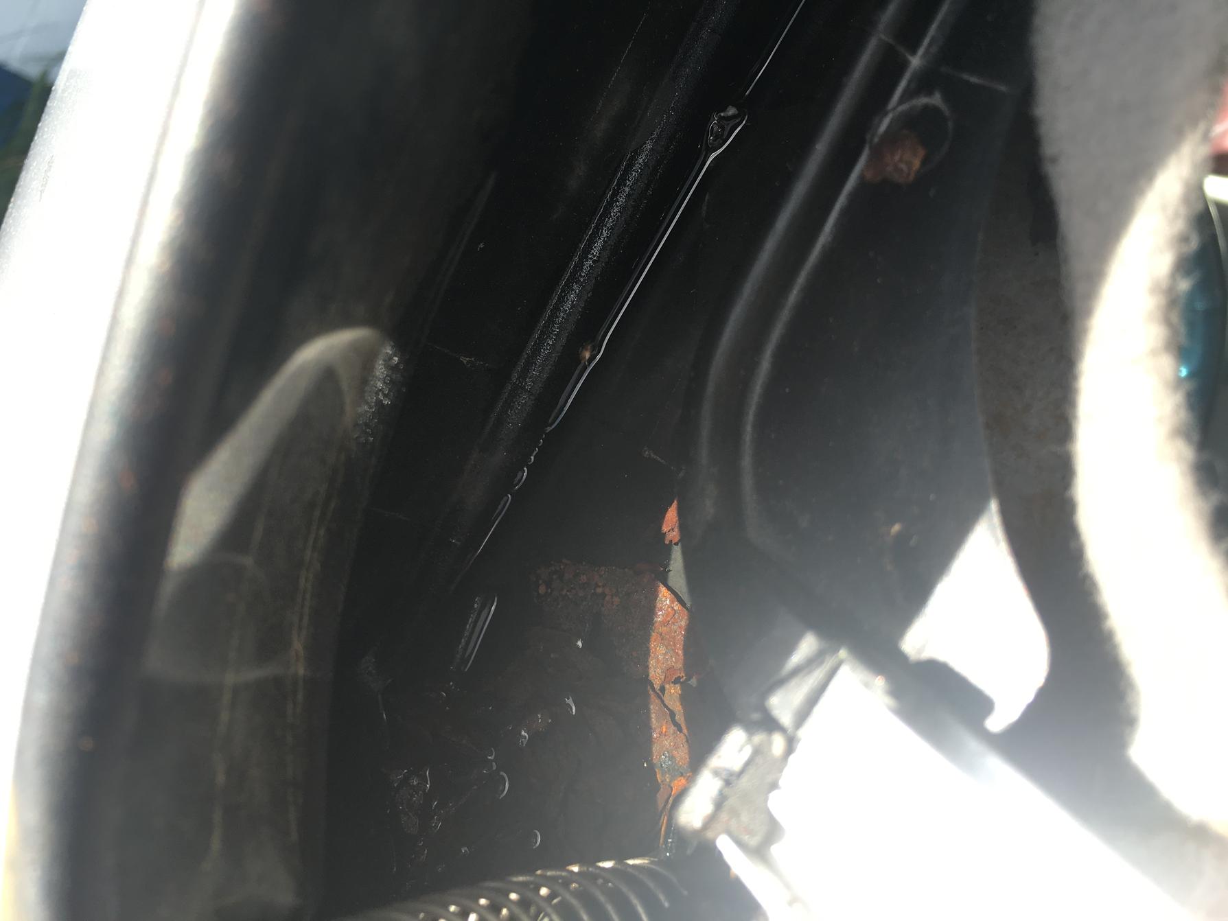

id just run a cloths hanger down the drain tubes and see if you can clear them. looks like they are clogged. not all sunroof seal water tight, hence why the drains are there. it think it would also be worth your time to clear the drains to allow you to do the sunroof tsb to allow it to continue to work correctly, its very simple and straight forward.
Step 1: clean all that crap out of the sunroof tray.
I had this same problem when I first purchased my T4R. If you close the sunroof and pour water around the sunroof seal you'll be able to see where the water is leaking into the truck.
As others have mentioned clear the sunroof drains of any debris. The drains are located at all four corners of the sunroof tray, however, the front two are the only ones that are easily accessible. If you open the sunroof and stick your head out the hole (looking towards the front) you'll see two small holes in the left and right corners of the tray.
Heres how I fixed mine: Run something rigid (i used some old speaker wire) down the holes to try and clear the tubes. Don't use anything sharp as you don't want to puncture the tubes. You'll also want to clear the drains in the rocker panels. The rocker panel drains are about 6 inches behind the front wheels. I took a garden hose and sprayed the crap outta the rocker drains to clear them out. Just keep repeating this process until the drains are cleared (to check if it was cleared I poured water in the sunroof tray to see if it was draining out the rockers).
My tubes were full of pine needles and dirt from the 4Runner being parked under trees its whole life by the previous owner. If yours are full of rusty metal bits you may be SOL.
With regards to the carpet it may be salvageable, I pulled up the carpet on the drivers side (only side that was getting wet in my rig) and used a blow dryer and a box fan to dry everything out. If its moldy you may have to replace the carpet.
Sorry you have to deal with this, its a major pain in the ass and water leaks just plain suck! I was ready to permanently seal mine until i did the above process and while it still leaks a little bit everything drains down the tubes and my floors have been dry ever since.
