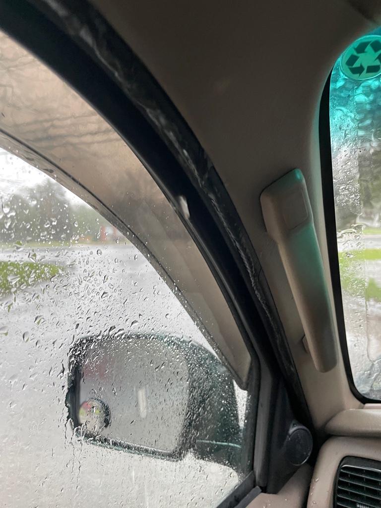

Anyone tell me what’s happening here water pouring in when raining and I back up ? The molding looks good no cracks, really strange. Thanks

Wouldn’t the head liner be soaked if it was the sunroof? Are you sure it’s not coming in around the door moulding? The top most rubber is a drain channel, maybe it’s full of dirt and causing a backup there?

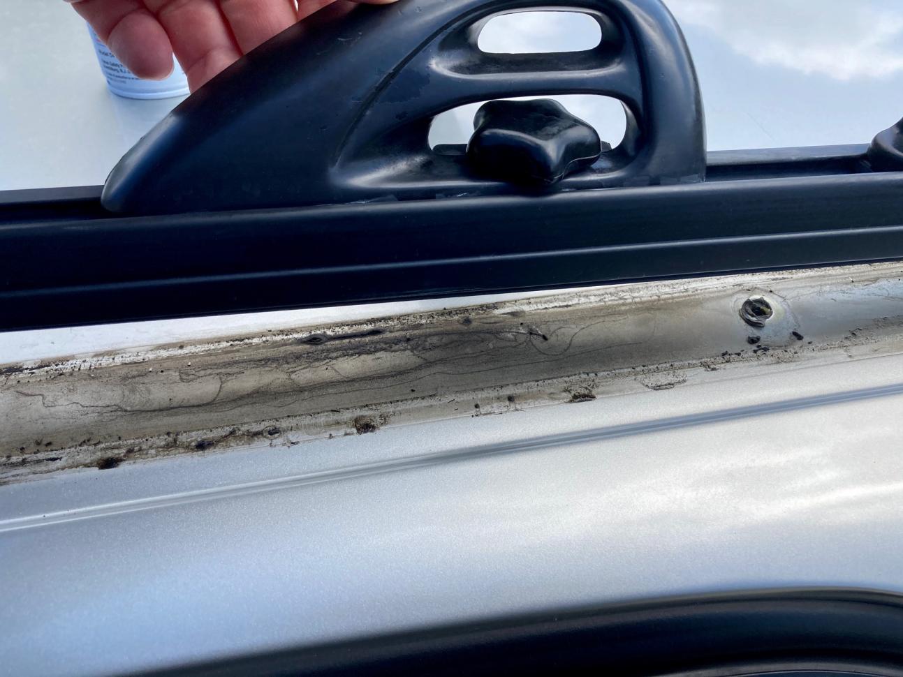

Unscrewed the roof rack (5 torx bolts on each side) and pulled it off to reveal the nastiest bit of paint I've seen in quite a while. Got it cleaned up and ceramic coated (also cleaned and silicone sprayed the bottom of the roof rack rails) before applying a dab of silicone goop into each exposed hole and reattaching the roof rack. Picture of the grossness:
