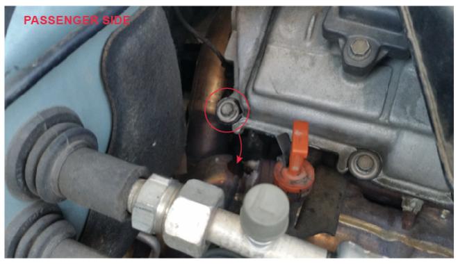

First of all, I am NOT a mechanic - that's why I'm posting this.
A couple days ago I noticed smoke coming from the passenger side of the hood after a 20-25 minute interstate commute. I stopped, took a look and saw something dripping from corner of the engine near the transmission fluid check. The smoke I saw was steam from the fluid hitting the hot (exhaust?) pipe and creeping out from under the hood. Take a look at the photo. I immediately checked the oil, transmission and coolant/radiator fluid, in that order. The coolant tank was almost bone-dry, but the engine never got hot and I hadn't noticed a leak anywhere on the ground prior to this (and owning a 15-year-old car I am sure to keep any eye out). The exhaust didn't look weird or smell funny, no weird sounds either. I refilled the coolant tank and let it sit for a day.
This morning I checked the coolant and noticed it's lost 1/4 tank since I refilled it. It's also more brown in color towards the bottom. I cranked the car and just watched it run for 5 or 10 minutes. I couldn't see a leak anywhere and was afraid to keep it running, so I turned it off and here I am.
Main question: What is my mechanic going to say on Monday? Is there any chance I have a blown head gasket? What can I do to spot a coolant leak? I love this car and can't wait another 48 hours to find out what's in store for us. Please help! :wow:

From the picture, it looks like a cracked valve cover. Or it may be bad valve cover gasket.

Doesn't engine oil leaks from a cracked valve cover? Mine cracked in that exact same spot.
If your coolant leak is in that spot then I would be inclined to believe that it is leaking from the heating hoses above the passenger's side valve cover. There are several coolant hoses in that area. The OP stated that steam was coming from the passenger side of the hood...and those hoses would leak right onto the exhaust manifold.

I'd have to agree with this. It must be a leaking heater hose dripping from above.

But, the OP is dealing with a coolant leak and not an oil leak.
If you have a bad valve cover gasket, you leak oil, not coolant. Now, I know there are coolant channels in the head, but they don't come all the way to surface where the valve cover gasket seats. Knowing how common leaking valve cover gaskets are on this engine, we'd all be experiencing coolant leaks as well as oil leaks and that's just not the case. Unless the OP's head is cracked somehow exposing a coolant channel, I'd have to agree with [MENTION=102336]aontkos[/MENTION] that it's probably a leaking heater hose from above.
OP, look at the hoses against the fire wall on that passenger side. You're probably going to find a leak somewhere there. Since you're losing coolant pretty fast, the leak is probably fairly substantial and you'll be able to find it. It also can be deceiving where the leak is actually coming from because the fluid will drip down along other hoses. If you see wetness or a drip, look up above to confirm where it originates from. You may have to wipe it all down first and then recheck unless the leak is totally obvious from a cracked hose or connection.

I appreciate the help! It hasn't been driven since I noticed what was going on, so I'll have it towed and hope for the best. I cranked it and left it in park to see if I could spot the leak. When I first noticed it after driving home, I definitely saw something dripping onto the exhaust manifold, just couldn't spot the source immediately. That's when I checked fluids.
