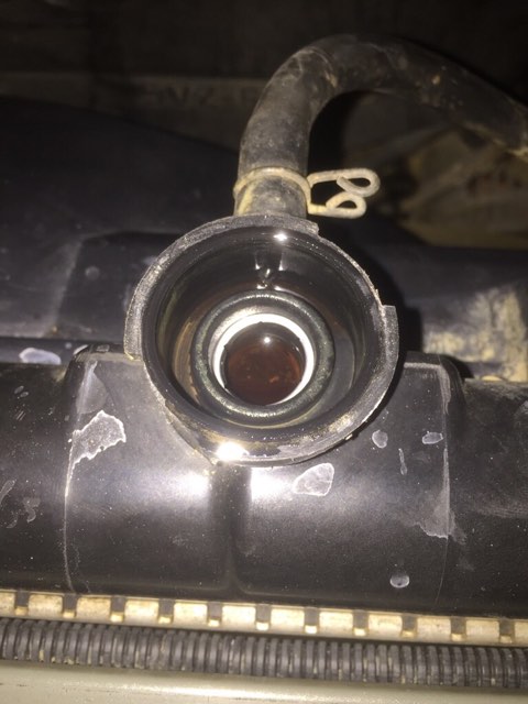

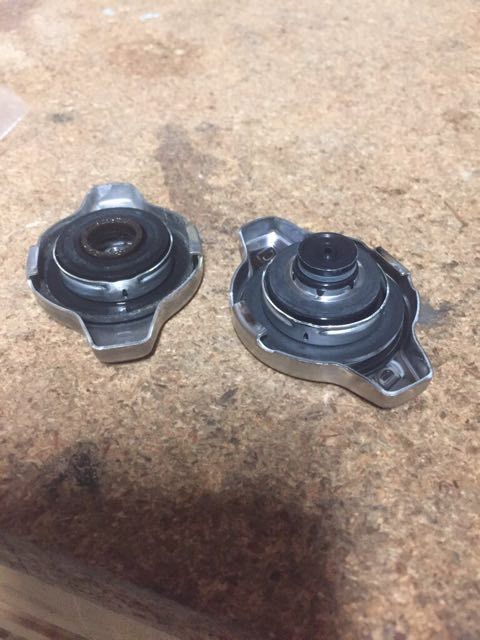

Compare the old cap with the new one. The OEM caps are known to fall apart and the small center plastic cap and spring end up somewhere in the top of the radiator. If your old one was missing parts, it wasn't holding pressure like it should.
As a matter of fact I took off the old one to inspect it and saw a piece stuck in the top of the radiator. Here's a couple pics

If that's the case then you may not have caused overheating damage. If the cap can't maintain pressure then this will lower the boiling point of the coolant and make it boil but the temperature shouldn't be all that different than if it was pressurised and still liquid. Unless all that boiling coolant prevented proper coolant flow through the engine block.
I've been driving it around for about 2 hours in stop a go traffic and the problem seems to be resolved! Pretty sure that If i took this to a mechanic they would have said I had a blown head gasket. That's why I love this forum! Thanks guys. I'll let you guys know if the problem comes back. All is well so far
Glad to know it was an easy fix. Radiator cap really should be preventative maintenance. I keep a new spare Toyota one in the truck too. But I'm a little anal about maintenance and running correctly I suppose...
