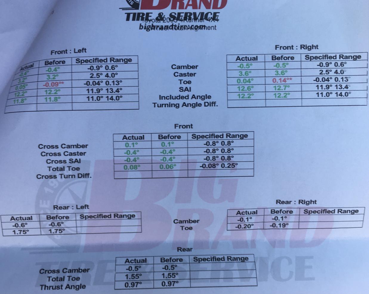

I am having issues with my 4th gen. THe rear right tire is wearing excessively fast. SO I had it aligned and got new tires. Still having the same issue. The previous owner did mention they were rear ended but sounded like it was all cosmetic repairs. The shocks leak a little as well. Its the outside of the tire that’s wearing fast. When it was Aligned they said it wasn’t far off when I brought it in. I think it has to do with the previous accident. I also have a RTT on top.

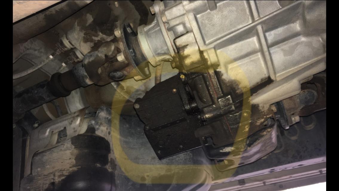

Now, I’m noticing oil puddles everywhere I park. Its coming from behind the transmission. The oil, looks clear/ slight brown, smells like oil/lube. I included a picture. I think its the gear box? I’m planning to take it in, but since i usually try to repair stuff myself, I wanted to have a clear understanding of what to expect when I take it in. Im currently traveling and have no where to work on it. What would you expect to spend on something like this?

Unfortunately I'm not familiar with the transfer case leak shown, so I cannot comment.
That would make sense, that the obvious thing that is worn out is causing it. I did inquire about this to the alignment shop, they made it seem like it would be the axel if anything..

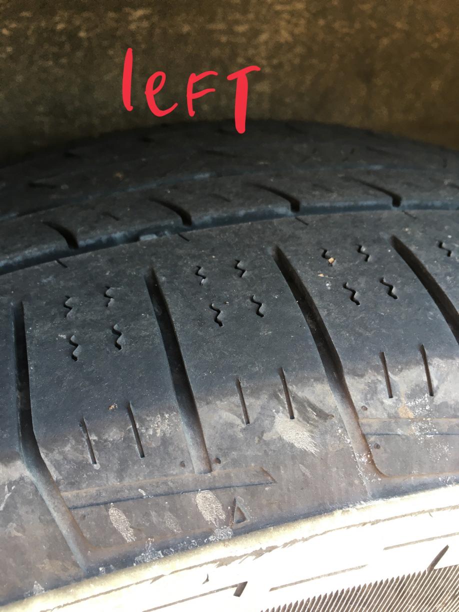

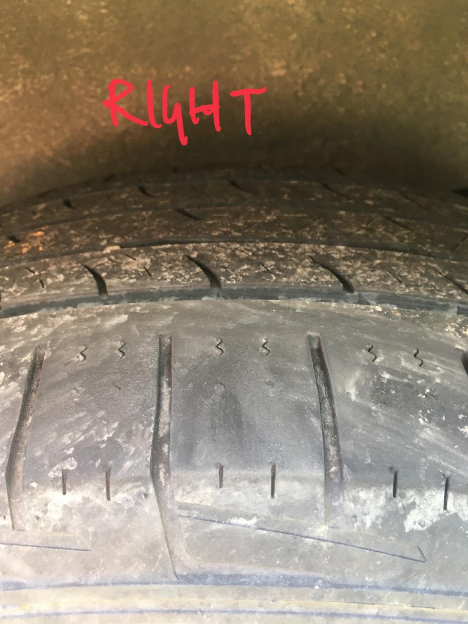

If the tire is cupped or scalloped would bring better closure to the issue. "Worn" is too general to provide any specific speculation. A picture is worth a thousand words
The transfer case is a somewhat common issue. I bought the stuff to do mine, but haven't built up the courage to do so.
Fixing the transfer case shift motor leak from within..
It's likely a $5 o ring. But it requires dropping the TC, cracking it open, replacing the seal, redoing the gasket, and putting back.
$5 o ring that’s gonna cost me $500 to fix? Its leaking a lot unfortunately. On my 3rd gen, I was poor and never touched anything, it always leaked a small amount of tranny fluid but it was easy to check and maintain. This is a lot more involved.
Its outside wear. I’d say about a 3rd of the tire is rounding off. I guess I didn’t get a picture of the previous tire. Here is where I’m at now.

Assuming that tire wear spans the entire circumference of the tread, I'd imagine the gold-plated next step is to visit a reputable body shop that has a frame rack and measure all the reference points accurately to make sure everything is within spec.

I'm not overly familiar with the alignment process your truck would have had to get those numbers... and if it would have picked up a bent axle in that process. You could call big brand tire and ask them if the alignment machine would see that the rear axle is not within specification.

Accoriing to the mechanic the place I had it aligned at should of noticed these issues and not even done an alignment without doing the power steering rack done first.
It was also had “good” alignment before I took it in.

DIY: Transfer Case Actuator Repair
Transfer case leak - Page 12 - ClubLexus - Lexus Forum Discussion
The above to link might help with your transfer case.
Link #1 deals with a common 4th gen issue. If the 4x4 is not engaged frequently it locks up and just won't work. To fix this you have to open the actuator cover- little plastic box at the back of the transfer case. If the previous owner opened this up to get the 4x4 working again he may not have sealed the box correctly and it will leak. I had this issue as the rubber O ring on the lid didn't want to seat correctly. Took a few times taking it off before I got it positioned correctly. If you do this be prepared for gear oil to spill out, maybe 1/4-1/2 cup, also one of the gears may or may not want to slide out. Hard to tell from your pic but typically when gear oil leaks of course it sprays backward and not so much forward/onto the back of your transfer case, so the actuator cover may not be it. When mine leaked it did not get on the transfer case but only showed on the actuator box itself.
If that's the case if may be leaking from the actuator arm seal. See link #3 - it's from a Lexus forum but I believe the parts are all the same.
I would clean it all up with contact cleaner and get a better idea of locating the source of the leak.
